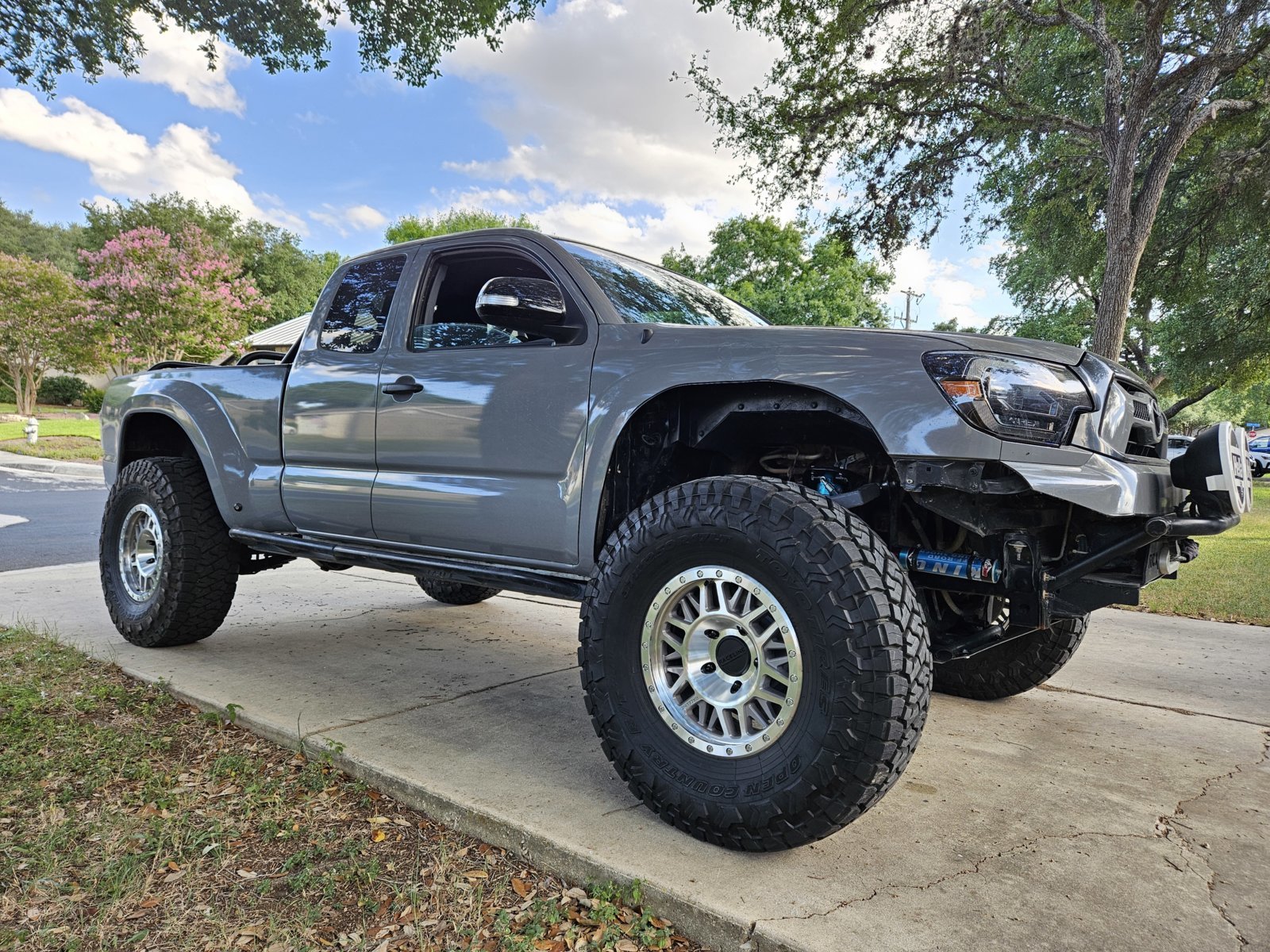

    Adventure4x4
    Adventure4x4 Well-Known Member
    Feb 12, 2016
    #177931
    1,394
    Adam
    San Antonio, TX
    2013 TRD off road MT
    Tacoma 5 lug 4x4? 2nd gen Tundra components at all 4 corners.

    Nice work, very cool innovation! How much travel are you cycling with the Frankenstein setup?

    I'm at 13" due to the 37s. Definitely more to be gained if I cut more and mounted the coilover up higher.

    Nice! I saw in your build you don't have the diff in yet, what are you using to keep the hubs together?

    Unfortunately, I decided to hold off on the front diff. The fitup was tight with contact at the crossmember as well as the steering rack. A project I didn't want to take on at the moment. All factory tundra outer components with a custom set of RCVs mated to the 8" diff, so it just uses the tundra cv axle nut to hold everything together.
