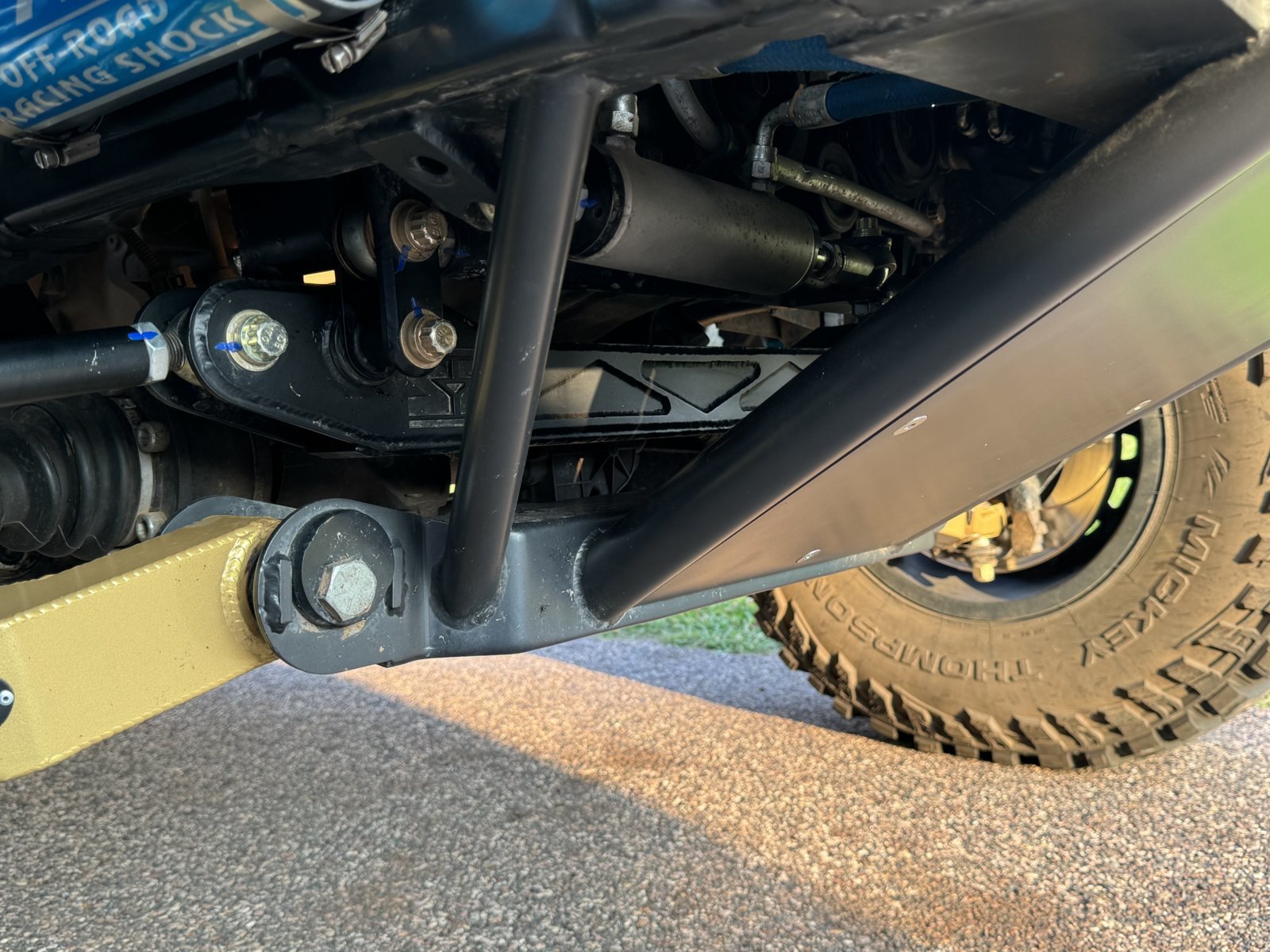

    This and the lower control arm mount kit is paramount. Do these two mods first. Then spindle gusset with double shear steering tabs and upper control arm double shear kit. The way JDFab has created a solid foundation platform (the lca mounts) that can be built upon is a key element to why choose to use them.

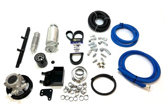

    I ran the jd Howe pump on mine, and yeah it's definitely better, but for the price, I gotta say I wouldn't be putting it first on my list... I know that's against the grain in this thread.

    IMO lots of guys did the pump at the same time as the slide rack and attribute lots of the feedback going away as the pump. But, I agree. It isn’t an “omg” mod by any means.
    Reality is, most feedback is coming from clapped out racks. While the pump can help it’s not the biggest change. The amount of flex in the TWO mounting locations for the factory rack is the main issue. And when things clap out it gets even worse.

    I also think most guys who did it, myself included, already had long travel, 35+ tires, etc etc. and were looking for the next thing, and at that point, the pump is sweet, but definitely not before imo
