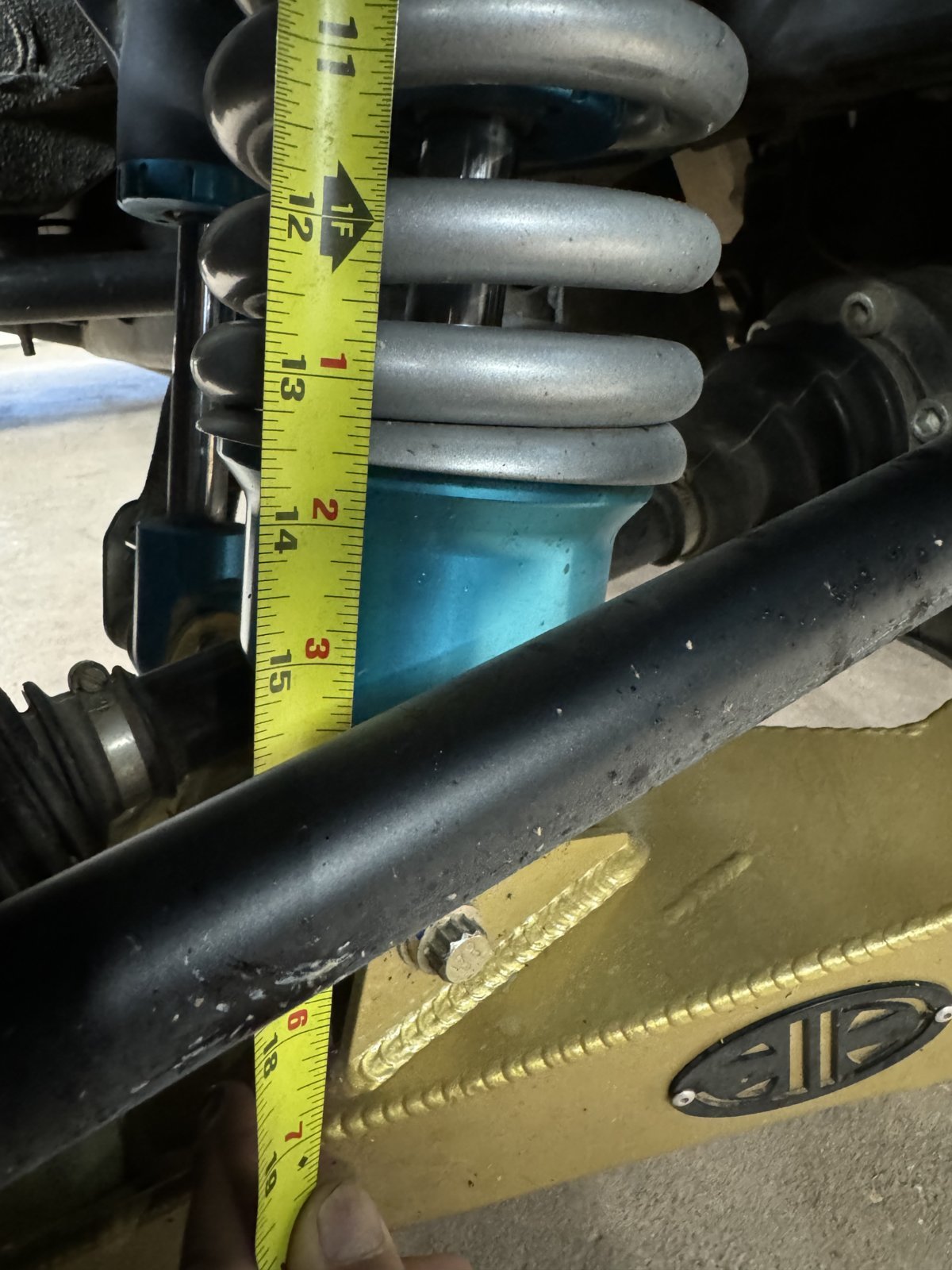

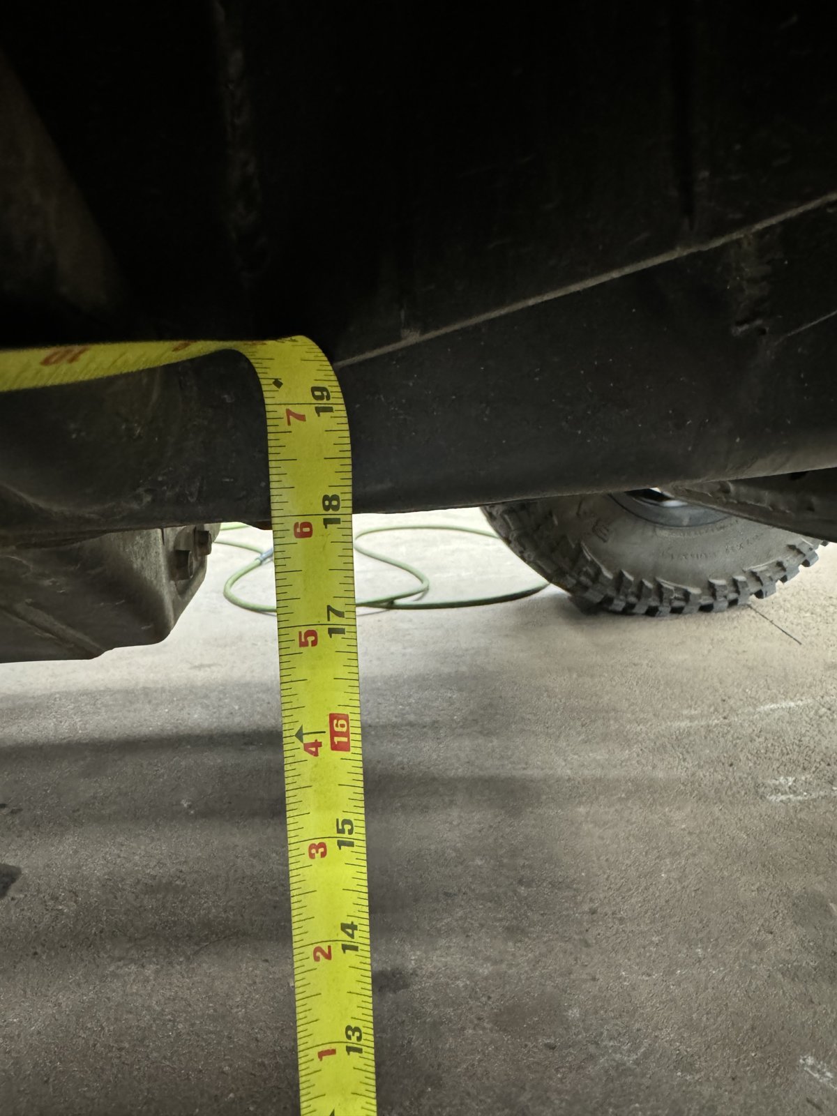

    I’m sitting right on the 50/50 mark for travel with 18x500. I’m also right on the line of coil bind at full compression. Want to say my frame height at body mount location is about 18”. Can confirm when I get to the shop.
  17. Jul 15, 2024 at 5:59 AM
    906taco
    906taco Well-Known Member
    Jun 22, 2021
    #369289
    3,906
    Cory
    08 Taco
    @Blueberry.Taco heres how mine is sitting. Bypass shows 4.5” of shaft at this height.
