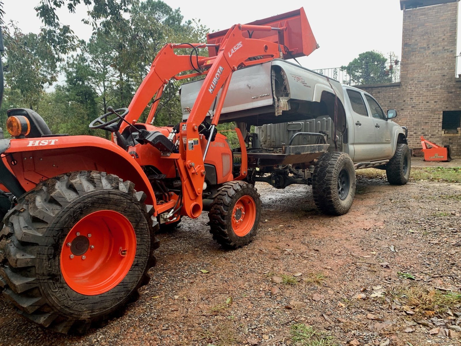

    I like it! I’ve enjoyed using my tractor to save my back these days. Best upgrade was getting pallet fork attachments for the bucket though. I use them a crapload.
