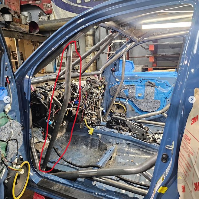

  12. Jul 20, 2024 at 2:38 PM
    TWTaco
    TWTaco Well-Known Member
    Dec 19, 2015
    #172601
    5,979
    Dave
    Could this tube be eliminated and still keep the cage integrity? I don't have any clue on cage fabrication. I wouldn't be doing the install myself.

  13. Jul 20, 2024 at 2:58 PM
    906taco
    906taco Well-Known Member
    Jun 22, 2021
    #369289
    3,971
    Cory
    08 Taco
    Absolutely. That’s a secondary a-pillar and not needed unless you plan on a tumble at 100mph.

  14. Jul 20, 2024 at 3:05 PM
    TWTaco
    Dec 19, 2015
    #172601
    5,979
    Dave
    Thanks. I just think it would be a comfort issue as a daily driver. No plans for 100mph tumbles! :fingerscrossed::rofl:

  17. Jul 20, 2024 at 4:51 PM
    Airdog
    Airdog did your Mom
    Dec 26, 2012
    #93790
    4,905
    Tom
    SoCal
    https://www.tacomaworld.com/threads/airdogs-2012-prerunner-access-cab-slow-build.264263/
    Mine came with that tube also and I did not put it in. The only other tubes I didnt put in were the 45* ones at the bottom of the access cab part circled in red. Wanted to make sure I had some kind of easy access to the extra cab part.
