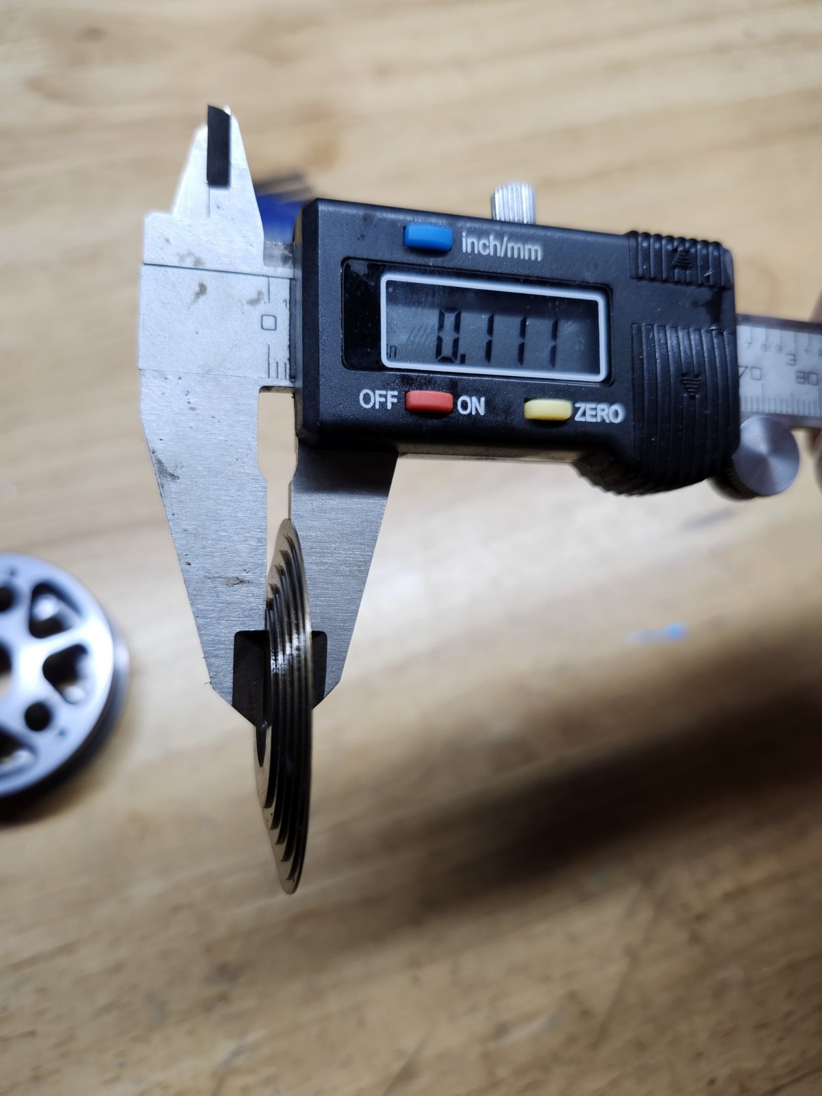

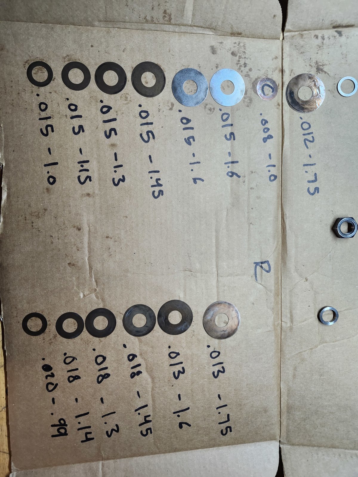

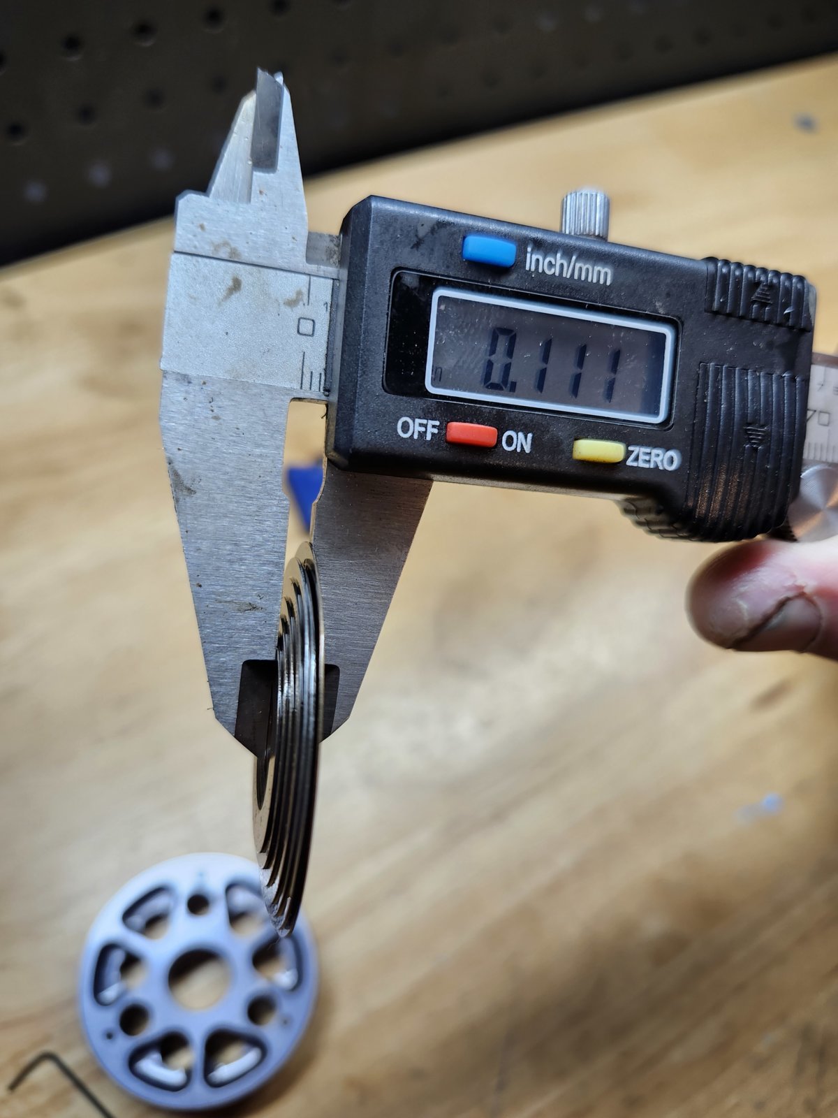

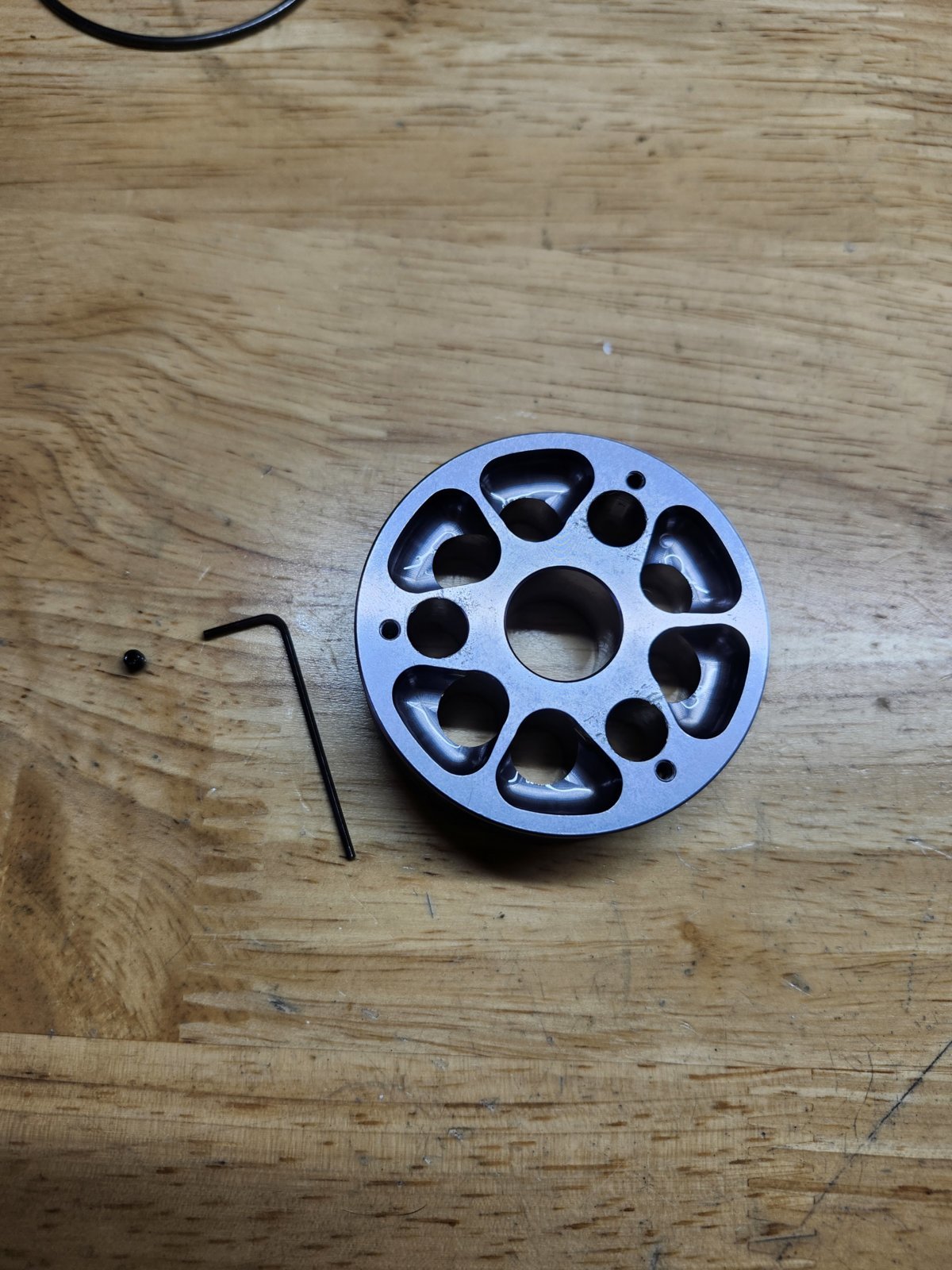

    So I got my coilovers apart to adjust valving for the bypasses.
    2 of the bleed holes were open, so I opened up the 3rd one.
    Already has a flutter stack.
    Is this valving going to play nicely with bypasses?

    Really need to know the thickness and diameter of each shim. Though the top one seems to be an 18 stack

    I'm brand new to this so bear with me

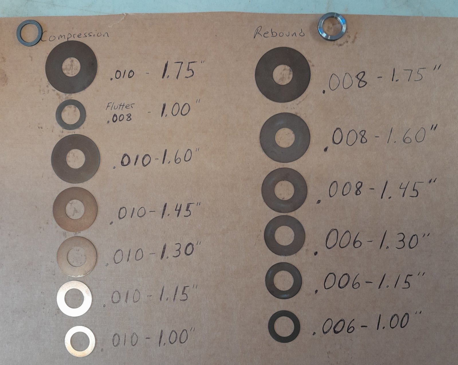

    Lay them out like this and the guys with valve sauce can see what you have and make suggestions.

    I would go straight 12’s on rebound. Compression is fine to start with.

    Would the thinner shims make rebound faster?

    In short, yes.

    On the bypass a good starting point would also be 15 comp 12 rebound. No flutter. Having valving in both shocks is a different world entirely. You won’t regret trying it!

    So keep compression the way it is?

    I would personally, then go 15/12 on the bypass. Not saying it’s going to be perfect but it’s a dang good starting point.

    So when you say straight 12s, every shim will have a thickness of .012 correct?

    On rebound side. Correct. You can buy straight packs from poly performance. Always been the route I go.
