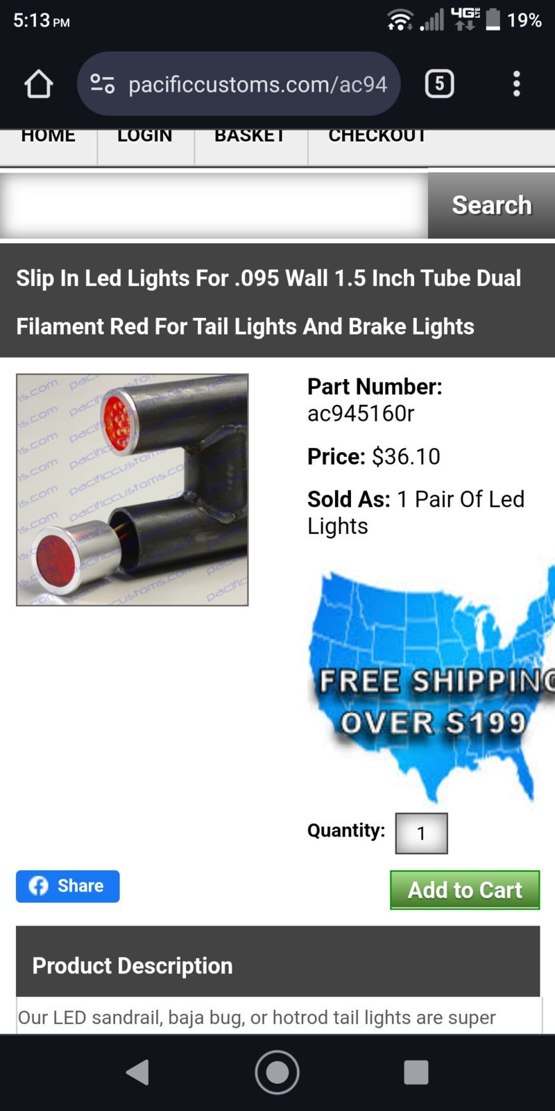

    Anyone know if there's someone out there selling something like this for 1.75"x.120" tube? I can sleeve some 1.5 into the 1.75, but i'd rather go with a direct fit if it exists.

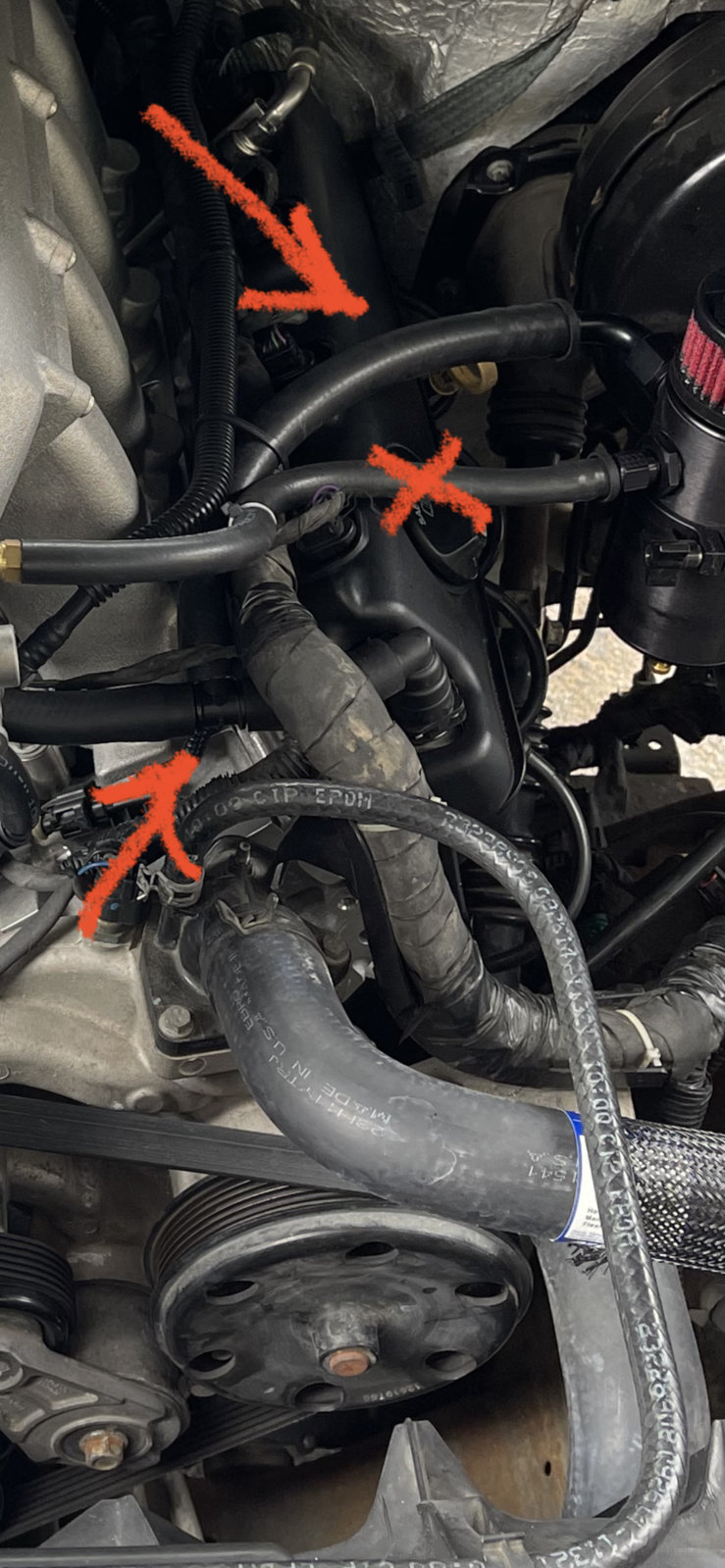

    So the pressurized crank case that pushed out the crank seal was from?
    like, I just explained we fixed the issue?
    What are you adding that I’m missing?
    Genuine ask as I’ve been on the road for alot of hours and have jellow brain
    this is an LT
    Not an LS
    It’s also running a aggressive cam with a 4” air inlet basically all the way to the heads since the intake is massive
    so
    The LT has a PCV system; that is what the can is tapped into
    By instructions.
    They also want a vacuum line right off the intake tube itself
    Nobody liked that so we put it on the TB where there was existing area for it.
    Doing THAT caused inconsistencies in vacuum at the can
    So at idle it was also inconsistent.
    Deleting the intake line and maintaining the two PCV lines solved the idle inconsistency…
    So, elaborate better if there is an additional change you see gaining me a benefit
