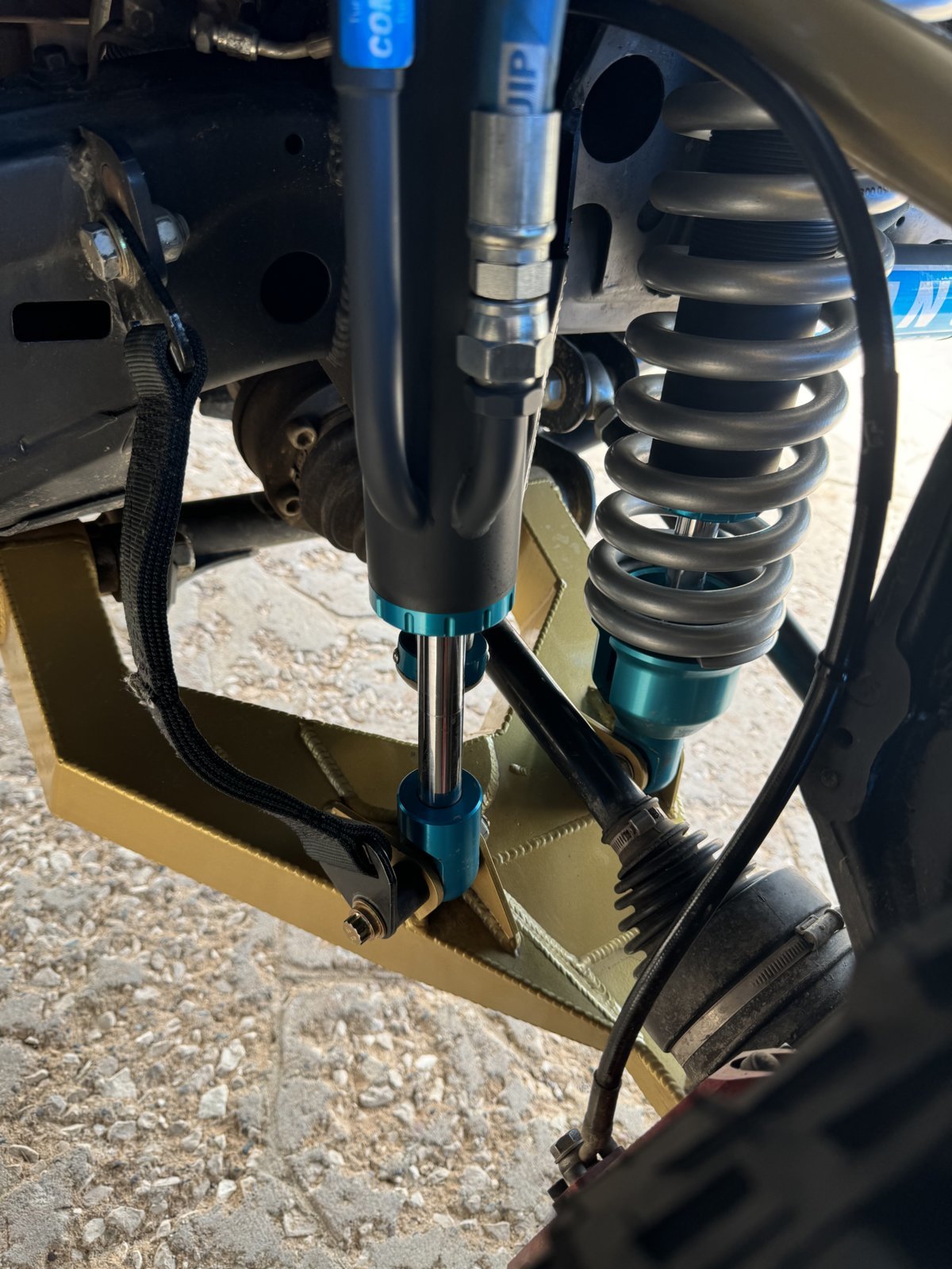

    Best place to put limit strap on TC kit with double shear and bypasses. Trying to keep it away from axle and tie rods. No room to put it where TC wants from instructions with double shear

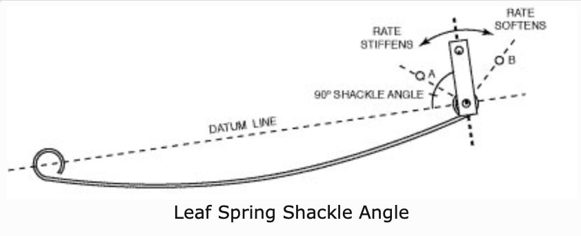

    Care to ellaborate?
  15. Aug 5, 2024 at 1:01 PM
    906taco
    906taco Well-Known Member
    Jun 22, 2021
    #369289
    3,903
    Cory
    08 Taco

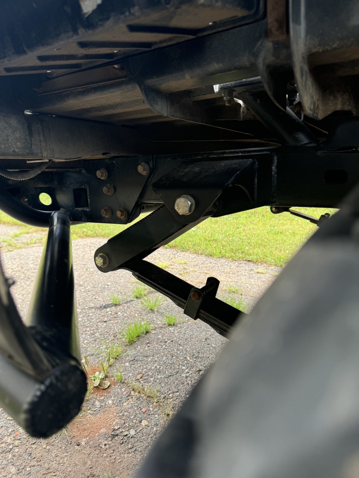

    The more vertical a shackle runs the softer the rate is. So it will blow through travel quickly until it firms up, then it ramps exponentially. By running more angle it’s much more predictable and fluid through the range of motion.
    Below is a picture showing how shackle angle is measured and how angle influences rate.

    Double shear and shock hoops today, revalved the coilovers. Took 8 freaking hours, didn't run into any issues other than rear shear bracket did not fit well at all on either side even with trimming. Maybe my shock towers were tweaked?
    Also do you guys run a bead on the top hat portion of the shock hoop once it's bolted down? With coilover out there is def some gap with the shock hoop. Wasn't in TC install instructions but seems beneficial

    My towers were definitely bent up some before I installed the double shear and bypass hoops.
    I bent/pulled them back before welding in. I didn’t weld my hoops to the towers on my camburg kit.

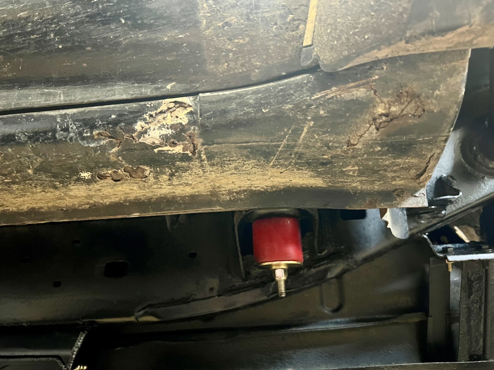

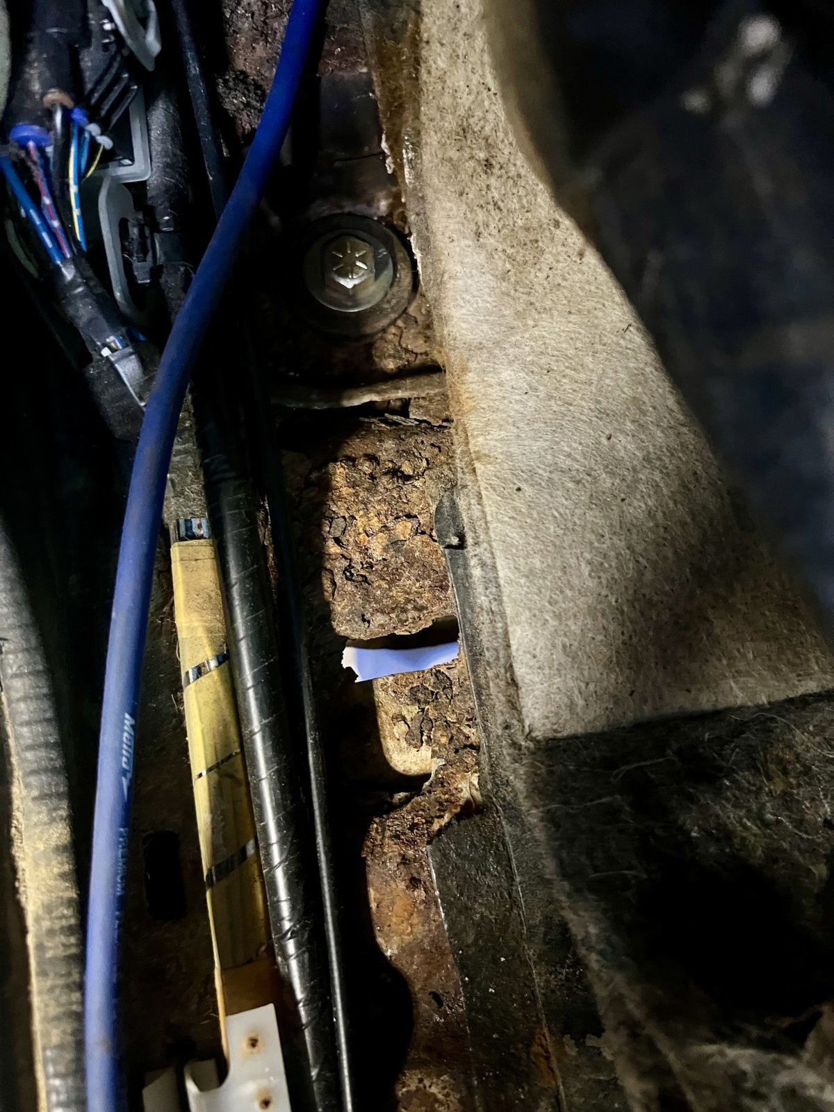

    This kind of rust is new to me. Not sure how to handle it. That’s a hole through the cab up front. Don’t want to weld this close to all these wires or bother with cutting out rocker panels from a donor…
    anything I can do to stop the rust and seal these spots? I figure since we’re in the south it will slow down significantly so I just want to keep the water out and stop the rusting. Structurally everything is fine. Is there a seam sealant or something that would work? Not fond of the spray foam solution from the previous owner :rofl:

    thats cut out and weld in new sheet time me thinks.
