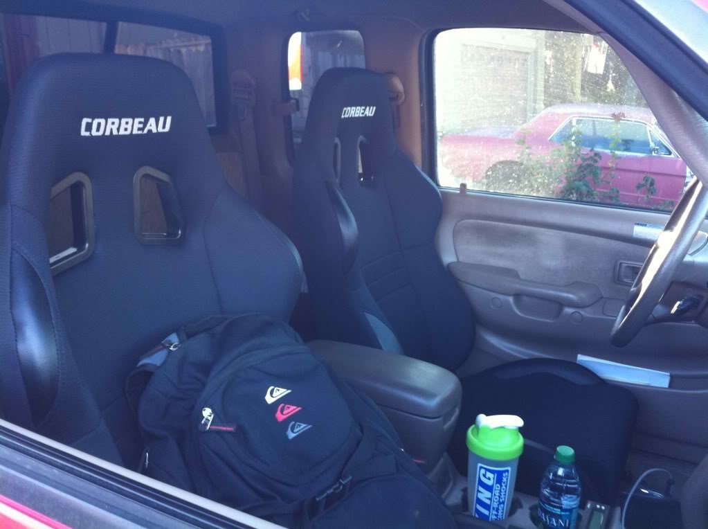

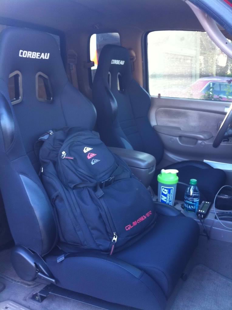

  20. Dec 27, 2011 at 6:48 PM
    #9580
    Mxpatriot
    Mxpatriot Well-Known Member
    Nov 18, 2009
    #26163
    3,620
    '06 4x4 AP LT and Locked
    Nice, those look like the seat back is adjustable, are they?
    How much were those bad boys?
