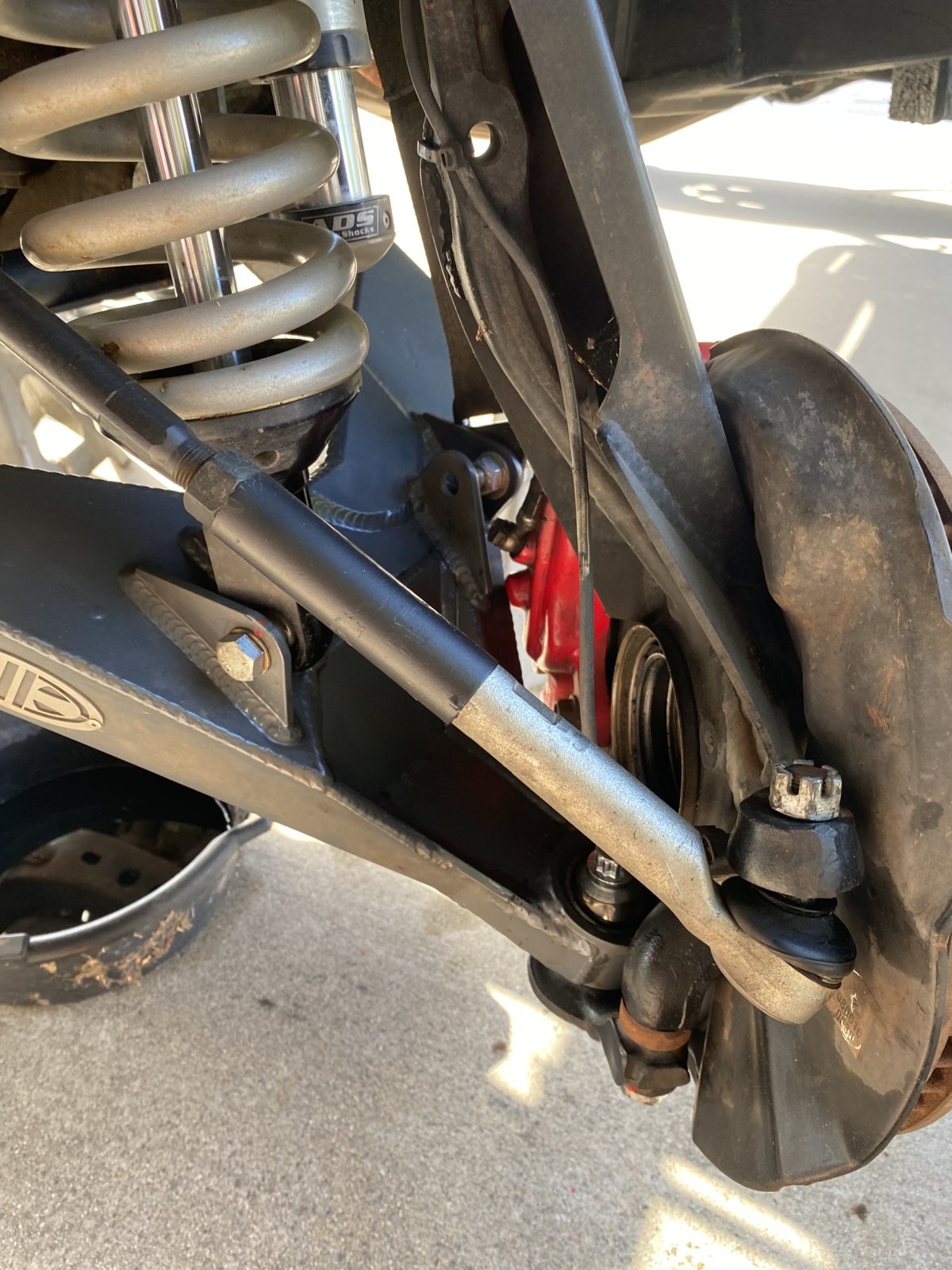

    I ran the steering stops and had the same thing happen, same kit. It hits the bypass mount.

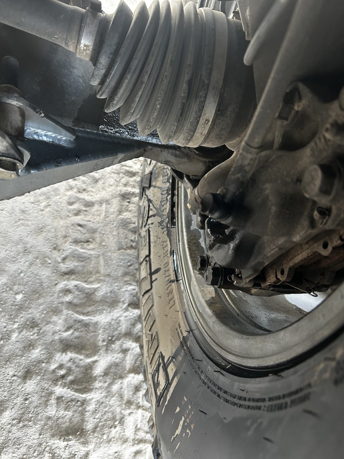

    Yeah, that's where it hit on mine.
    What did you do to correct? Was thinking of welding on a piece of 3/8" metal like on the DK kits.

    I don't know how you guys are getting enough steering angle to hit that.
    I cut my stops off the LBJ adapters and the limit is now the rear side of the adapter to LCA
    Definitely feels like I lost some steering angle to lock compared to before going LT.

    It happens at full droop. Plus, rocks add forces to the steering that you can't replicate in a static environment.

    I had it loosen my brake line several times and there were big gouges in the bypass mounts from the banjo bolt hitting.

    Can confirm. If it's not the caliper, its the bolt.

    Its funny, I lost a huge amount of turning radius with the JD Kit when compared to my old AllPro Kit. The difference between the 2 kits is that the JD kit uses the OEM LBJ adapter whereas the AllPro kit used a machined adapter. Hopefully I have the LBJ Adapters oriented the right way lol.
    Exactly where is everything touching? I can't envision it. I still have to go back to Ians place to finish the Bypasses and Bumps, hopefully we'll get that addressed at the same time

    Supposedly, there was a design change with the kit that prevents this from happening. I just so happen to have an older kit.
    Andrew's pic shows it well.

    Thanks for the Picture, super helpful. My calipers are different, I don't have that Banjo Fitting. I bought my Kit used from @RonRon23 and I believe his was the 2nd production +4 Kit that was made, so it's an older kit.

    Doesn’t the wider track make the turn radius worse? I could be wrong. When I cycled it on my truck, my banjo bolt was close, but not as close as some of these pictures I’ve seen from the 2.25 kits. I also removed all my steering stops.
    Edit. I was also moved forward on the pivot kit and slide rack. Not sure how it changed how it all fit.

    Yeah, my banjo has left an impression on the LCA. I guess I should solve that problem at some point.
