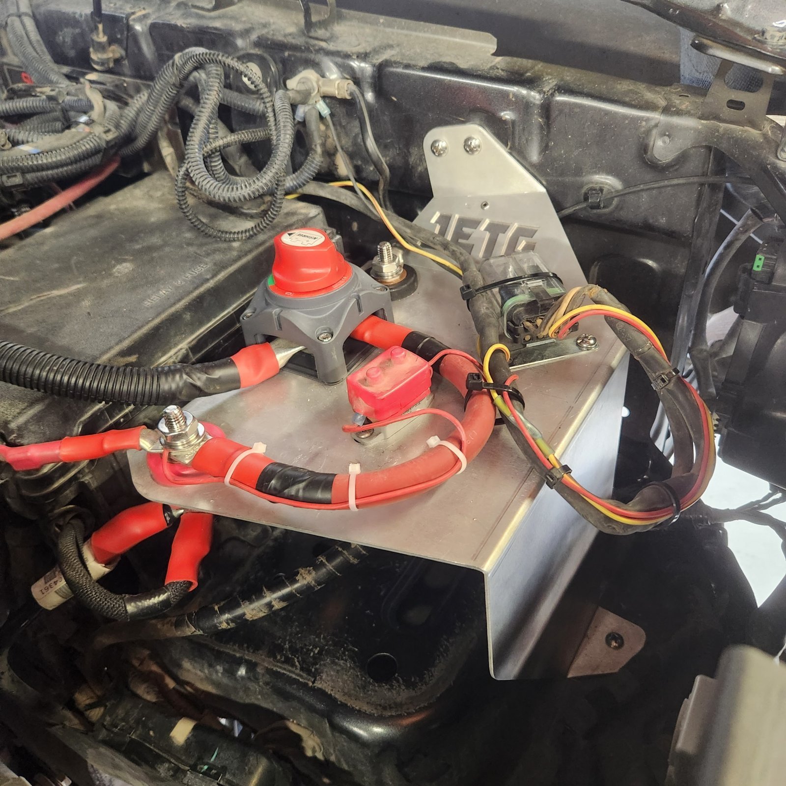

    Ain’t nothing wrong with that. I pay for convenience, too. Especially if it’s something I don’t know much about or care to get into. The battery tray adapter is pretty neat. Easy way to get the new cables connected without hacking off factory stuff. Could mount some stuff to that, too.

    The mount plate was drawn to have room for most fuse boxes and a Switch Pros. Their website should have CAD pictures showing that. Although they also posted pics of a modified install, not how it was intended and that can be confusing. I sell the mounting plate separately if you want to contact me directly.

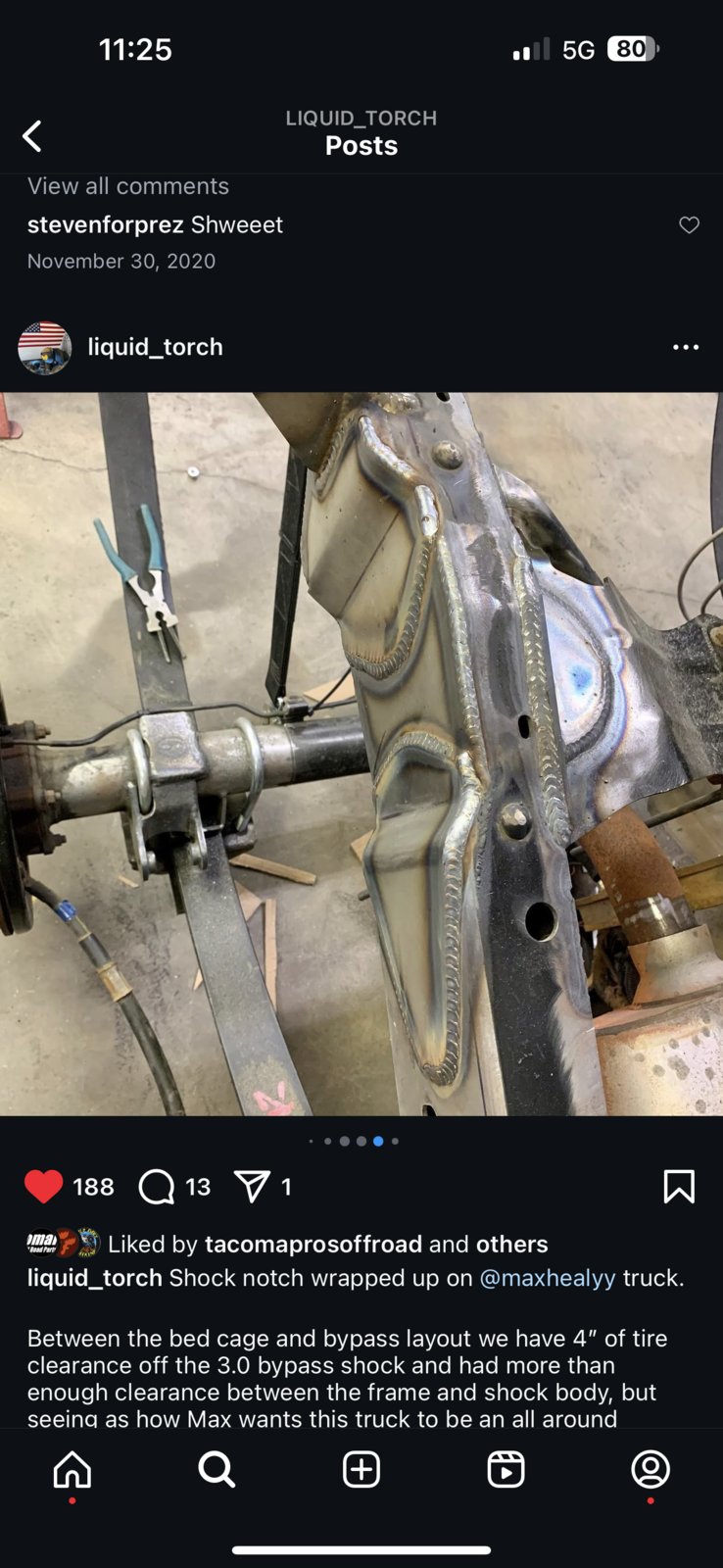

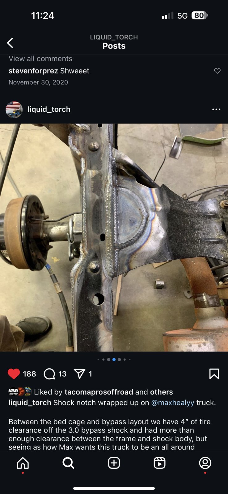

    anyone done a stock frame notch to move shocks inboard for more clearance?

    Yup.

    Excellent! its in my future.
