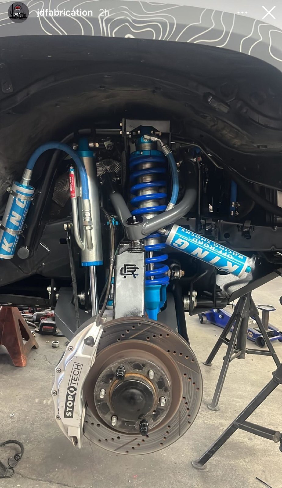

    mmmm JD fab LT....

    thats not mine, I run a 550LBSx18 on my Built Right kit

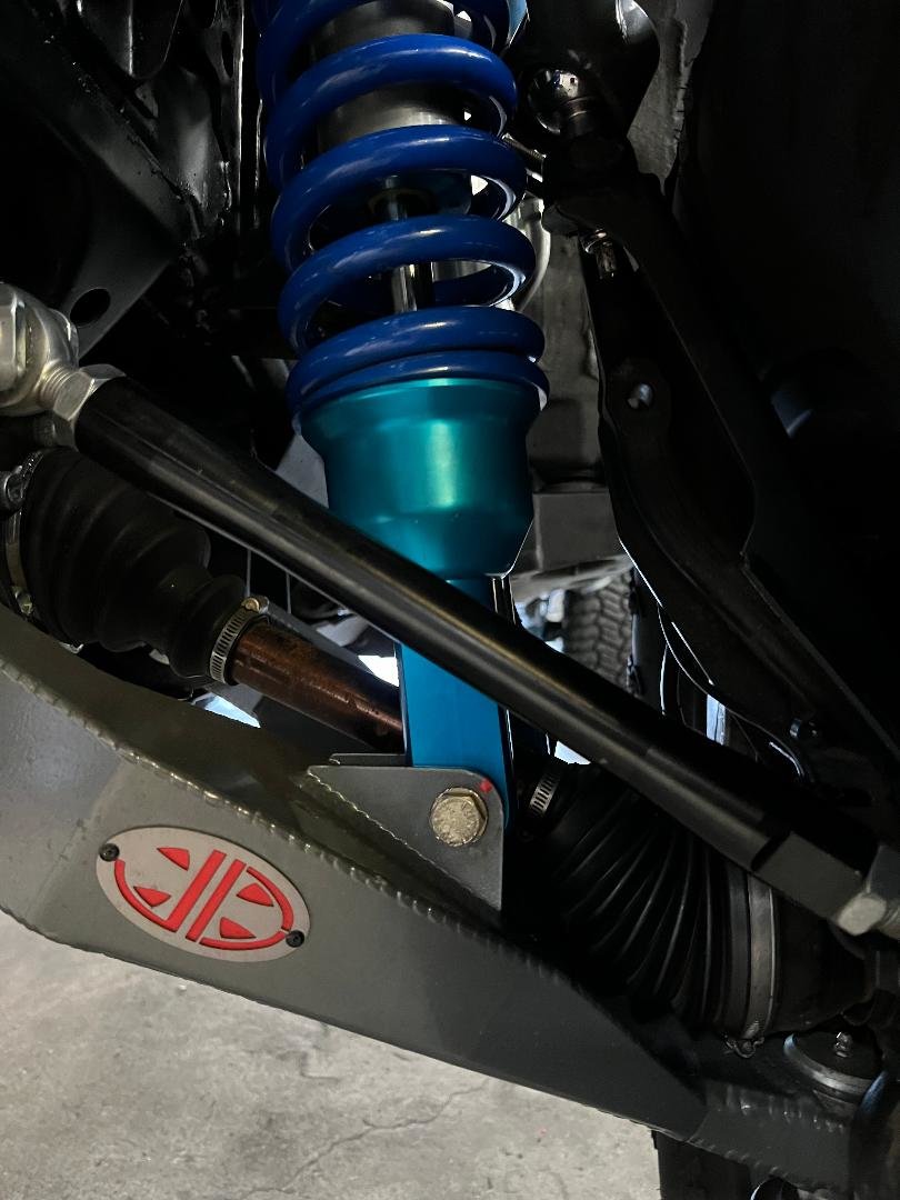

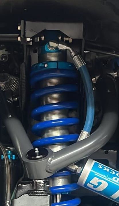

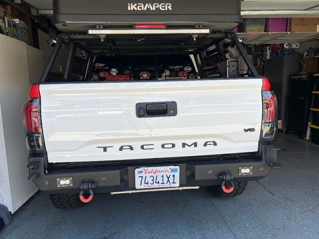

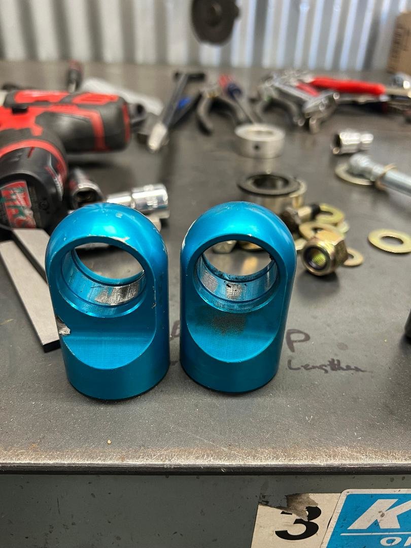

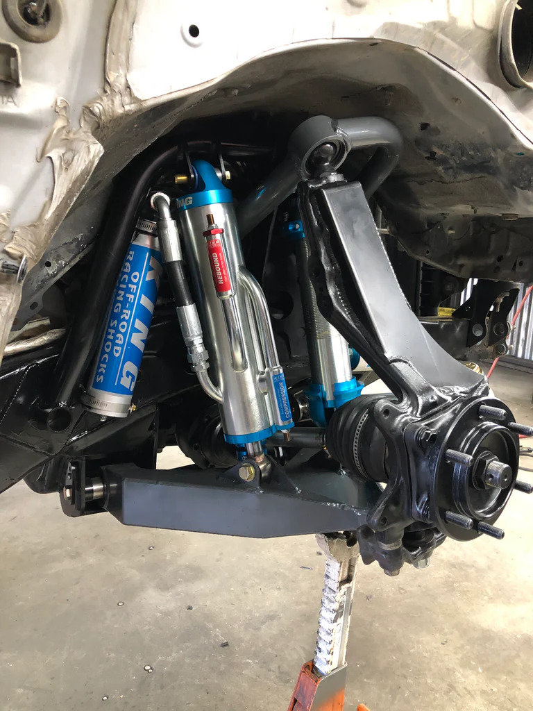

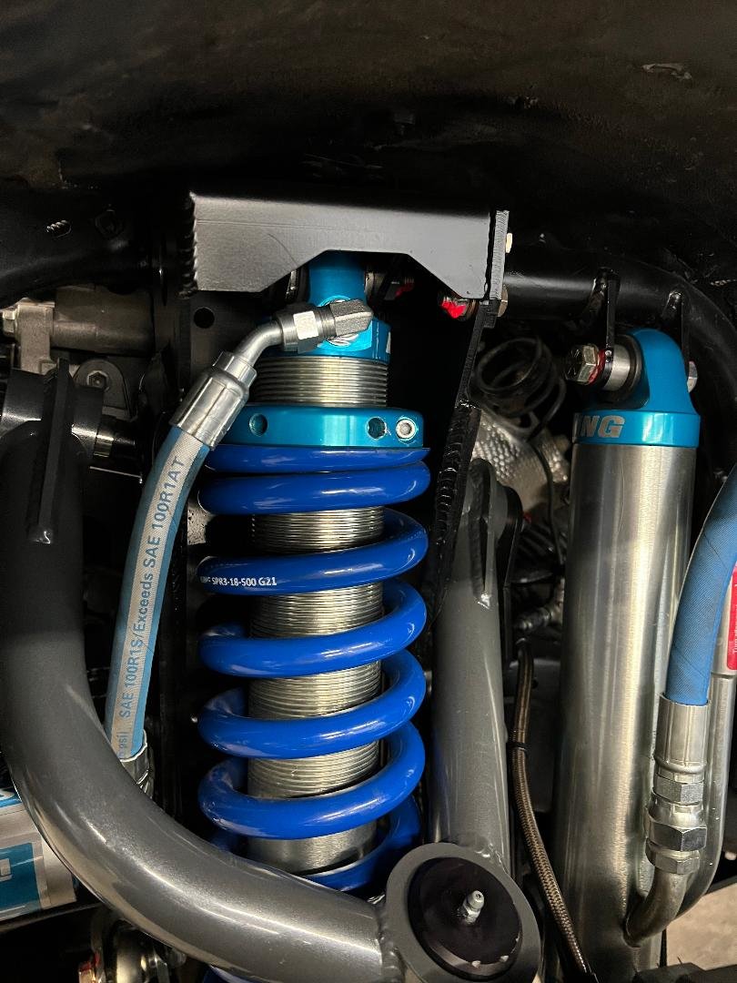

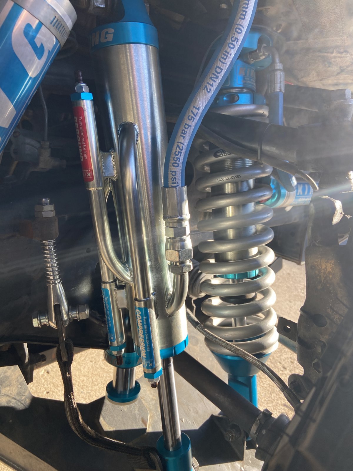

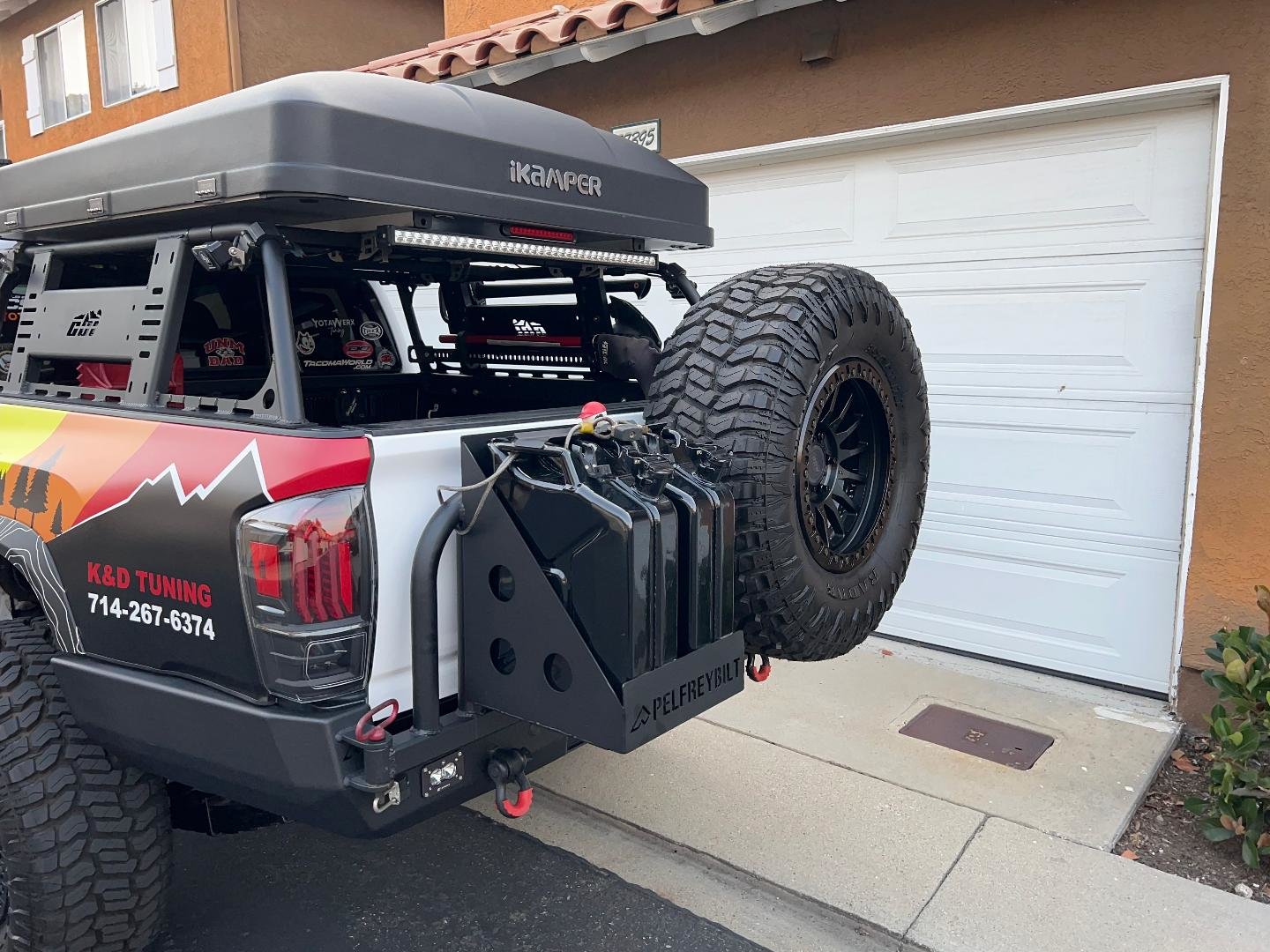

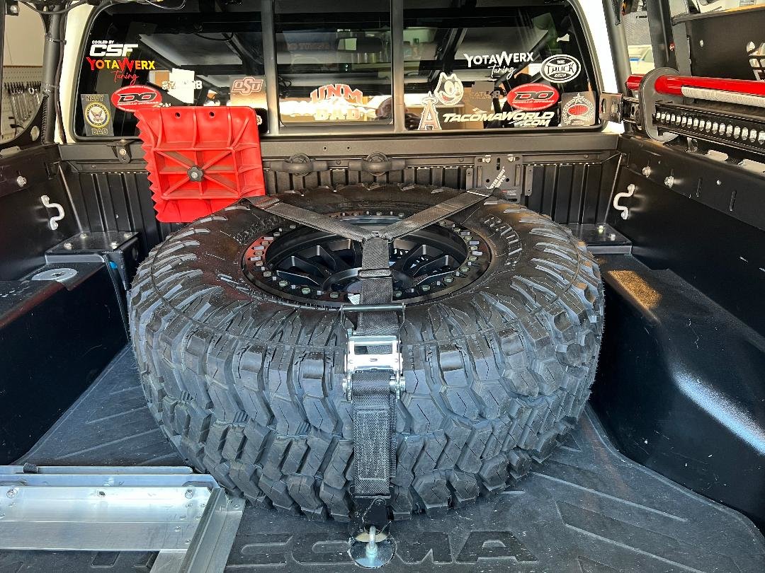

    Just picked up my truck from JD. Raised the front shock mount with 2" longer King shock ends new top mount. Got my lost steering back I can now do a 1 point U turn again. Had some tie downs added in the bed for spare tire bed mount with Speed strap. Making the swing out optional for different trips. Truck looks damn strange without the swing out. That's a lot of weight off the ass end.
    JDshock work1.jpg JDshock work.jpg JDshock work6.jpg JDshock work5.jpg swingout.jpg noswingout.jpg Sparemount.jpg
