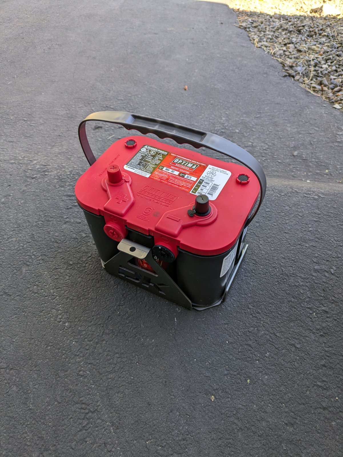

    I finally got bigger tires 2020 Long Travel Tacoma 1997 MAGNUM
    Got all the parts for the relocation.
