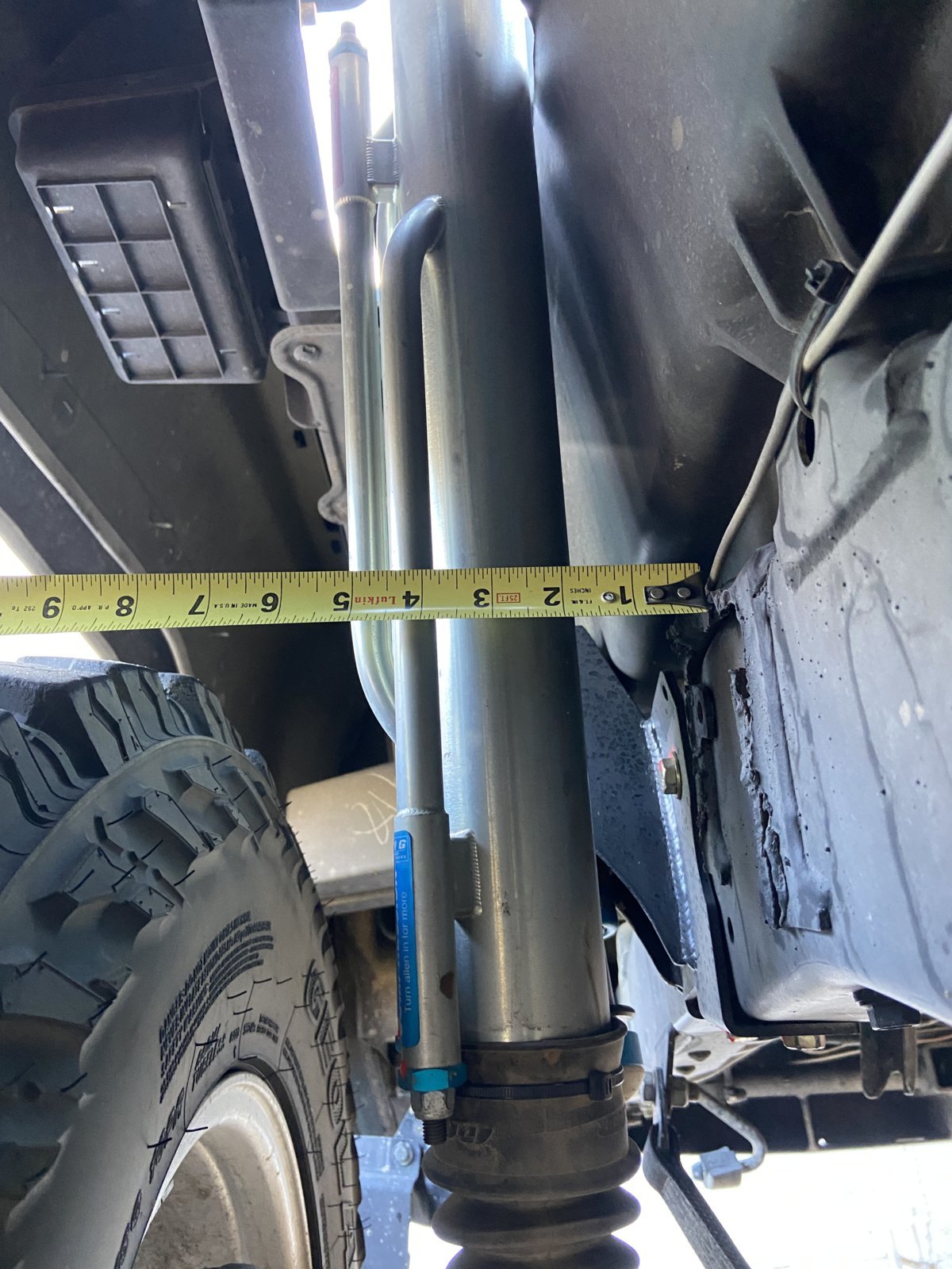

    hmmm to upgrade to 3.0x16 bypasses or not to?......
    As it is at full articulation stuff I am rubbing the tubes on a 2.5.
    However, new beadlocks are on the way @ -32mm offset, and it looks like there is enough room to simply turn the bypass 180 and move the tubes on the inside?

    yes, and the rear is weighed at 2800LBS loaded for des trips. last run when I stopped. the shocks were too hot to touch.
    More oil is just for heat?

    3.0 is going to increase dampening as a whole with less effort which in turn decreases heat. But oil volume also decreases.
    Notch the frame and go 3.0.

    Undoubtedly nothing wrong with going to 3.0 as long as you’re cool doing a frame notch. I’m on -38’s with 1.25” spacers and still kiss my 2.5’s.
