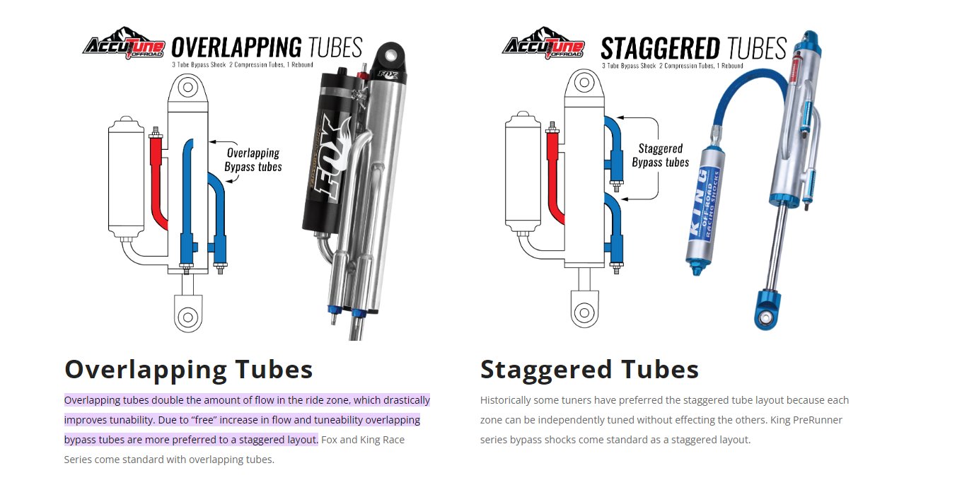

    Bypass tube layout.
    Are you still on "free bleeds"?
    Performance Series
    5/8" tubes?

    It's a King thing. They offer different "bleed" holes on their nylon bypass check valves.
    Fox does not. You can of course drill a hole into the check valve but it's not a standard thing.
    Unpopular opinion, the 5/8" bypass tubes on a King Performance Series do not offer enough bypass flow for good ride quality & performance.
    ESPECIALLY in their "staggered" layout.

    Staggered as in one shorty and long tube layout?

    I know I have read some of them, I have overlaping

    Copy. I have Fox and all my vehicles have Fox.
    My rear shocks are 2.5-18" stroke with only 2-long bypass tubes (1 comp, 1 reb) so the shock is almost just a smooth body. I've been fighting dead loss in my cooler the entire time I've had the truck from a violent rear. Started at double stack 15's and revalved all the way down to single stack 10's and I'm back at double stack 15's with both bypasses closed and I finally think I have it. Plus I found I have to drive faster for it to be smoother.
