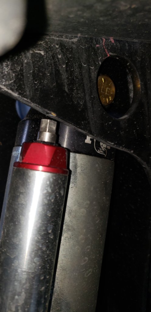

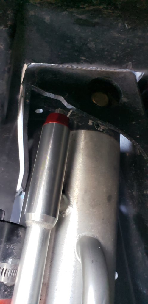

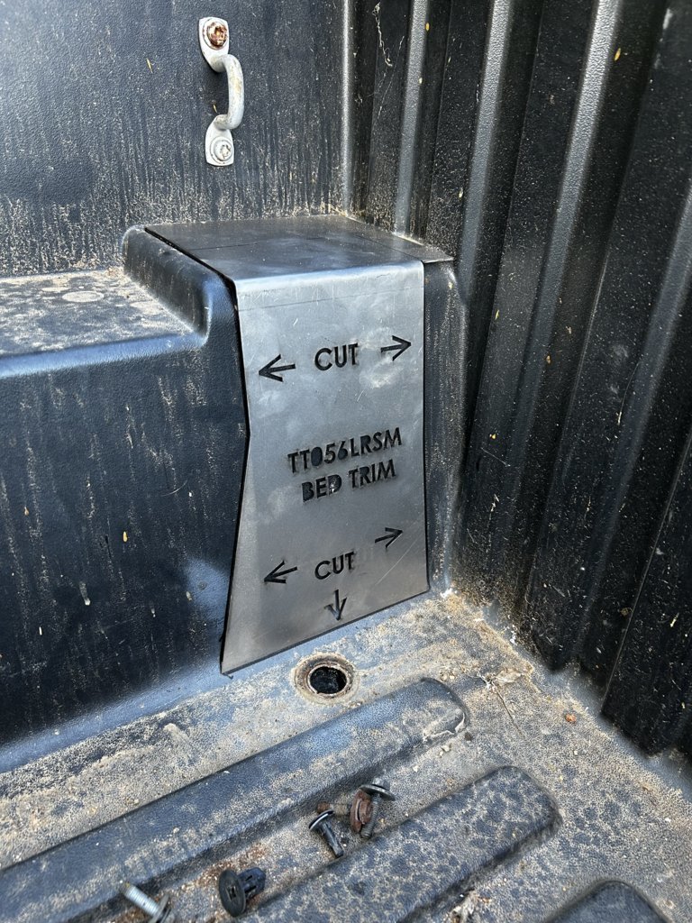

    ON the Shock tower..check the Rebound Bypass Adjuster clearances at the top of the Shock Tower (Bottom Side). Full droop will trick you into thinking there's enough clearence, but will touch at full bump.
    Another Tip: Install the Square Plates that goes on top of the Towers and to the bed before torqueing the Towers down, that will help with proper alignment. Ian helped me with the SUA and Frame Brace install so he has 1st hand experience and knowledge if you get stuck with anything

    you could have rotated the body cap instead of notching the shock mount
    AShive92 likes this.

    : facepalm: I totally forgot Fox makes it super easy to rotate the Bodies
