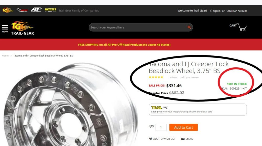

    Quote from reply on delay with shipping:
    Looks like they are in the works. Looks like there was 1 that needed to be made so my team is in the process of getting that complete for you.
    Webpage has to be wrong....:smash:

    They're 45lbs a piece... holy shit

    I guess thats bad?

    Beadlocks are heavy
    And unsprung weight wears out parts quicker
    So logic is you want “lighter” beadlocks for off-roading cause hubs and such

    Current wheels are 40 lbs and tires are 60(c rated), previous were 51 and tires were 65( e rated) lbs
    I figured 5 more lbs wouldn't make a difference
    I mean I am heavy already Front 2700 LBS and Rear 2800LBS

    The issue is sprung vs unsprung weight.
    https://www.valoroffroad.com/blogs/the-source/how-wheel-weight-impacts-your-vehicle
    5lb of unsprung weight can make a big difference on wear on components. I mean, so can jumping your truck and we do that anyway, but people do tend to try to optimize wheel weight.

    I was surprised to see a forged alum wheel that was that heavy, totally get beadlocks being heavier but people usually choose forged aluminum because it is stronger and features can be made smaller (and lighter) without compromising strength. 45lbs is heavy for any alum wheel forget forged ones. Mine aren't beadlocks but the wheels are only 26lbs.

    For reference, my method 101 beadlocks are 37.34lb per wheel.
