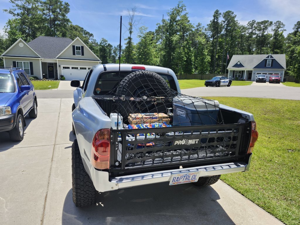

    Looks like someone is waiting for you to make a move!! :rofl::rofl:

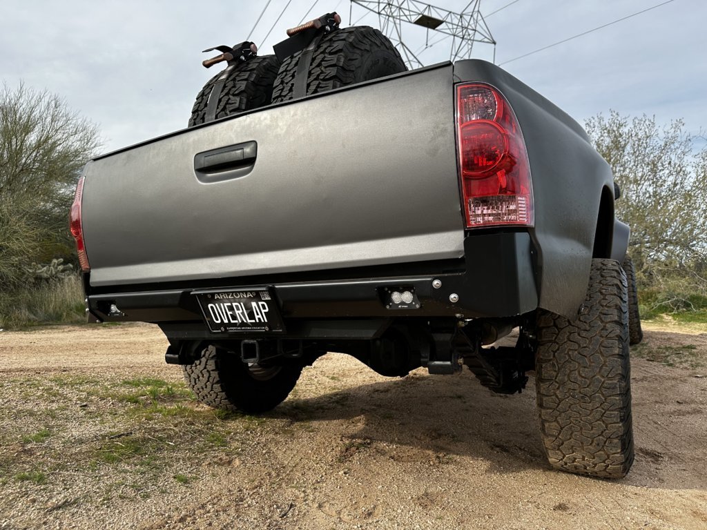

    I just have a license plate frame with the lights built in. Super easy.

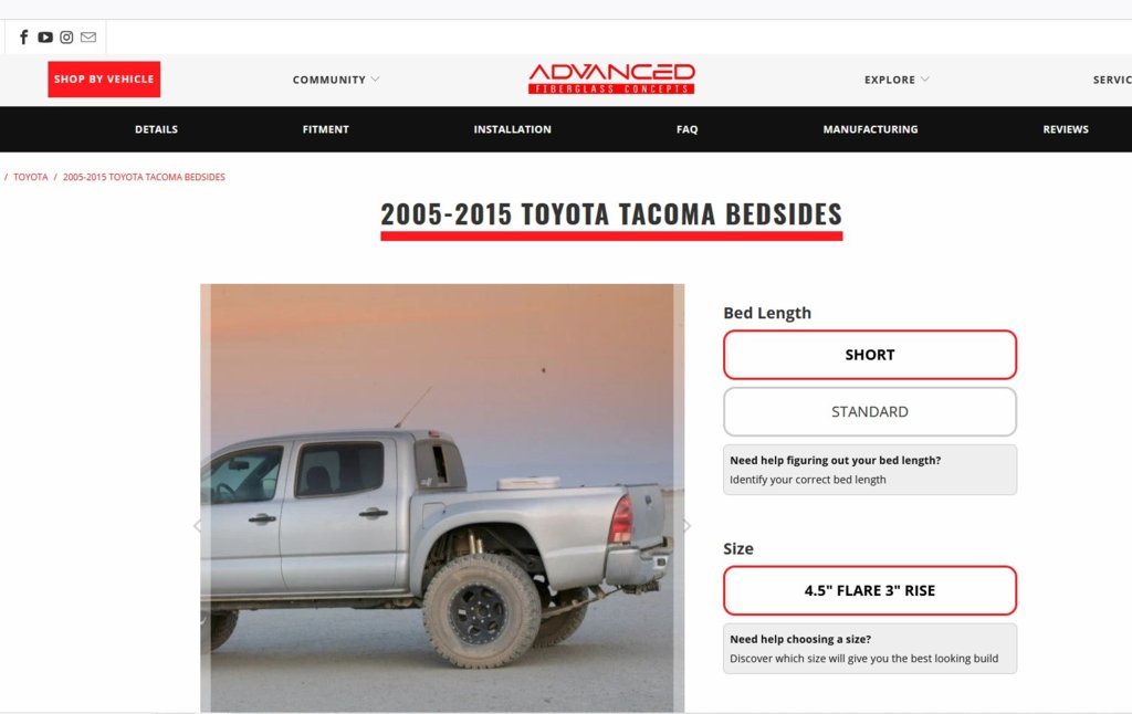

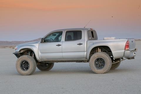

    Adv 4 inch

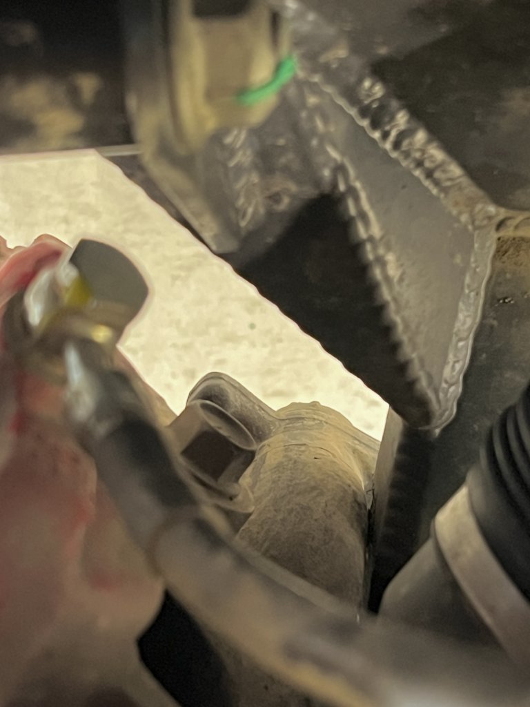

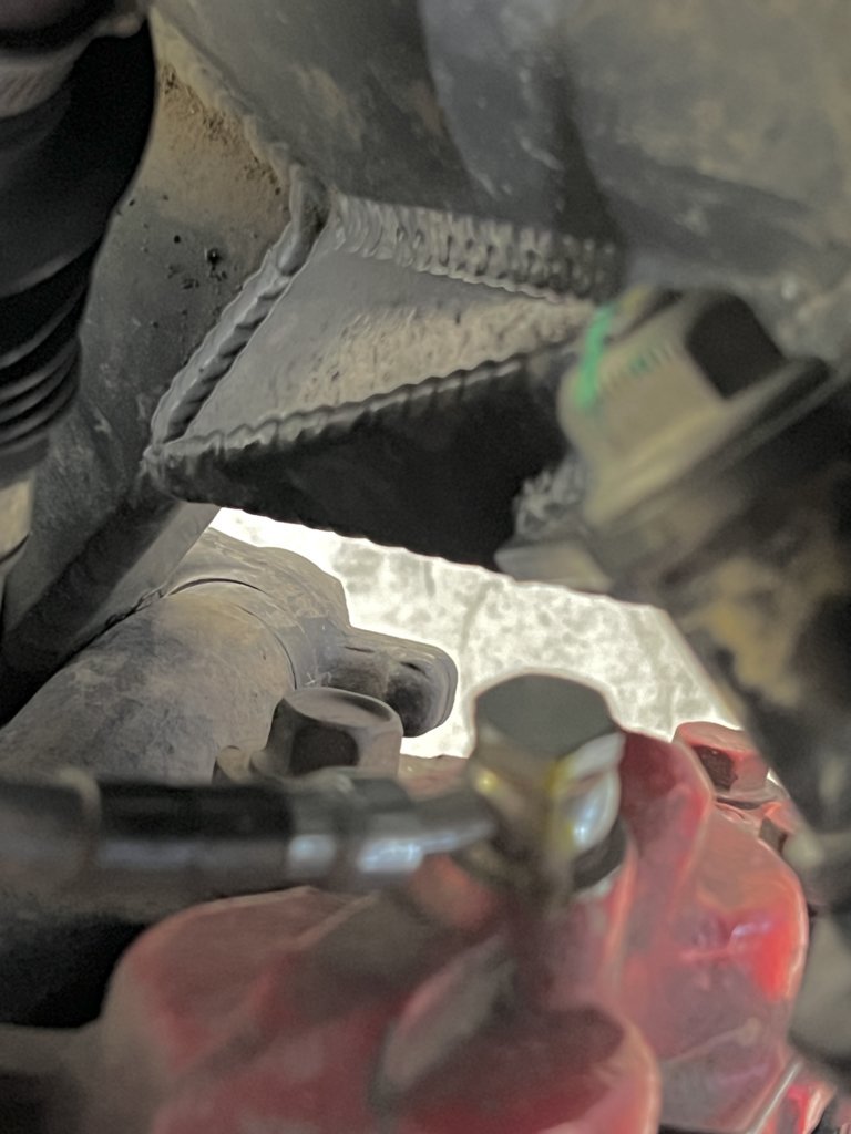

    I missed the boat several pages back when we were talking brake banjo contact to the bypass mounts on the JD LCA at full steer lock, full droop. Is that only on the 4” kit?
    This is full droop (strapped) and full lock (you can see the balljoint adapter smashing the LCA in the pic)
    There’s about 3/8” clearance to the banjo, and I find it hard to believe the upright deforms enough under load to have those hit.
    I’ve been minorly annoyed with the steering angle reduction so trying to figure out if something is wrong or different in my setup.

    No, it happened to me on the 2.25” kit.
    JD made a revision to the kit and made the LCA wider to prevent the issue. I have an older kit.
    Would explain you loss of steering

    I wasn't making contact with stock brakes on my 2.25" kit but I do on the Powerbrakes. It's a new revision I imagine, installed in January at JD. There's a small nick in my LCA from the banjo making contact.
    I'll probably go to a Tundra rack or maybe 74Weld's here shortly which will limit my steering and I'll just, uh, carry a spare banjo and fluid for the mean time, I guess.
    Jesse had warned me that I’d need to adjust steering stops with the powerbrake kit so I assume it’s still a known thing.
