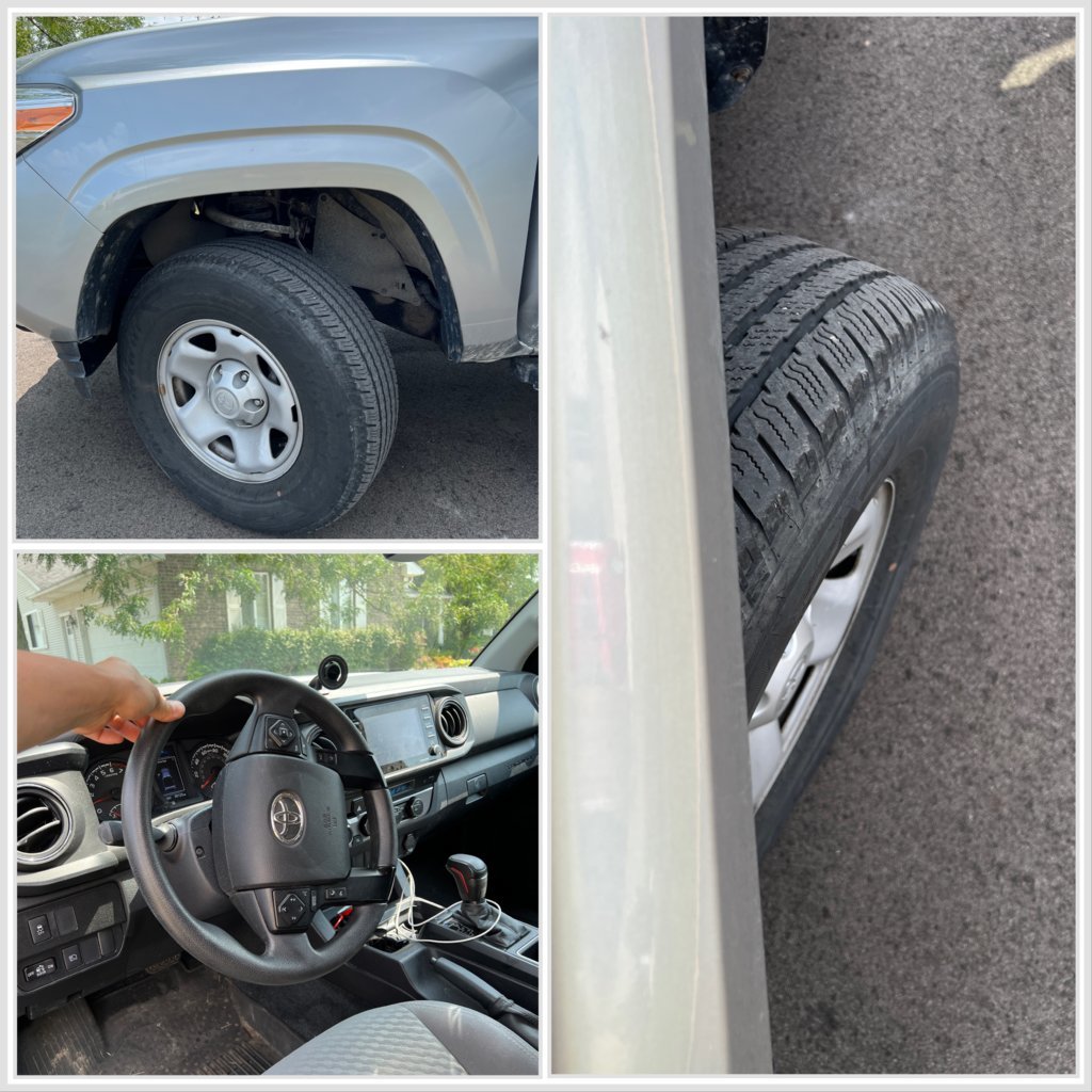

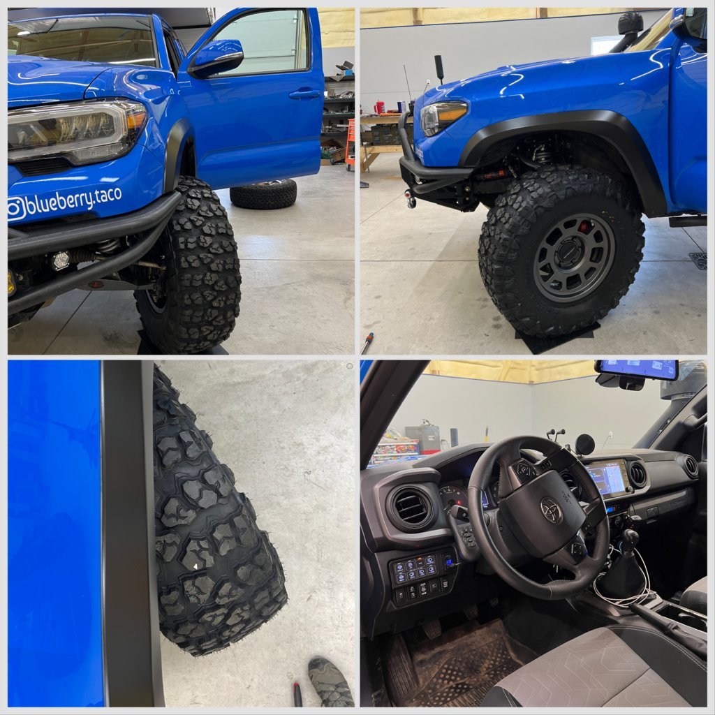

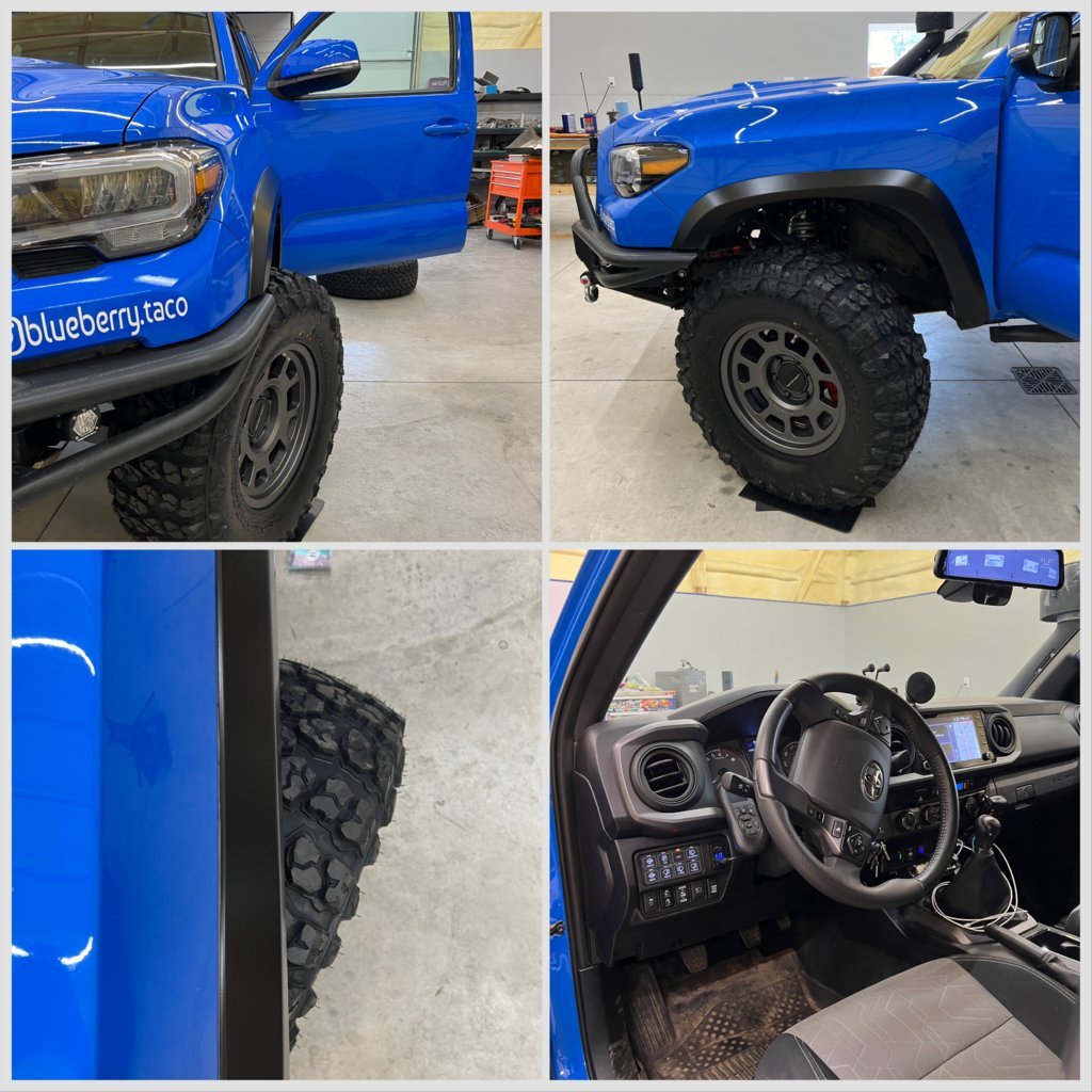

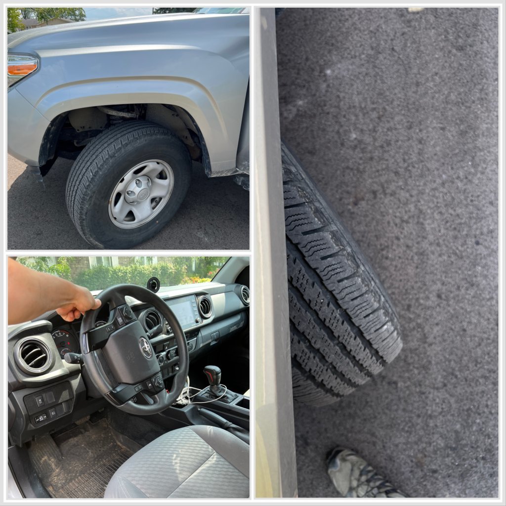

    Long travel house on 35s with a custom aluminum utility bed and FWC
    some welding required
    my bone stock SR has a full 3.5 turns....

    You’re not wrong. That’s my bad, I looked at the wrong note of mine lol
