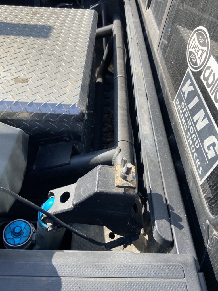

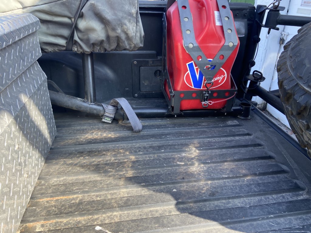

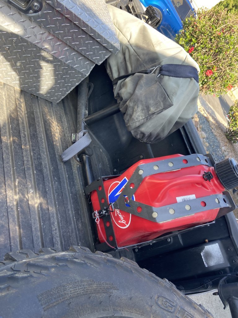

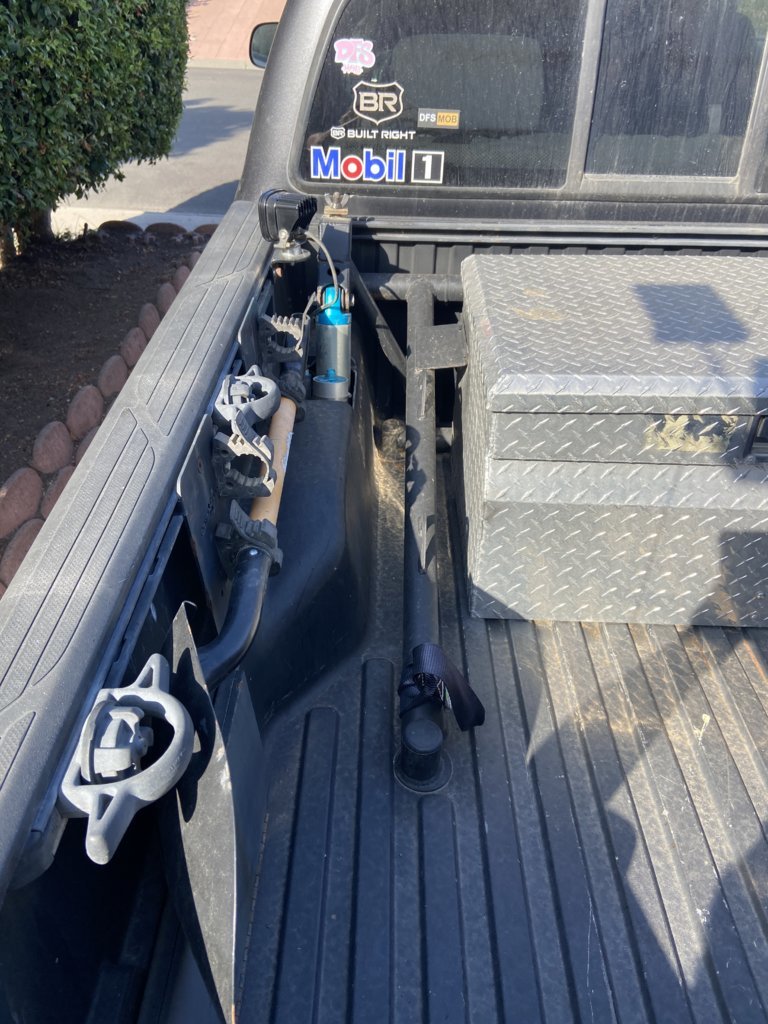

    here ya go, more than likely moving the tool box out a bit to fit a 17 gallon aux fuel tank, and then moving the co2 tank from the cab to where the vp fuel can is and tie in all bed mount points.

    Pretty sure the dirtking bed cage also bolts in the same way. And I’m sure others do as well. No real issue with it. Upgrade to grade 8 and do heavy wall DOM tube sleeves between the bed and bed cage for extra rigidity.

    Hell yeah thanks, 16 inch shocks?

    yes, 2.5 x16 triples

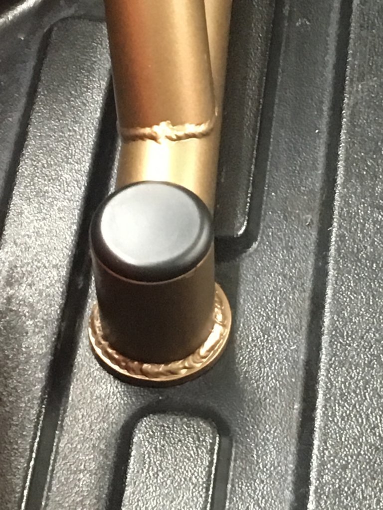

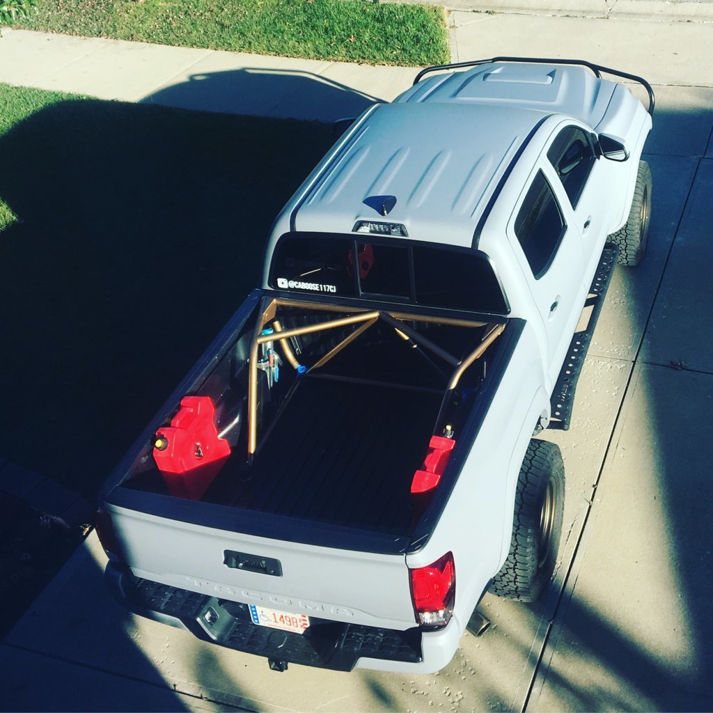

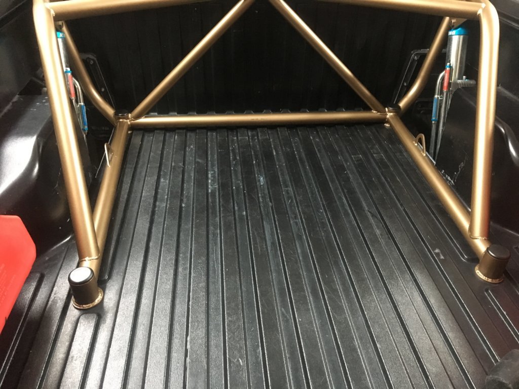

    Before I ripped my truck apart for 4 link
    My bedcage was set up on those 4 bolts
    We had to add a spacer to make it more stiff under the bed between the frame but otherwise it held up perfectly

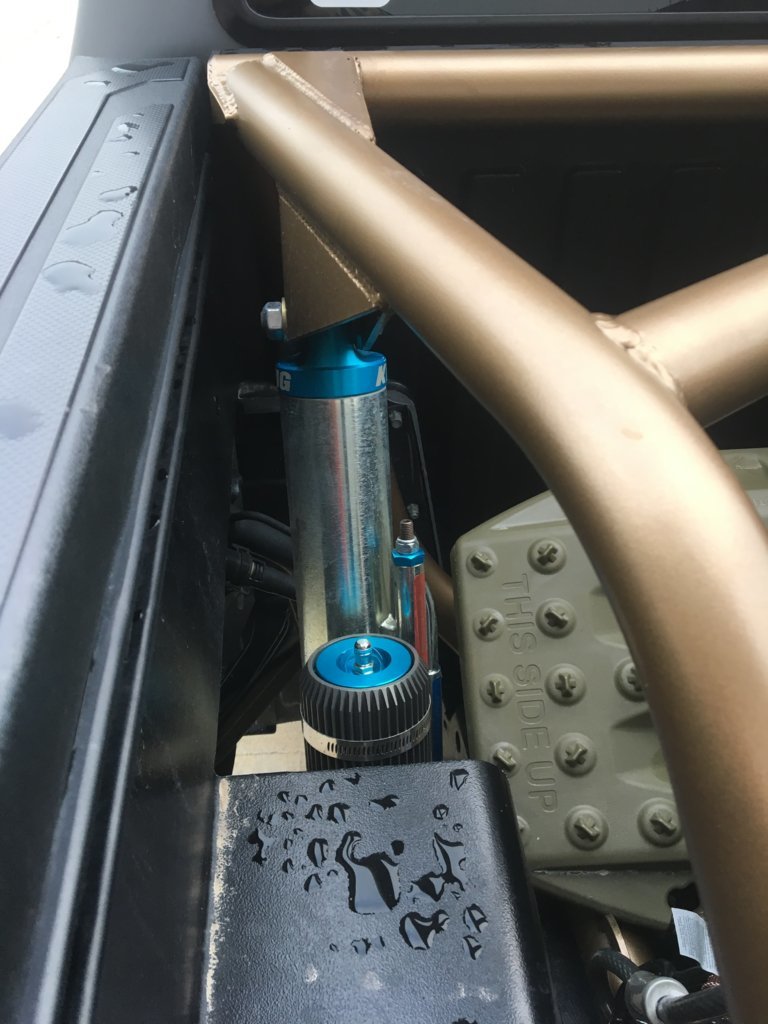

    1996D6C9-1024-49D0-AE4B-22DFA636C043.jpg CFF68B44-C210-4792-8BA7-7AC4F2CD5D0F.jpg 40BE74E9-E78E-4D37-A36F-C20A66E7F7F1.jpg E08149BD-DE3E-423C-8C26-787D11B7D1D7.jpg

    2.5's?
    Interesting your tubes are on the inside.
