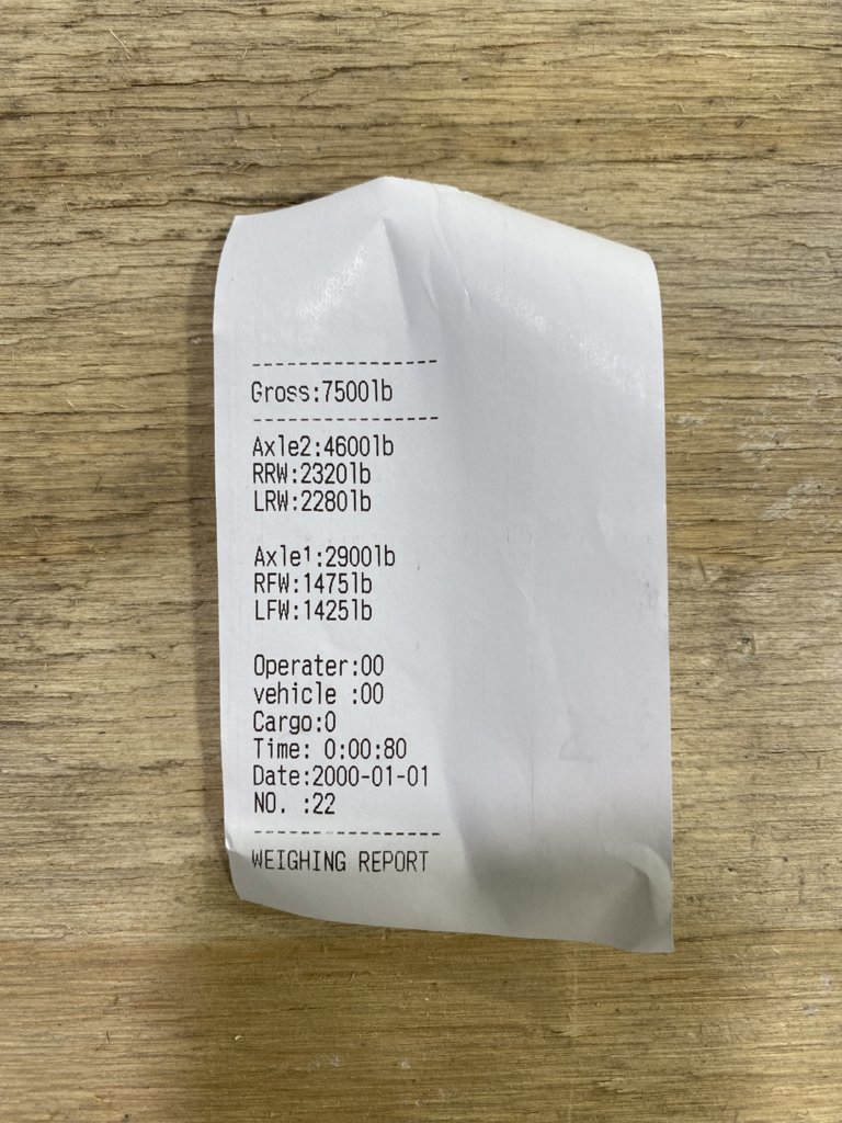

    some welding required
    What a lightweight lol
    At least overall. Wow you have a heavy front end!

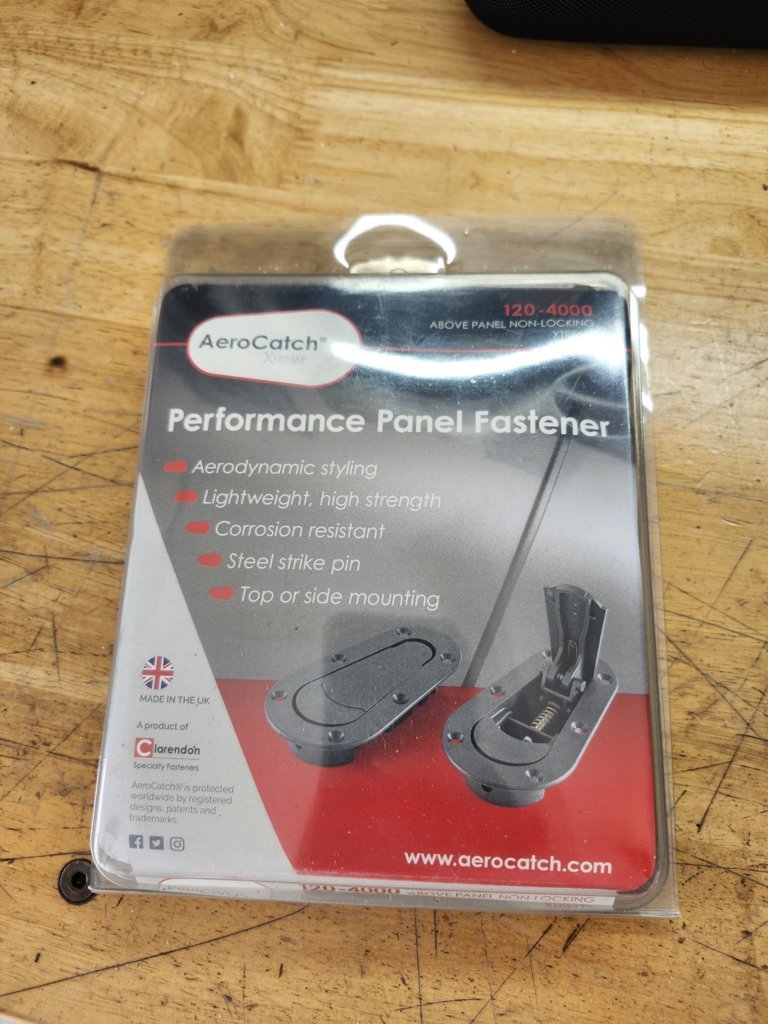

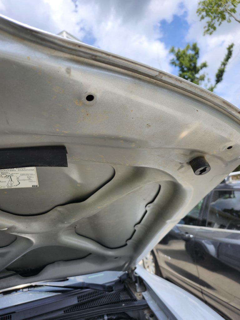

    Anyone running aerocatch on a stock hood? Bought a set after a recent post about a certain someones hood flying up.
    Seems like you would have to not only cut a hole in the hood surface but also the under portion to be able to bolt the mounting plate down. There looks to be about a 1 inch void between the two.

    Got a How to in my build thread.
    https://www.tacomaworld.com/threads...s-cab-slow-build.264263/page-37#post-10676470
    I would recommend getting the steel pins instead of those aluminum ones. I broke several of the aluminum ones due to washboard roads and the chatter. Reinforce the core support where the pins attach or that will crack too.

    Perfect thanks, my kit has steel pins so that's a win. Might rattle can them the same color so it doesn't look too dumb.

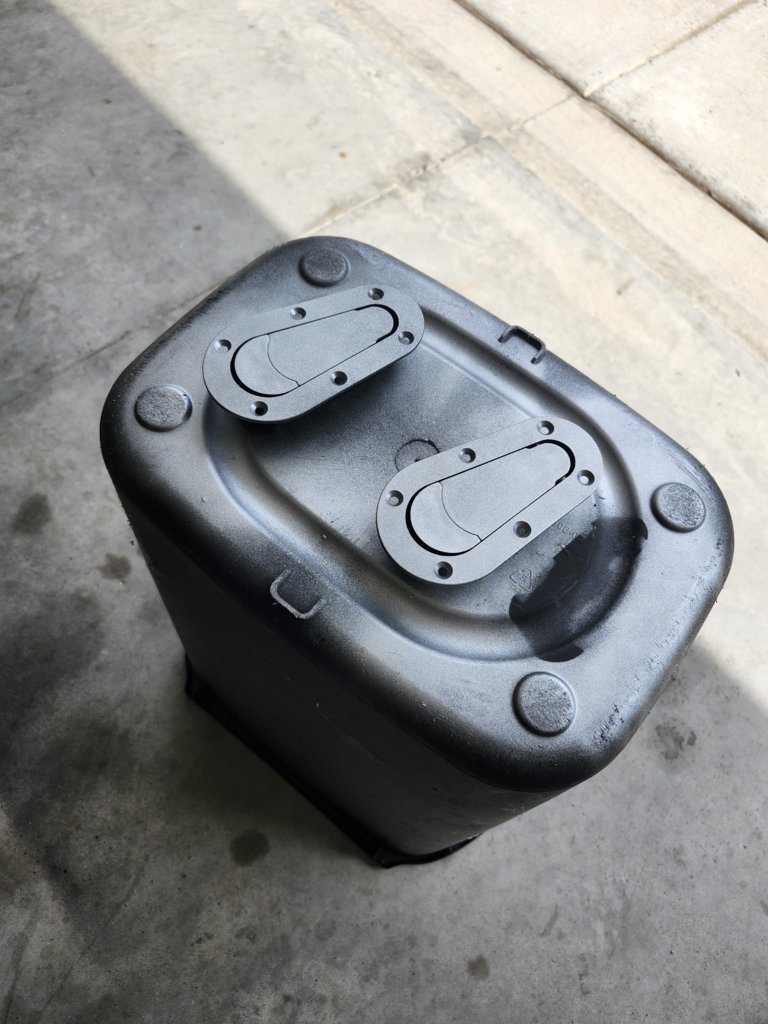

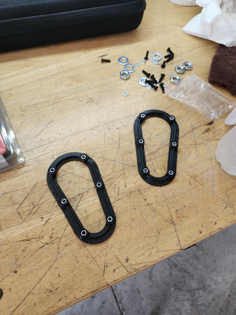

    Got me motivated. Put a dab of superglue on each nut and painting the latches now.

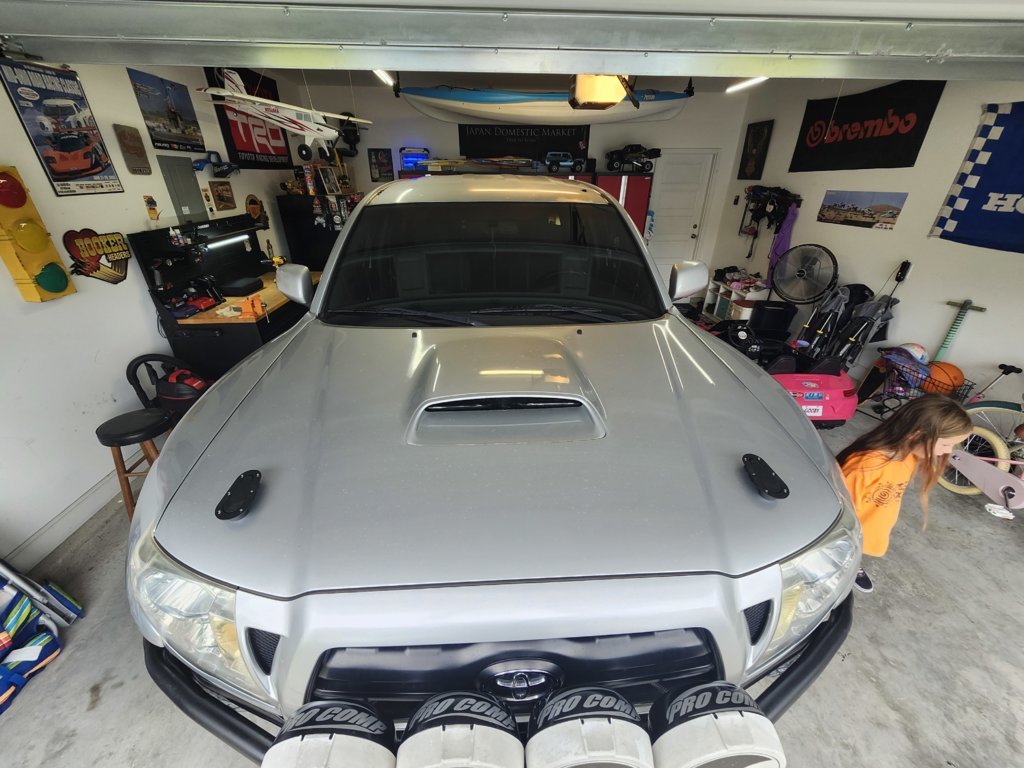

    Torspd had them on his truck when I lived near him in 2013-2014. Assuming he still has them, that's some decent longevity.

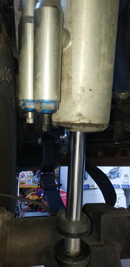

    All this talk about shock seal leaks.. short tube adjuster is already leaking, and these are just a few months old.
