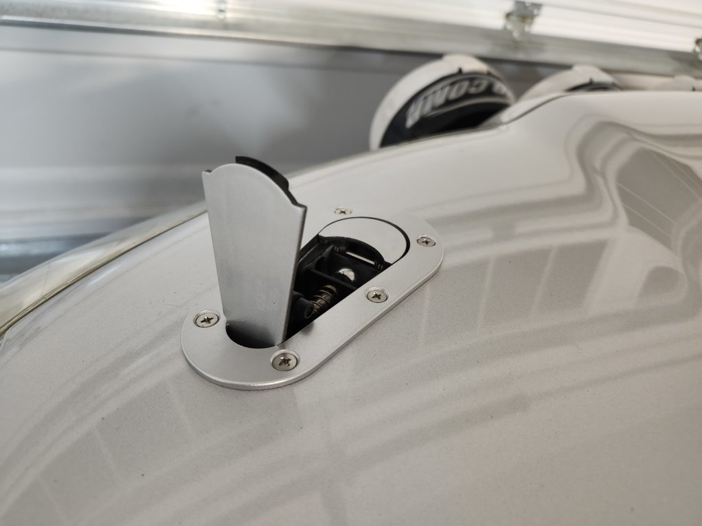

    I mounted my hood pins to just the core support and one fully ripped out of the core support and the other is about 75% cracked, so whatever you do reinforce where you mount it.
    I’ll probably add thicker plates in the corners of the core support and try to find a different hood to start fresh with.
