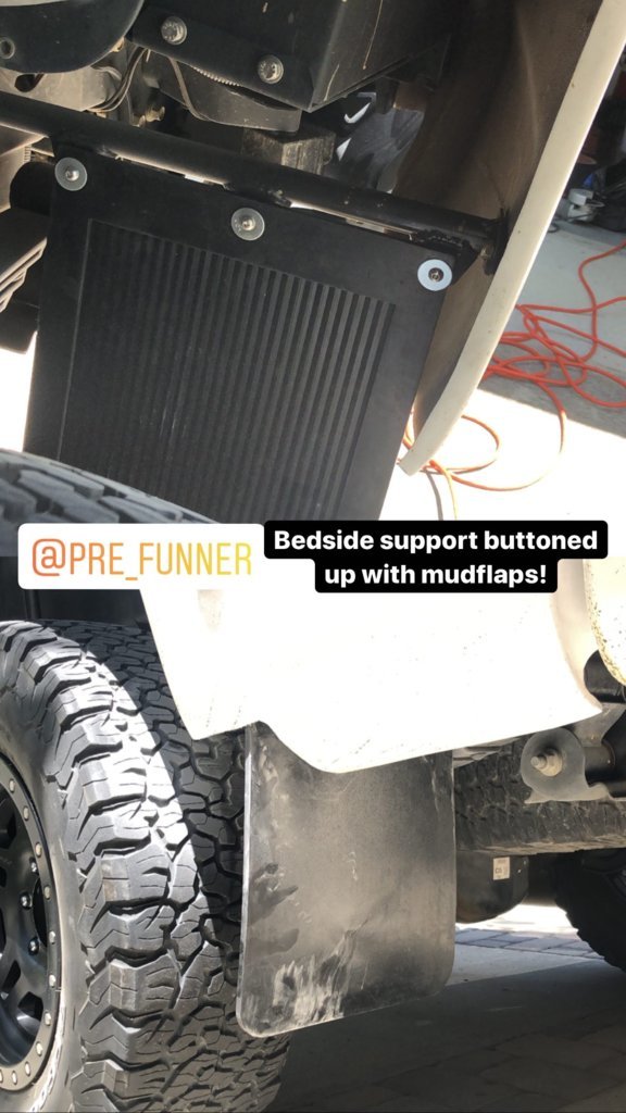

    How are you guys attaching your bedsides/fender supports? After a couple of you posted those hood pin posts I started watching my hood and fenders and they are flopping all over the place even just driving on smooth freeways. I’m sure the rears are just as bad.
    I saw this dude’s video and he’s using 1” DOM which seems a bit over kill and then I’ve seen a couple other videos of people hammering flat some conduit which looks easier but obviously isn’t as strong (and doesn’t look at good). Mine are just attached with some aluminum flat stock which I’m sure will eventually crack with enough time.

    I used 1” for mine, but I also hung some mudflaps off of it. Slightly oversized the hold in the bedside so any flex between the frame and bed wouldn’t crack the bedsides, at least not there lol.

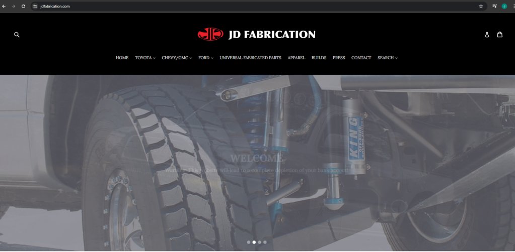

    Does anyone know if JD fabrication is still in business? Their website has been down for a few days.

    It looks open to me, are you using a VPN that might interfere?
