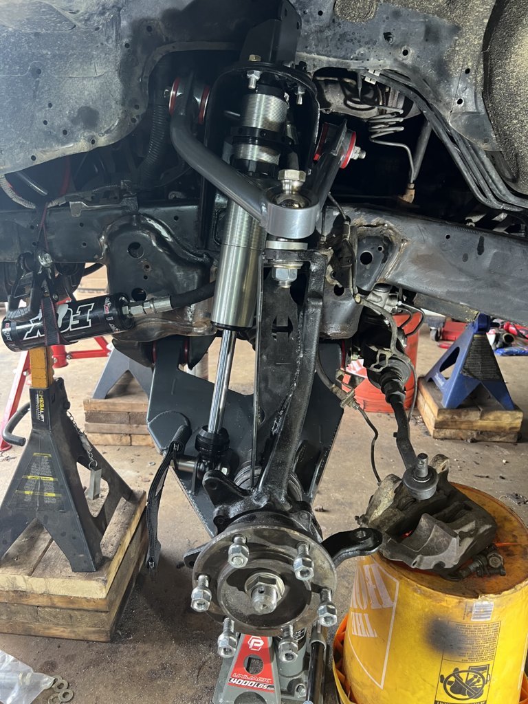

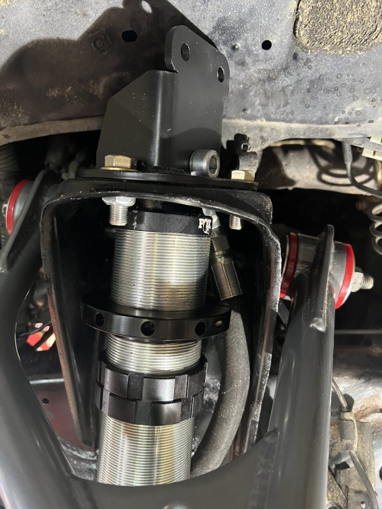

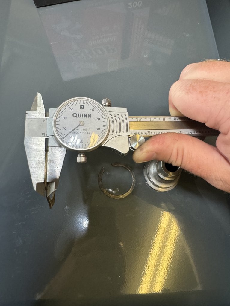

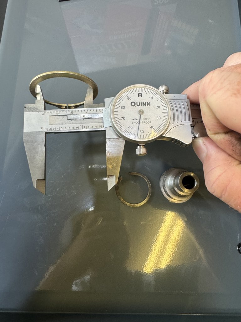

    Anyone know the upper ball joint snap ring size for 3G4R? I threw mine out…plus my calipers don’t fit when they’re already installed
    Side note: the 4Runners have a different top hat bolt rotation than the 1st gen tacos. Supposed to redrill I guess, but I was able to leave it rotated a bit and didn’t run out of misalignment. Couldn’t run a bypass off that mount now of course, but I don’t plan on it. I think I have thicker than normal fittings on my coilovers so I was surprised it all fit.

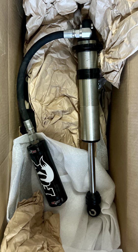

    That fox looks long, sure its for LT?

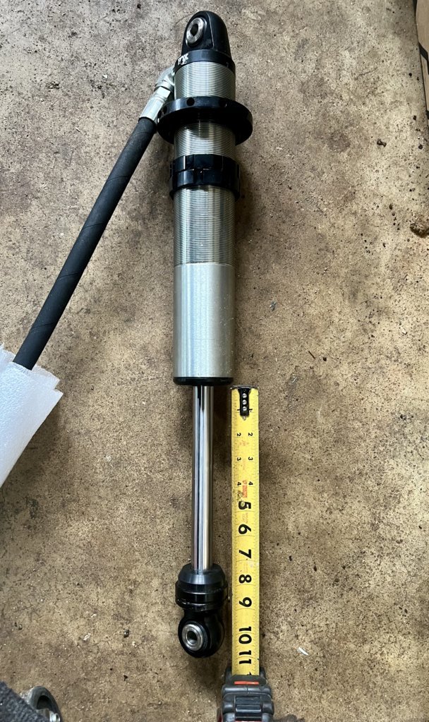

    Yeah, it’s an 8” shock. Surprised they bothered throwing dual rate rings and perches on it though lol

    Sure doesn’t look like an 8” body from here. Very weird.

    What is eye to eye length though? I get its 8” stroke but definitely doesn’t look like a normal 8” body. Especially with dual rate on it.

    Eye to eye is 24” I was surprised at the dual rate, too. Probably just a checklist at the Fox production line. Don’t think anything but maybe a tender coil would fit on that short of a stroke.

    Snap ring that holds the ubj into spindle?
    new camburg is .063x1.553
    Old oem is .070x1.614
    Actual Camburg uniball adapter is .105x1.067
    I have 5 spare oem ones that may be a bit stretched if you want me to ship a few of those, but the ones with holes for snap ring pliers are so much easier.
