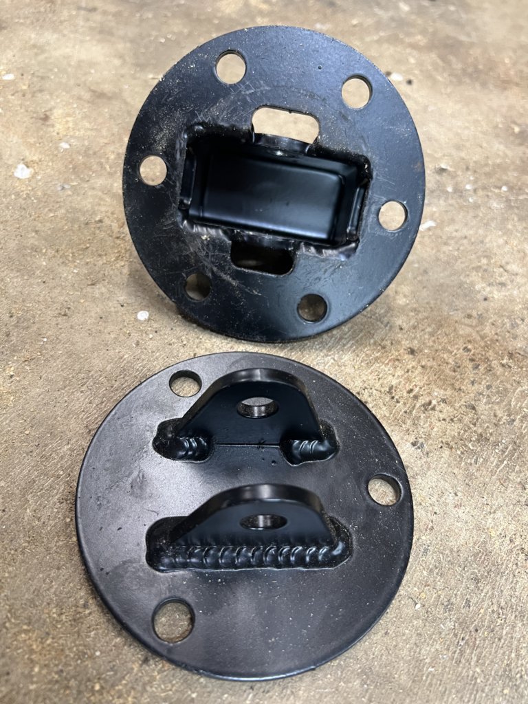

    Maybe I overlooked them in the box. I also realized I pressed the adapter in upside down, so I gotta fix that :facepalm:
    Thanks for those measurements and the offer. I’ll run to Ace and grab some if need be once I get measurements with them off since there are some differences.

    Theres an 8” and theres a short body 8”
    I had an 8” and they didnt fit that well

    Bet theres a 1” spacer inside making them 9”

    Interesting. There were two mounts included in the JD kit. One for the taller 24” coilovers which I used.

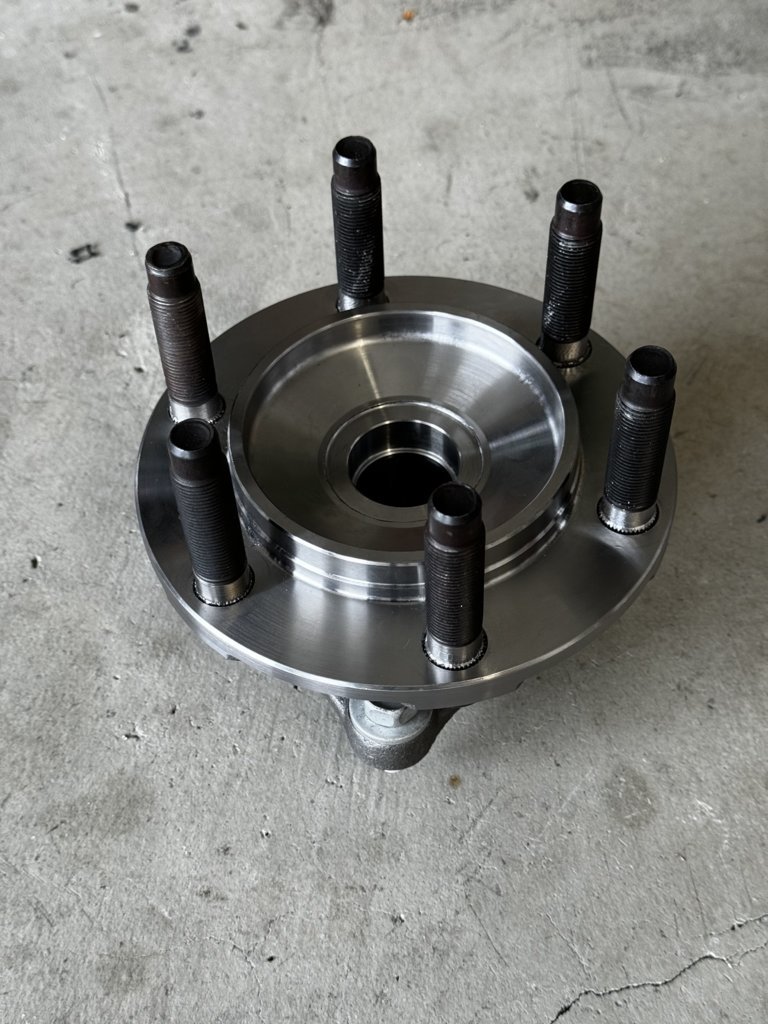

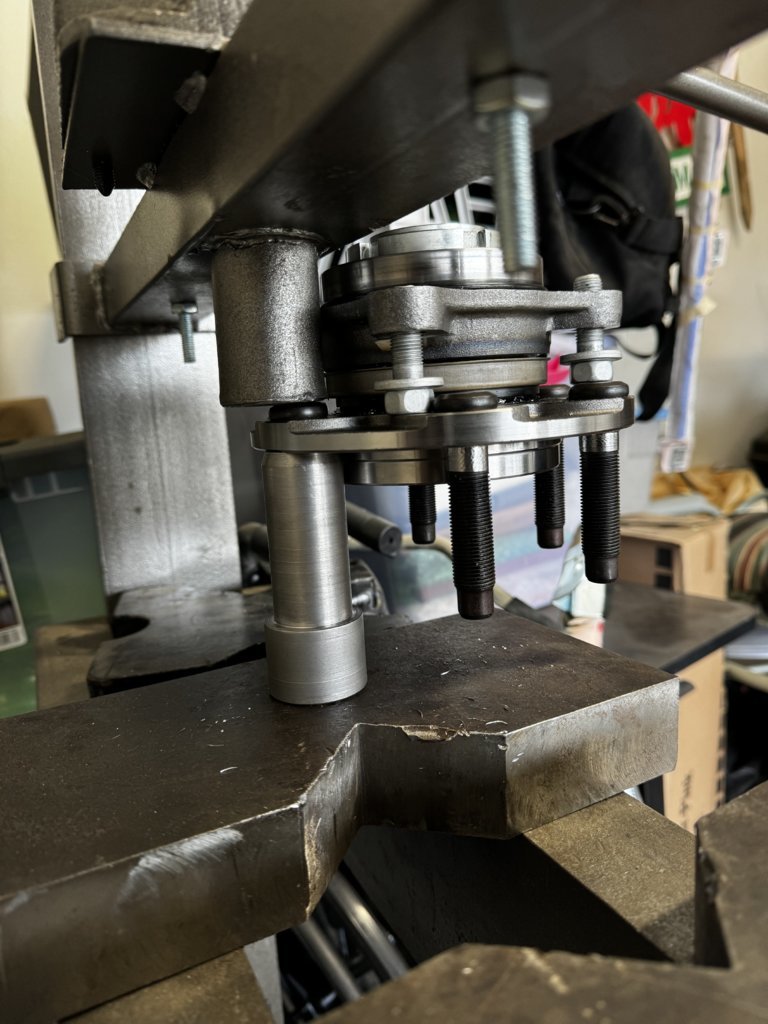

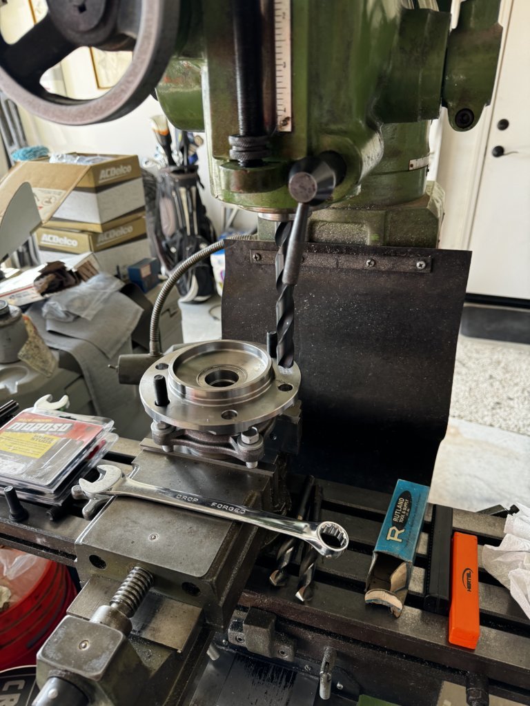

    Bought some AC Delco Gold Hubs from Rock auto for the new LSK kit. But since I run 5/8 lugs. Gotta drill them out and press in the new lugs. The new to me mill made this so much easier than the drill press I used last time.
    Made the press tool on my lathe
    ready to roll!
    I machined down some of the Knurl on the lugs so they don’t interfere with the brake disc hub and the wheel.
