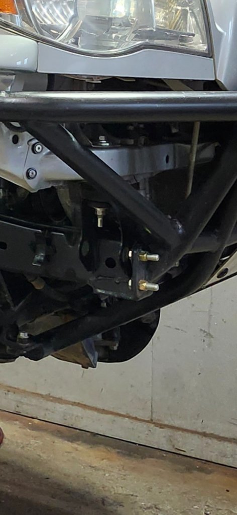

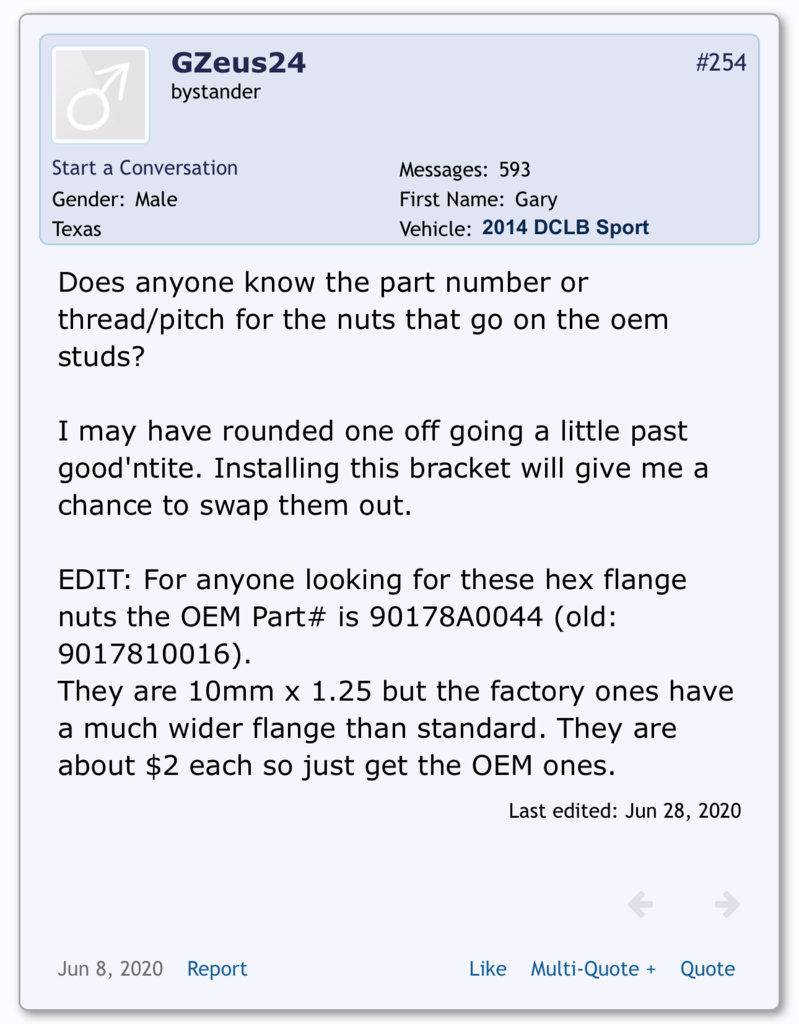

    Anyone know the thread pitch for the front bumper studs? Lost all the nuts lol

    https://www.tacomaworld.com/threads/airdogs-2012-prerunner-access-cab-slow-build.264263/
    Found this. They are listed as a Flange nut.

    Do yourself a favor and replace them with bigger bolts. They are tack welded on so you have to use a chisel. Looks cleaner and those studs are exposed and get mangled so easy.

    Did you just use like an air hammer to get them out?

    You could but be careful because the metal is super thin and will bend. I used a sharp chisel and broke a tack off and hammered on them a little.
