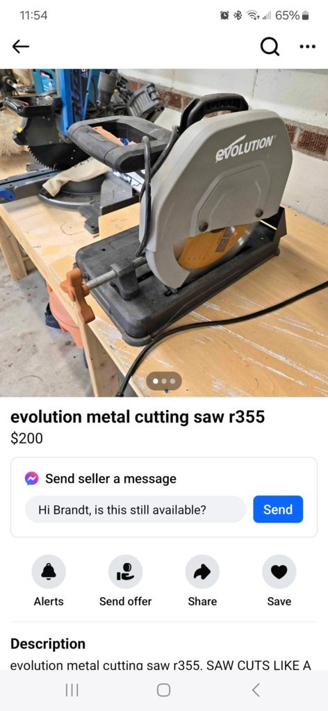

    So I'm looking for a cheap band saw on marketplace but I have a chop saw that I've used for cutting metal from time to time, but the blade I have is a little sketchy and I'm scared it's going to explode everything I use it. It's just a giant cut off wheel.
    What's a good blade to use for cutting tube? I don't mind spending 50$ for a good blade that keeps me safe. It's a 10" chop saw.
  2. Sep 18, 2024 at 8:19 AM
    906taco
    906taco Well-Known Member
    Jun 22, 2021
    #369289
    3,903
    Cory
    08 Taco
    Buy a cold cut and be done. I’m a big fan of my evolutions. Blades are pricy but you will get 1,000+ cuts out of them

    I'll spend 100$ to not have a grinding wheel explode in my face

    Couple of used evo saws for 200$ near me...

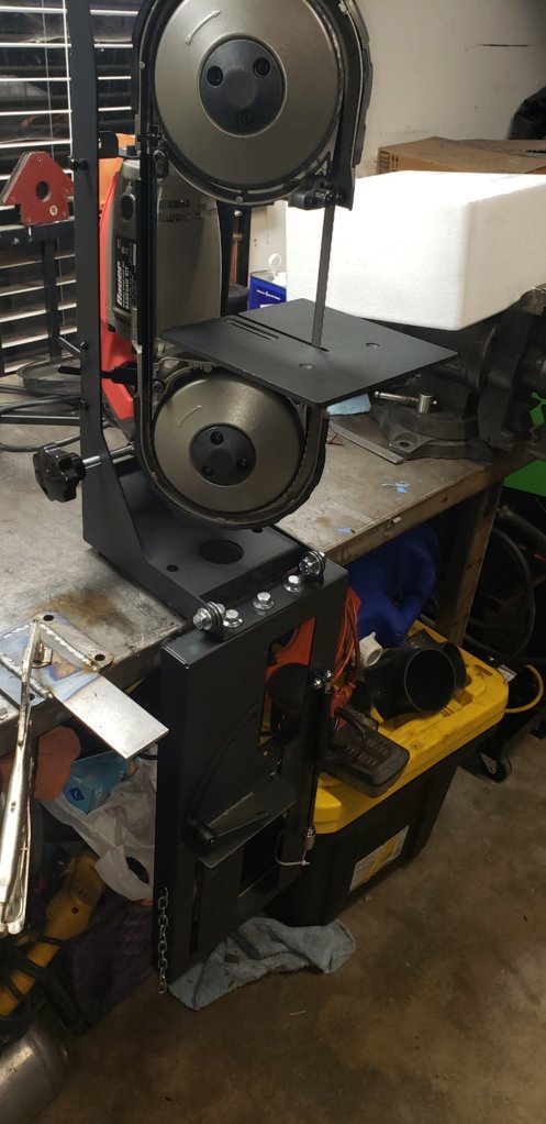

    I have a 7x12" band saw that has coolant etc. its great if I'm cutting big material or have lots to do while it's cutting, or if Im doing a bunch of the same and can bundle some material together, but it's slow for things like building my cage etc, and messy with the coolant. I don't have a circular cold saw, but I would probably use it more for one off cuts of tube etc.
    For building my cage, I end up using my Milwaukee portable band saw a lot because it's super fast and convenient. It's not accurate at all, but I'm notching pretty much all the tubes anyway so I don't need a perfectly straight cut.

    Try 10-14 M42 blades for the band saw and ditch the coolant. Thank me later.

    Damn you. I just ordered the 355 on Amazon.

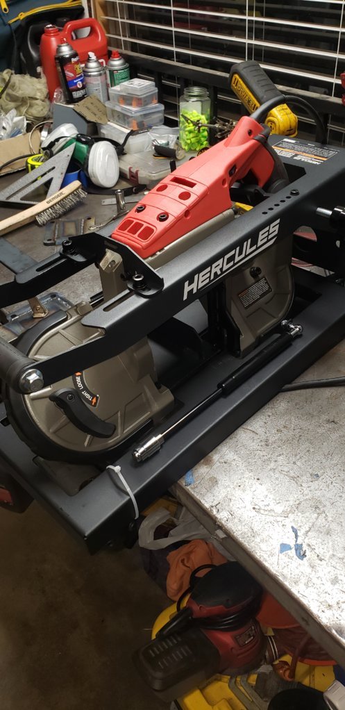

    This is best thing I've bought from Harbor Frieght, it cuts everything like butter and makes way less mess than a chop saw.
    Portable Band Saw and the Band Saw Stand.. there are plenty of YouTube videos about this combo, should check em out..
