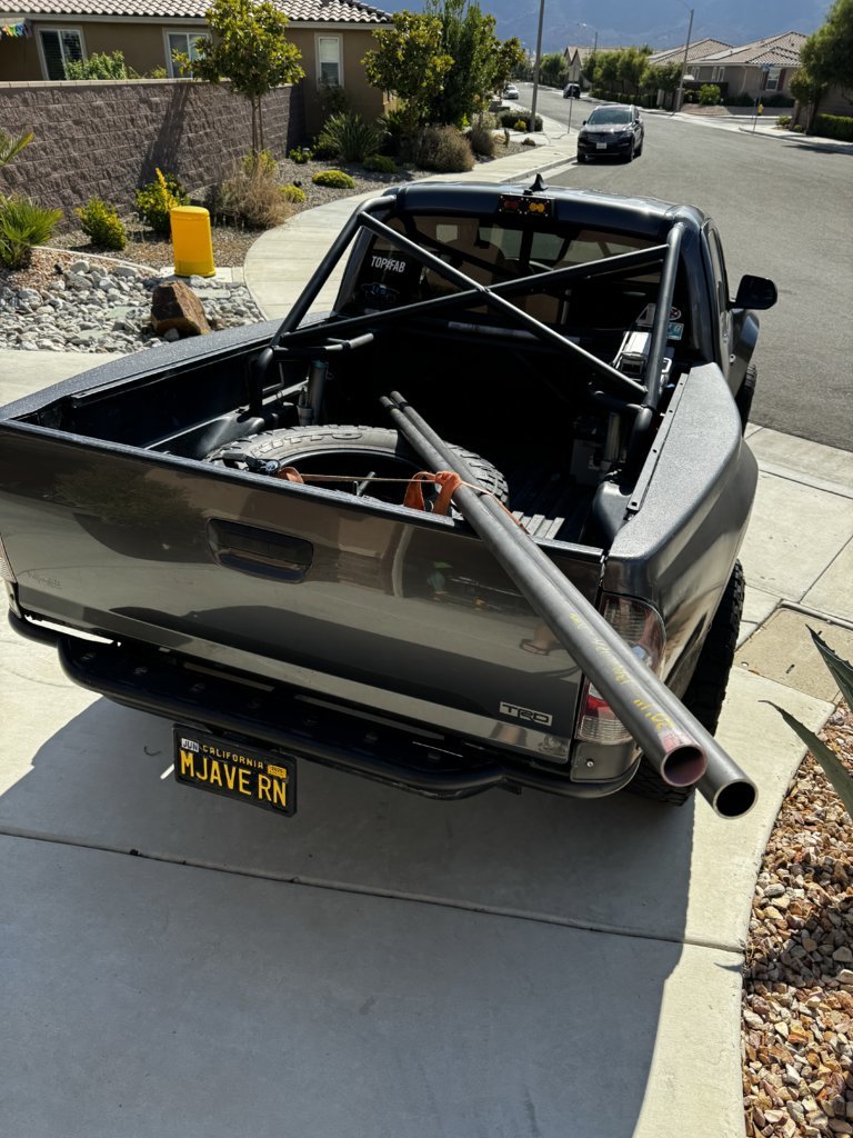

    I paid $93 yesterday for 20ft 1.75 .120wall DOM tube.

    Ive never paid less than $8/ft for the same material
