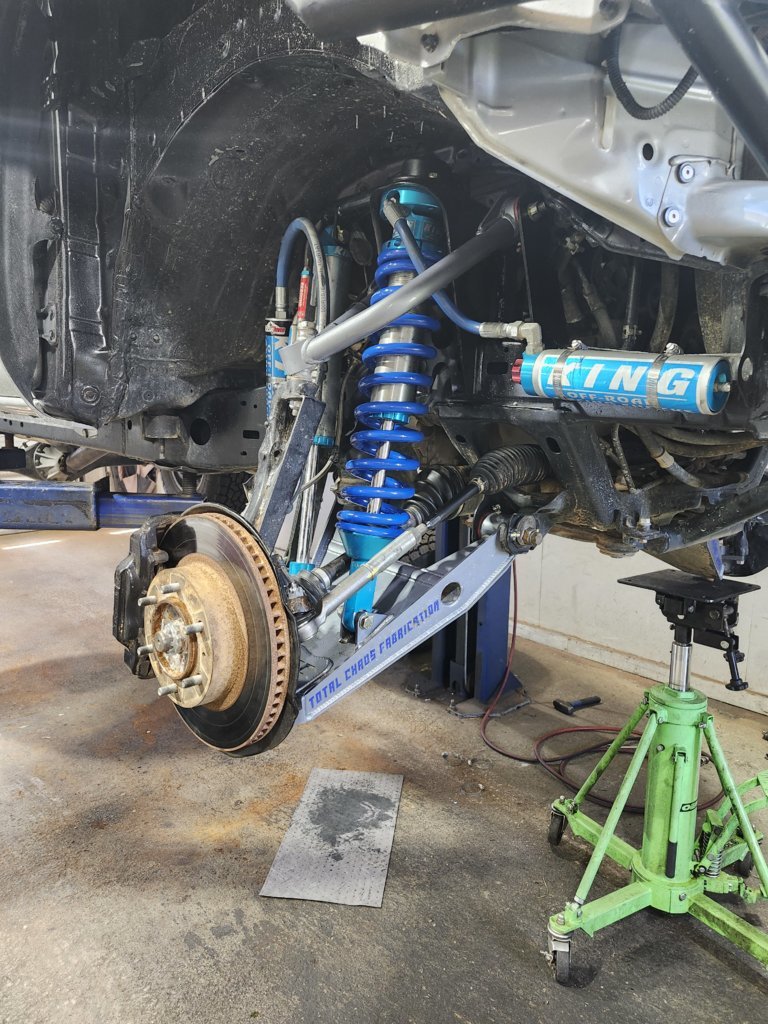

    So I now have 5.5 inches of shock/bypass shaft showing with these 18x500s. That puts me in the lower half of usable down travel. I haven't taken the truck to the beach (whoops/jumps). Is this going to be an issue for usable wheel travel?
