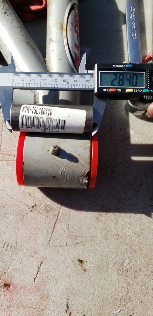

    Or you can do this

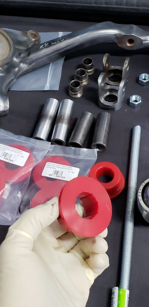

    For articulation purposes, you’ll want to keep poly bushings somewhere in the system. I run Delrin for the upper shackle pivot but poly on the leafs themselves.

    Shockingly enough. I wouldn’t be the first to run delrin for leaf eye bushings. Actually quite a bit out there with positive feedback on how it tightens the feel of the rear end up. Leafs are meant to twist.

    Definitely will tighten the feel up. Originally my design used poly bushings at both ends of the shackle and truck was almost undriveable with how much the axle wallowed around. Talked to some buddies that suggested Delrin for the frame side of the shackle. But with the leaf eye bushings you’ll drastically accelerate the wear and increase chances of breaking the main leaf. I was advised against it when building my rear.

    Ok, so Derlin is the way to go then.

    Same thing I’ve been buying that has been failing
