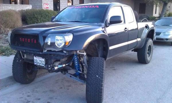

    i like that grill with the red emblem

    not for long :cool: JK
