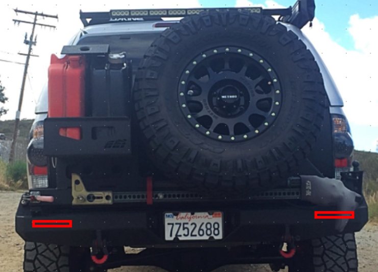

    Funny you guys mention this topic, I am sick of breaking taillights too so I am planning to remove mine too. I made molds off of the OE tails and then I will use those to infill / shave my bedsides to eliminate them. I bought a BD RTL w/ turns & backup and that is going on the back of my caper shell roof rack as a chase light primarily and then I was going to use two of the 6" RTL-M's in my rear bumper to satisfy the two separate lights requirement. I use my truck a lot for " overlanding" so I want to keep my bed as open as possible so my spare, jack and cans are going to stay out the back bumper. Those little 6" RTL-M's can be mounted horizontally on the bumper which will have clear view below all of that sh*t. I'm building a new bumper that will be all tube, a little lighter and less bulky.
    Like this, death lift jack is gone now so it will not interfere with that right tail :

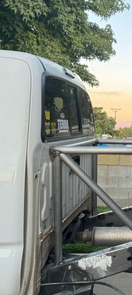

    Any tips?
    PSA this isn't my truck.
    When you guys build bed cages, how far away should I build it from the cab? This one seems super close. My frame is boxed, but I'm worried about the flex, I really rather not have a massive dent from the bed cage in the back of my cab lol

    lol that cage will hit the cab backing out of his driveway

    I literally just did a spit take because it's true.

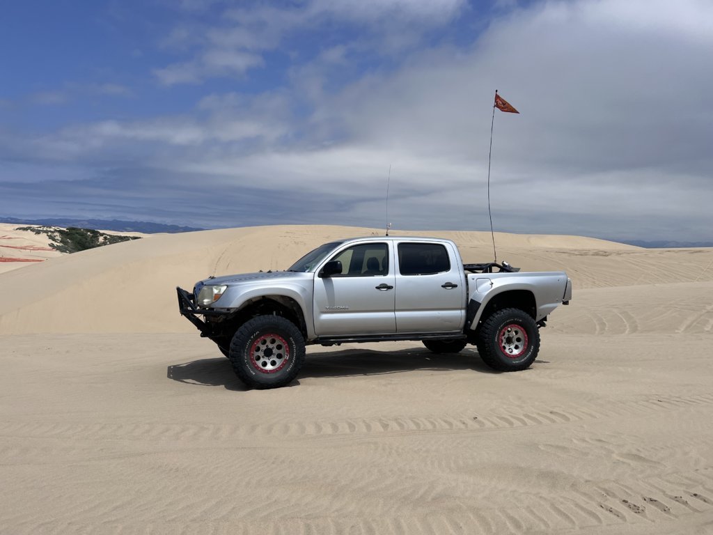

    My bedsides are just over 2" from the cab and they hit the cab, granted during extreme usage. (best side picture I could find)

    Yikes!! Some people just need to put down the power tools.
    If you’re only gonna do a bed cage, might as well make it a bolt in cage.
