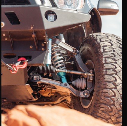

    I think it could be a really good kit, moving the rack and diff gives it more potential than other kits on the market to me.
    all comes down to how well did they design the geometry, looks like they cut out a lot of antidive.
    and for a big change like this it seems like the fabrication could be decently foolproof.
    interested to see it hit consumers hands and get actual numbers, hopefully we don’t have to wait 3 years like rclt

    To me it seems the geometry on the new AP kit looks quite a bit different, plus they have the whole replacement subframe/cradle/UCA/coilover tower replacement unit which is going to be a big difference. And along with that likely moving the diff a bit for CV angles I'd assume and stronger mounting for the LC steering rack. And to top it off, dual shock ready. So I'd also assume their design intent was not strictly rock crawling as the optimization, rather a more rounded kit that can also go fast.
    Waiting to see more info released though but those are my observations

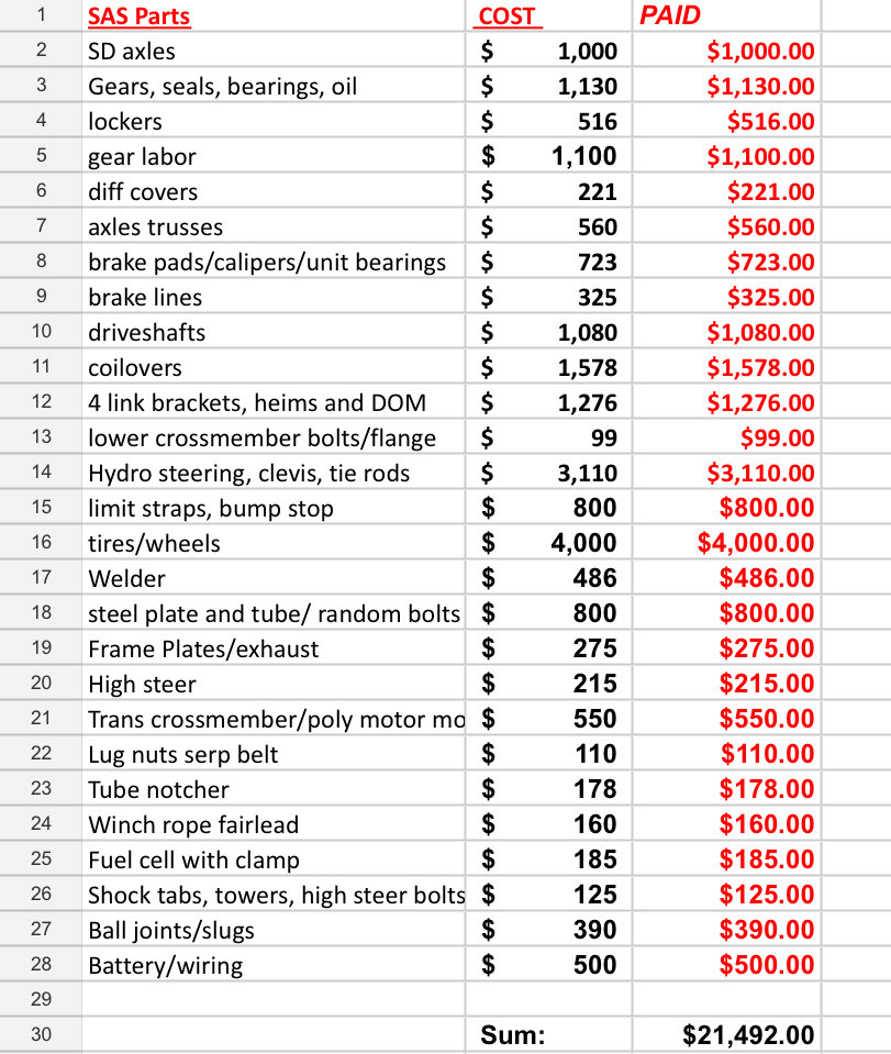

    It may look tempting. However. The cost of building a really nice one ton axle is actually astronomical. 10-15k for front and 8 or so for rear. Then you still have steering, shocks, driveshafts, a t-case that can withstand tons etc. you’re talking a 100k build for a solid turn key SAS on tons.

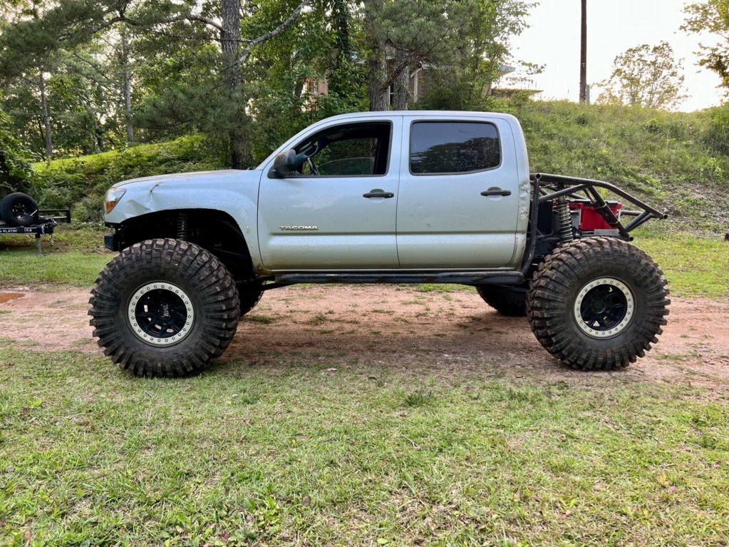

    05 super duties, trussed, 42’s, full hydro, four link front and rear, DOM driveshafts etc. this is what I was in parts. Add another $2k for random stuff I left off. Steel, tube, bolts etc. Could be done for less and definitely less work and a mind fuck if three linking the front. Really don’t think trusses are necessary for these trucks. They aren’t power plants. Pre 05 super duties would be a bit lighter too. The sky is the limit with axle builds, you can over spend super quick. Best to break it and upgrade it if need be.
