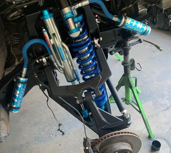

    The taller spacing is an OEM trick to get more leverage on the spindle. Think like holding a broom up at the end with your hands together vs farther apart. It allows them to engineer in more stability without as much material added as there would be if they just made everything thicker to get more stability. Not exactly sure what handling characteristics the aftermarket kits are chasing besides slightly more travel and space on the frame side from having the control arms swing in a more similar arch to each other, but i guess it's mostly that since they can with beefier parts. Less camber change if the spindle side is kept far apart but frame side is closer, maybe that too but that would add bump steer so i'm not quite sure that's why either

    What I’m most impressed about is the 30” limit strap. What, about 3” of stretch from that baby?

    Glad I’m not the only one that saw that haha doesn’t look adjustable either, unless I’m missing something

    What about that Bluetooth tie rod? Why don’t they want to show that?
    Guys are gonna cut their whole ass front end off and be like “why can’t I drive this down the highway?”

    Plus you’re stuck with it after cutting all that off. Nothing else bolting up to that.

    Also, why the hell did they build that with a top hat upper mount? As mentioned, nothing else is going to work here after the install.

    That’s what happens when you pay an “engineer” that knows nothing and makes 20$ an hour to “move everything forward 2 inches”. All signs indicate colossal mess.
