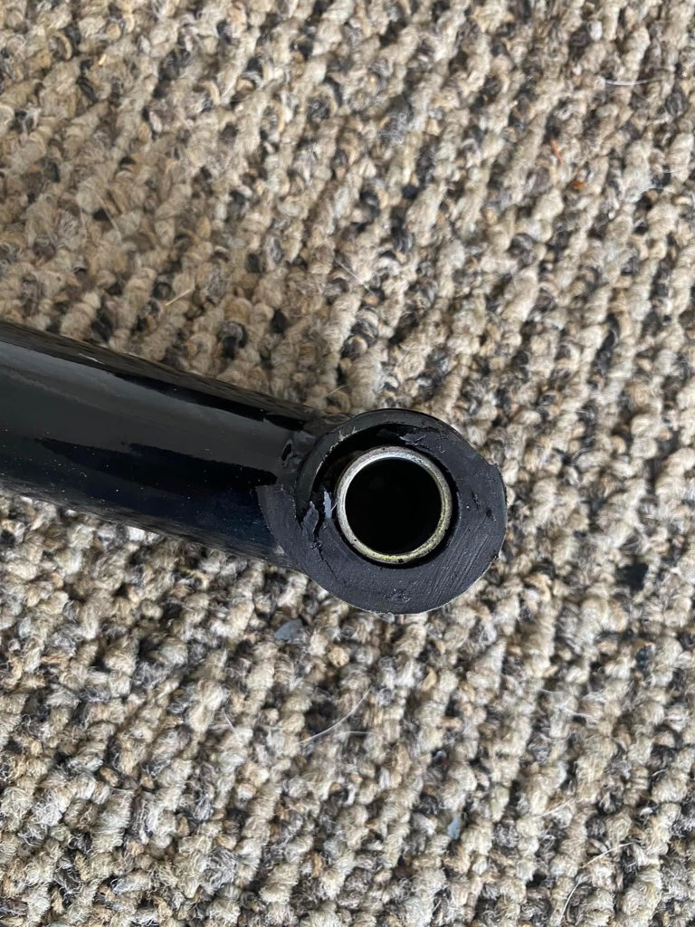

    It took a while to get my Solo LCA's to a point where they didn't eat bushings, but I was previously considering doing delrin. Not sure if the Solo bushings are poly or what grade, but they're pretty damn stiff. Noticeably more stiff than any of the TC poly bushings I have for my steering or UCAs.
    It also took a while to find what was the best grease to use to where they didn't start squeaking after 5k miles. Couldn't get anything to work other than the expensive prothane grease.

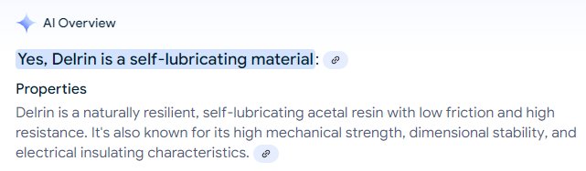

    Understand that delrin is self-lubricating, but is it self lubricating enough to where you can just use them completely dry in the lower pivots?

    Yes
    yes, a lot of lubes will actually degrade delrin, i believe teflon spray is the only safe thing

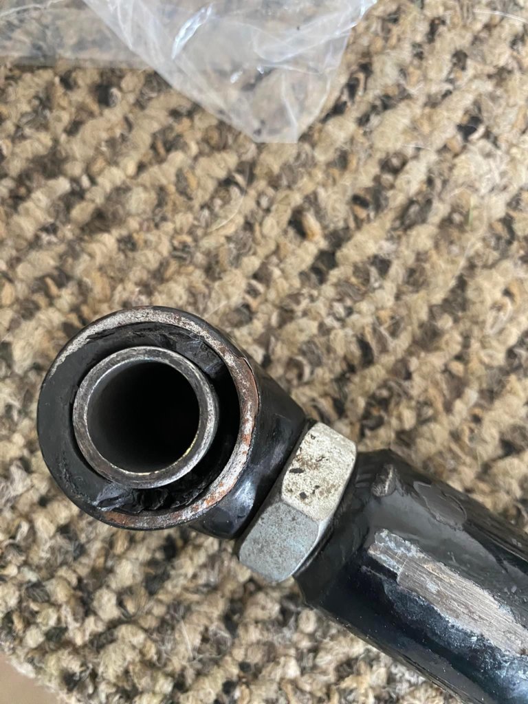

    Link arms I built for a car a couple of years ago. He insisted on wanting bushings and not heims. So I gave him what he wanted. 5k miles later I built him heim arms and haven’t heard anything since aside from “I can hear my diff by my left ear now”.
    If you use your truck. Delrin or uniballs are the only option. Run from anything that comes standard with poly for front end parts.

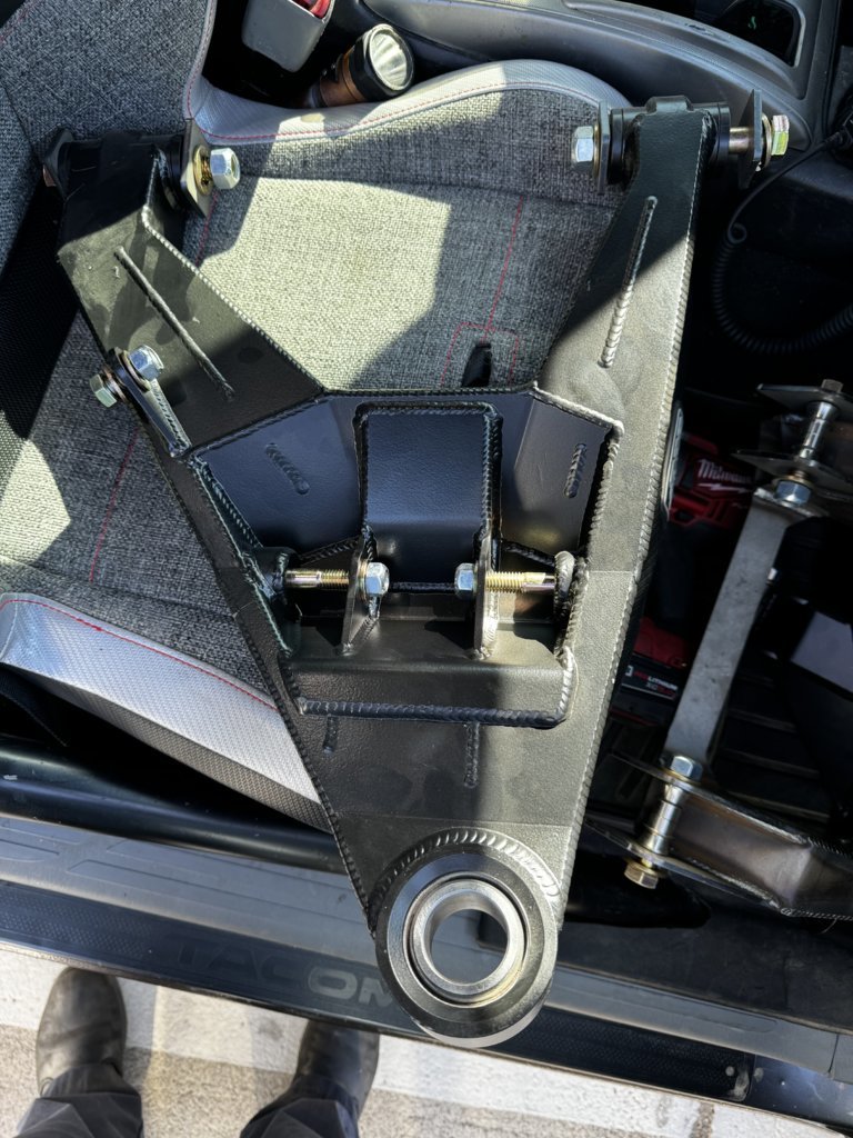

    For those of you with all uniball suspension, how often do you change joints? And what do you do to care for them between if anything?
    I'm ~18 months in no more than 7k miles and they squeak sometimes but idk if there is any specific time I should just swap them. No salted roads etc. but they see a lot of mud, granted I try to wash them out pretty consistently and use tri flow or a ptfe spray
    Uniballs on LCA pivots and ubj then heims on UCA pivots and inner tie rod.

    I'm 3 years into the all uniball JDfab setup. I changed the outer upper and lower uniballs about 6-8 months ago from the original EMF balljoints but I greased them and adjusted them as needed over the time I had them. They had some pretty good wear but still servicable. I have yet to touch the uniballs at the inner pivot points. I'll be pulling that suspension off next week and will be able to get a good idea of how they have handled 3 years of absolute abuse. Ive done nothing to maintain them other than to hose it off after desert trips. My truck makes too much noise for me to even worry about squeaky uniballs...never notice it to be honest. I'll give an update next wednesday on how the inners look and feel after then are removed.

    For my Camberg kit, it was mostly out of ignorance, but also partly due to me not feeling any slop in them either, but I ran all of my original uniballs for about 55,000 miles…
    The outers had noticeable play by the end, I could feel it when the wheel was off, and you pulled up on the Wheel hub or spindle.
    When I took them out, a few Of the lower control arm Pivot Had sized in the cup. Took a lot of force to get them out.
    My truck saw About 10 desert trips each year with most of the miles being daily driving.
    I also would scrub with a toothbrush and power wash out the bearings about every month and lube them with tri flow.
    Probably wouldn’t do that again though. I would inspect them for play every 5k to 10,000 miles. Pretty much average oil change.
    When I put all new bearings in about a year and a half ago, I have since driven about 15,000 miles But decided to not touch them with any lube. So far, mine have not made a squeak. I think I may have been putting too much lube Previously, because I would often see it pooling up around the perimeter of the sphere And end up mixing in with dust and dirt
    Not sure if any of that is proper, but that is what I’ve been doing.
