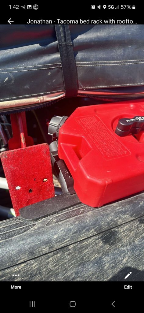

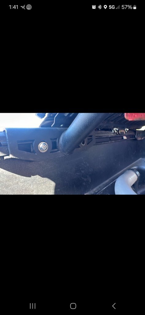

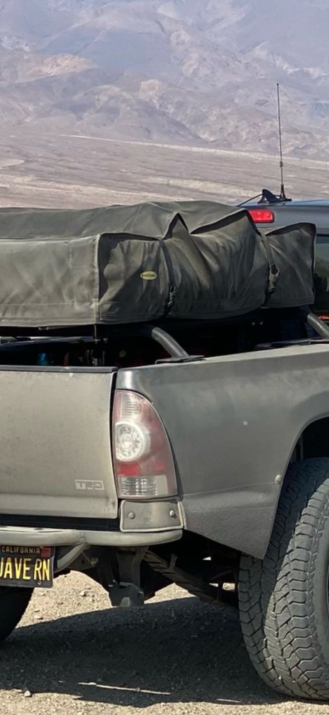

    So that's my main question is are the slotted rails enough support for that setup? I mean worst case if could run a leg down to the floor

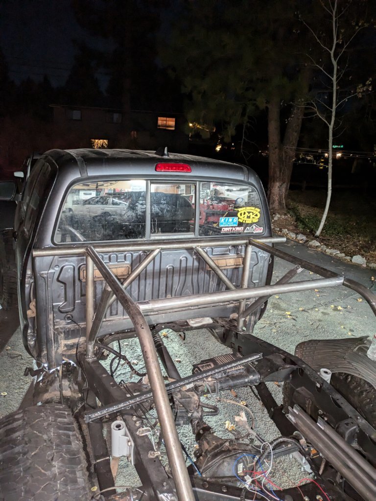

    See above ^
    I'm not really sure what you are accomplishing with that bed cage. It adds almost no strength without actually connecting nodes.

    Mine have for a ton of trips. But I think the fact that mine sits real low helps out too.

    I def want the tent to be flush with cab, as in as lowered as posisble

    What rack is that. Can't stand the look of stamped steel with bunch of cheese graters on the side. Want some low profile tubes

    They are relentless fab low profile bed bars that I added 2 other tubes to make it one piece. Just looked at their website and don’t see them anymore. I had to slot the holes in them when I went fiberglass bedsides.

    How are you planning on incorporating the RTT now that you have all that steel in the bed taking up space?

    I'm not....pretty much done RTT camping with this truck. I'm old and primitive camping is just not fun anymore...its all hotels or RV's from here on out. So if anyone is interested in the RTT speak up...you just may get a deal

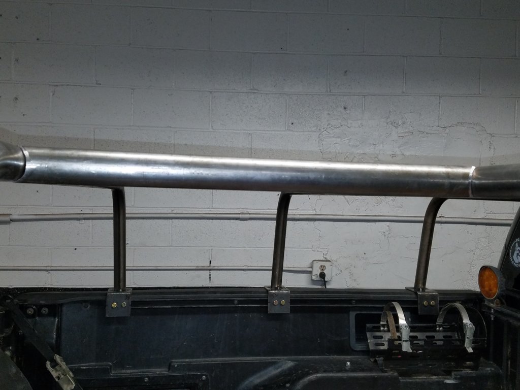

    Back in 2017 @whatthepho(may he Rest In Peace) and a few other buddies got together one night and made my RTT bedcage. All together under 100 bucks in materials. A simple design and has held up just fine over the years. Its not perfect but ill never get rid of it.
    Andre (@whatthepho) bending some tube..
    The feet rests on top of the bed rail, but bolts into the side rail thing with nuts welded to some washers and slid through the back side slots

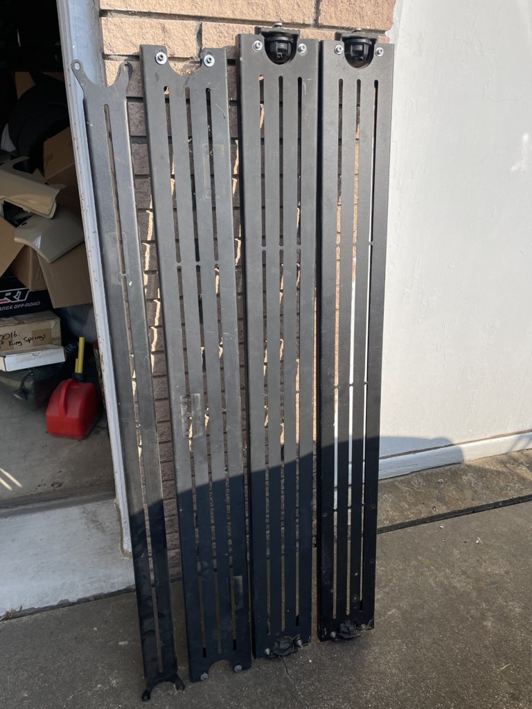

    I have several of the older KB Voodoo bed bars that mount to the factory rail tiedowns.
    These, plus the later ones that were stronger and reinforced.
    https://www.tacomaworld.com/threads/kb-voodoo-bed-crossbars-ready-to-ship.393527/
