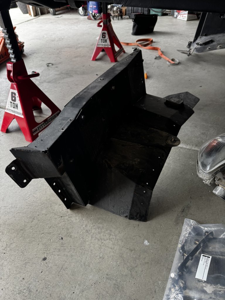

    Have you always had no inner fender? I want to see how you mounted your intake and fuse box.
  2. Oct 16, 2024 at 11:25 AM
    SoCaltaco65
    SoCaltaco65 Well-Known Member
    May 10, 2011
    #56389
    7,656
    2011 DCSB 4x4 Offroad TRD
    JD Fab inners
    SoonToBeOn39s likes this.
