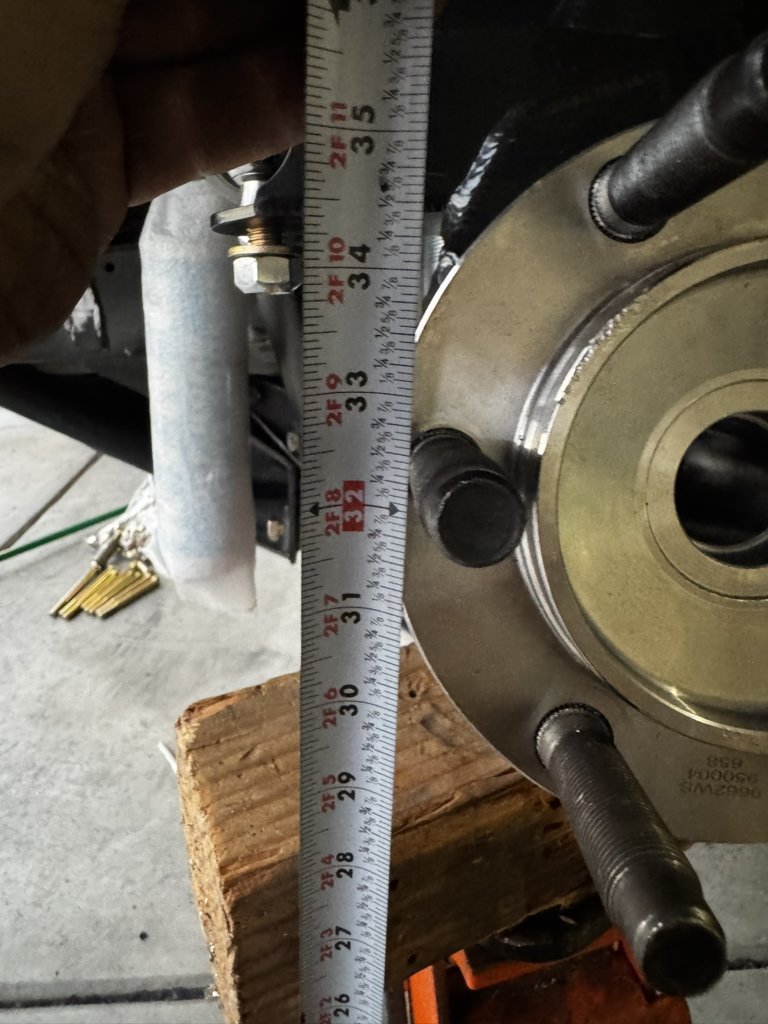

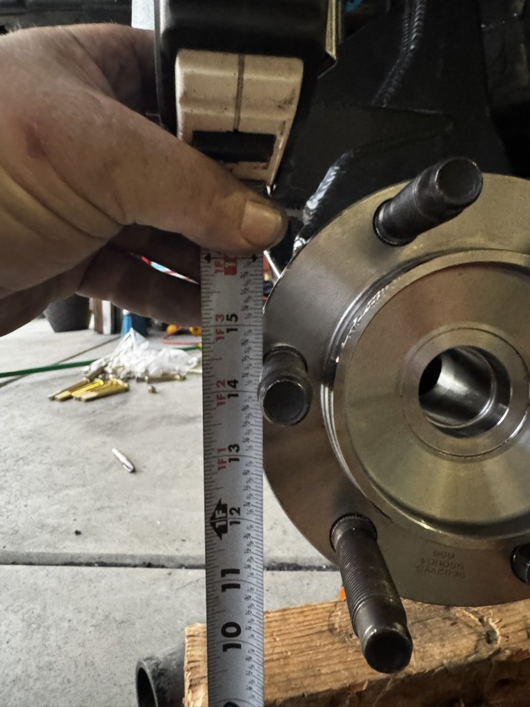

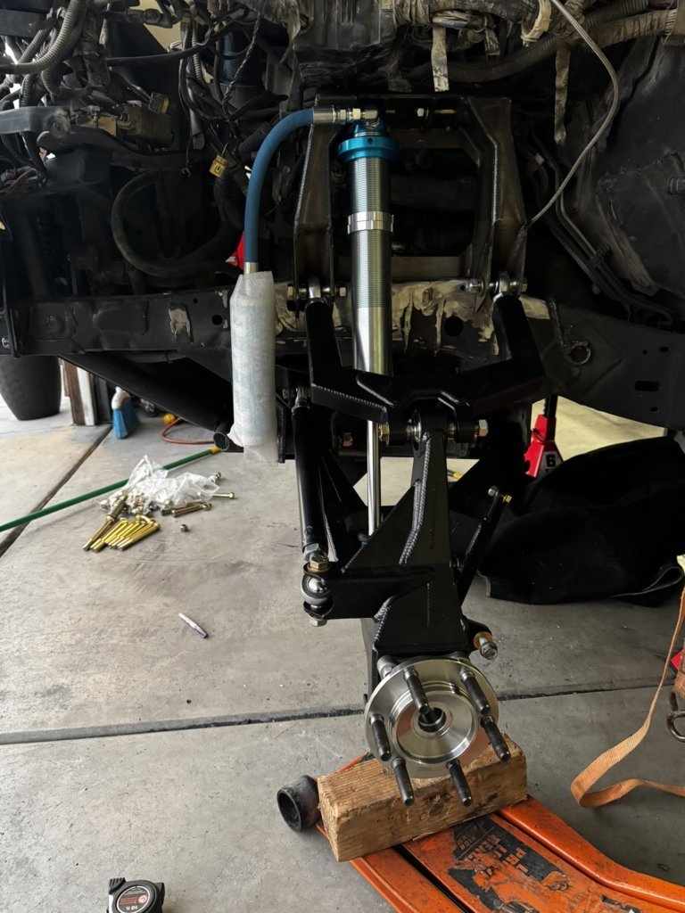

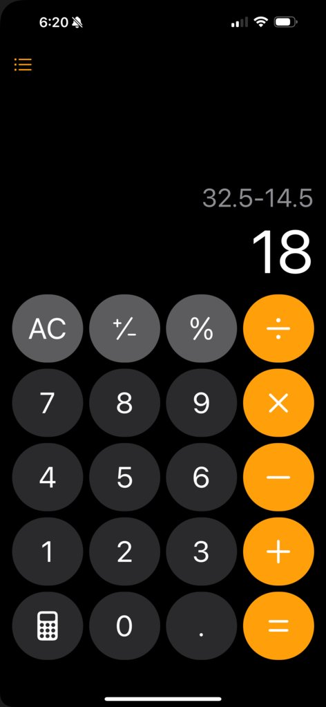

    This was kind of unexpected numbers......

    I think you knew what you were getting into with this. Lol. Why did you go LSK over Solo kit? Quality is much better? Recently I've been seeing solo kits more frequently.

    Literally I went for LSK because they keep the ABS sensor so I dont have to figure out another way to keep my speedo working. I lost it once because of the full float axle....figured out a fix and I dont want to have to do that again. I wasnt expecting to see 18 with the coil over in....LSK's page says their kit averages 16, so 18 was a surprise so even bumped and strapped conservatively I still can get 17. Plus this kit was 20% off when I bought it so that is what made me puirchase it now.

    how close is the uca to the coilover at droop? Few times I almost forgot about spring clearance and had to go back and relook… and the joys to be 2wd…lol

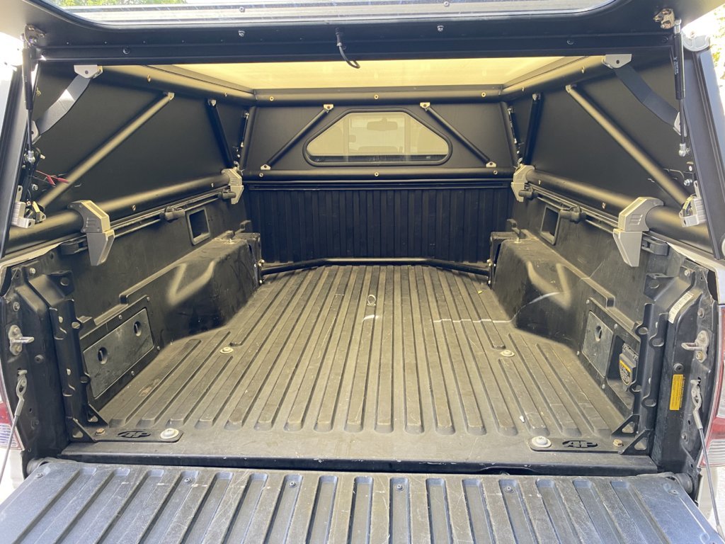

    Threw a GFC truck cap on it today. Gonna keep it light and strong. Needs some adjustments with the fiberglass and reinforcement for dirt. But I am pleased to be able to lock up the bed again. This is where the JD spring under setup shines. Tons of space for activities. Cap should do well at speed.
