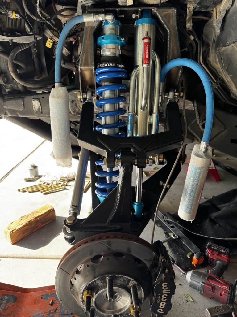

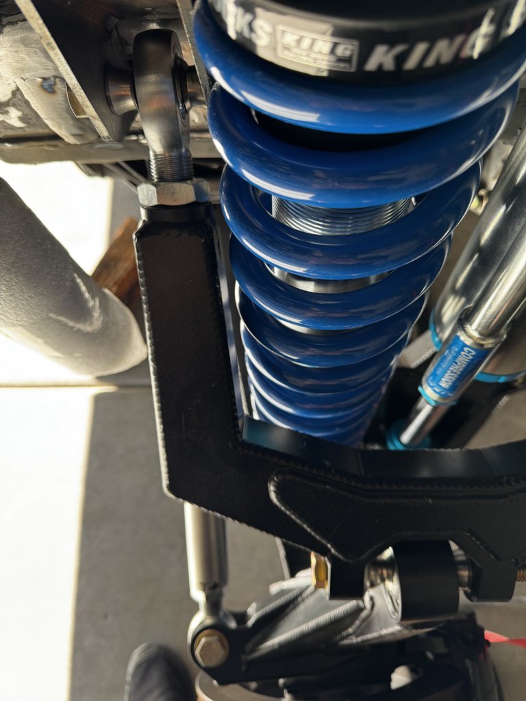

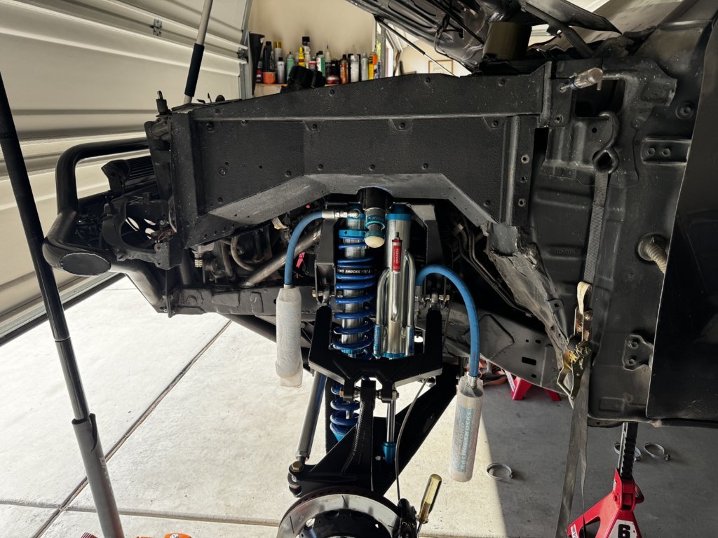

    About finger width. And I’ll bring it up another 1/2 inch strapped. So it’s not even an issue. Funny that you ask that considering that is what I was just doing….checking clearances.

    Is that now 1” heim outers for the steering?

    7/8 for steering and UCA. 1 inch uniballs in the upper spindle and 1.5 inch uniball in the LCA

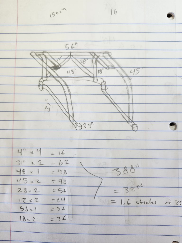

    Anyone see any issues with this bedcage design? 1.75 .120 dom

    10/10 wouldn’t go smoothies for leaf springs. Just my .02.

    Educate me please as to why

    They don’t flow well enough. Not saying you can’t make smoothies work. But it will never be close to a bypass.

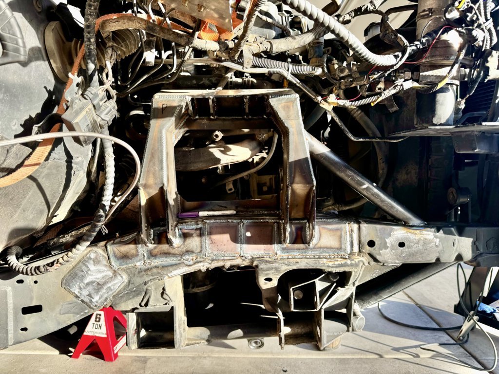

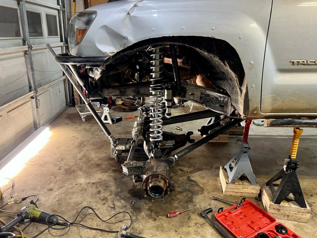

    May not be perty but she’s all plated and welded in. The frame in this section just sucks balls. It’s not flat, the upper half sits at a higher level than the bottom half. Taking the coil bucket out exposes a big dip in the frame….prolly 3/16 deep and 4 inches wide. Just beat the shit out of the steel to make it somewhat form to the frame. I’m going with it’s better than nothing.

    Did you look at any of those pre made frame plates? I think mine came from trail gear or something. Might have made it a hair easier to have a flat starting point to work from.
    @Airdog here they are-
