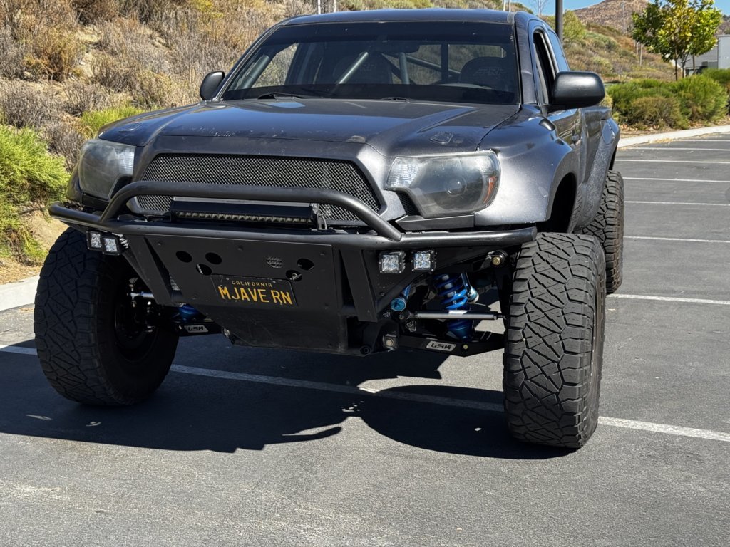

    Welp she’s back on the streets. So far feels good. Even my alignment has the steering wheel straight and no pull.
