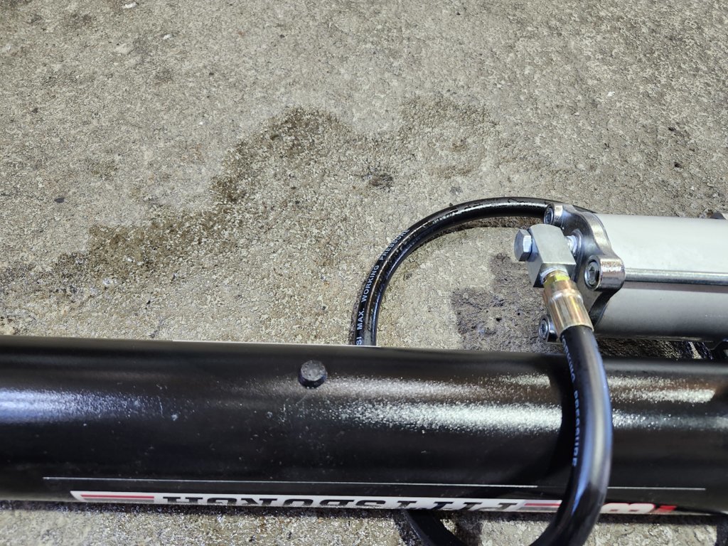

    So I'm having trouble getting this harbor freight ram to work on its side. Works great vertical, but when in the bender only comes out about 12 inches before it stops.
    Should I lay it on its side and completely fill the fill port? It's full of oil when stood up.

    Lay on its side and fill up. Had the same issue and now it works good besides the small leak

    Exactly what I was thinking but was scared it would explode

    You’re good. Just keep adding until it extends fully and call it good. You will have a mess if you add too much.

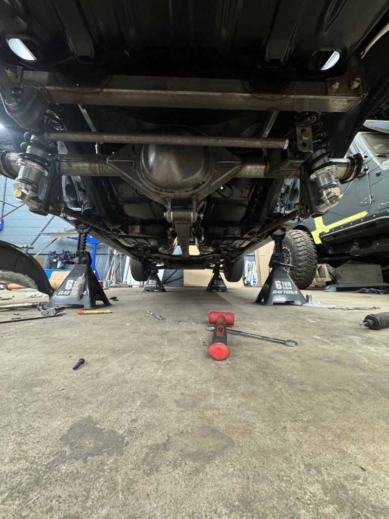

    A bit steep on the 100k to support. It’s actually more in the realm of 20. Especially if 4wd is dumped.
    Which is like 75% of the reason I want to build this bulkhead off of the truck. Because I know it’s going to be expensive and I want to enjoy my shit while I prep for the swap.
    Anecdotally, the more stupid I get with the truck. The more I see really cool shit roll through my doors for work. Like this one I just wrapped up and sent out.
