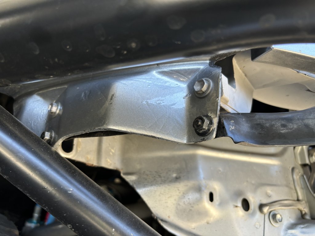

    When fitting fiberglass are you guys reusing the black bolts that are pressed into the core support? Bottom 2 bolts in picture.
    im thinking its gotta be easier to cut and drill them out so i can adjust up or down without kinda blindly drilling approximately where it is because of the bolts standoff IMG_3183.jpg

    That’s a secondary piece all together. Fit the glass and move the part to line up for the hole then drill.

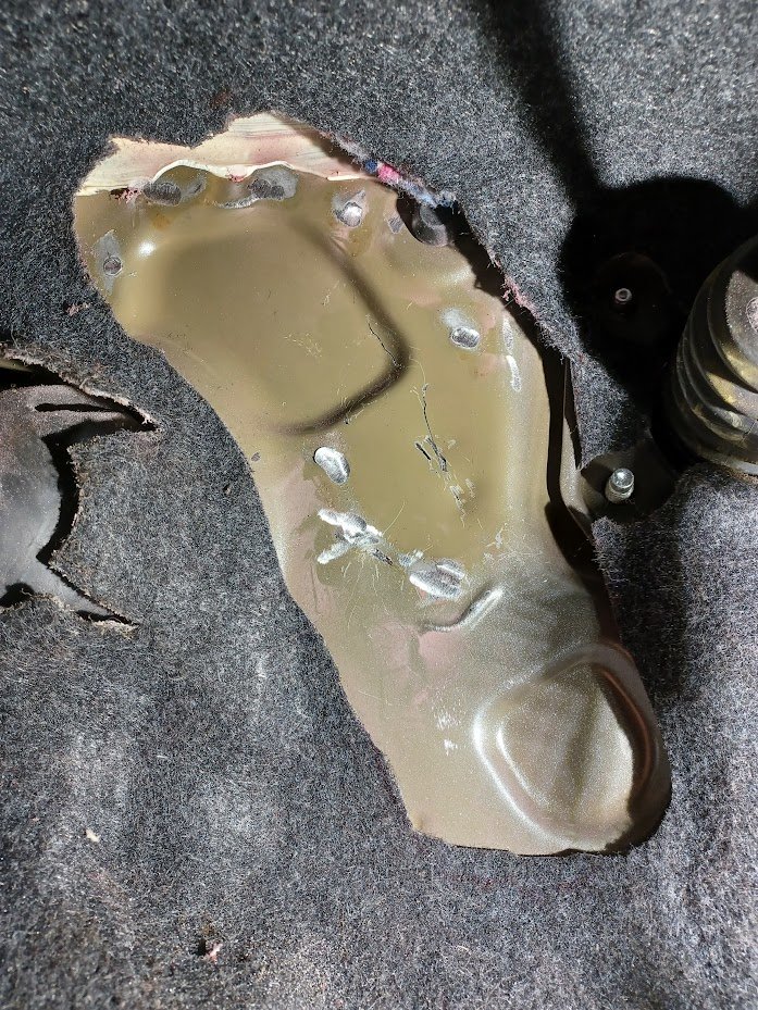

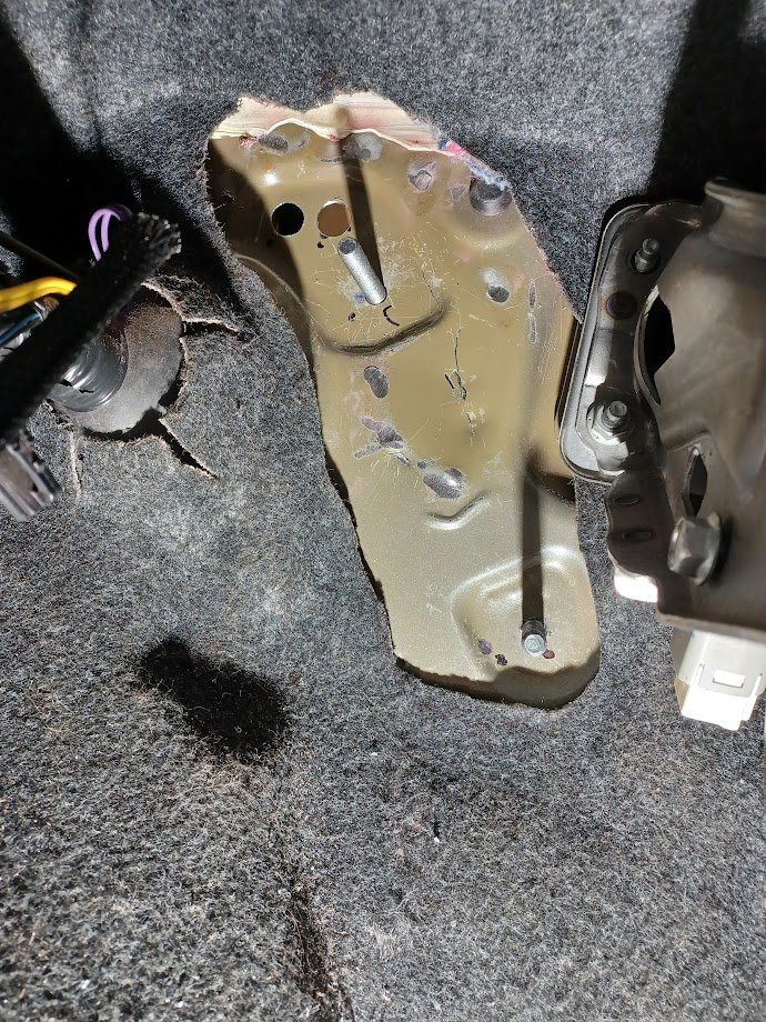

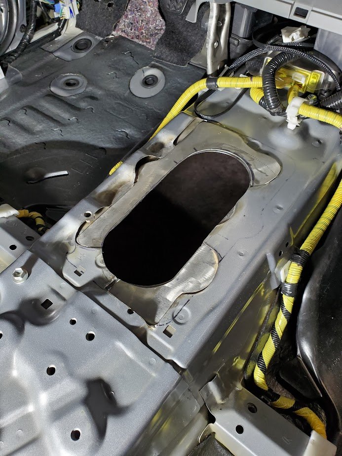

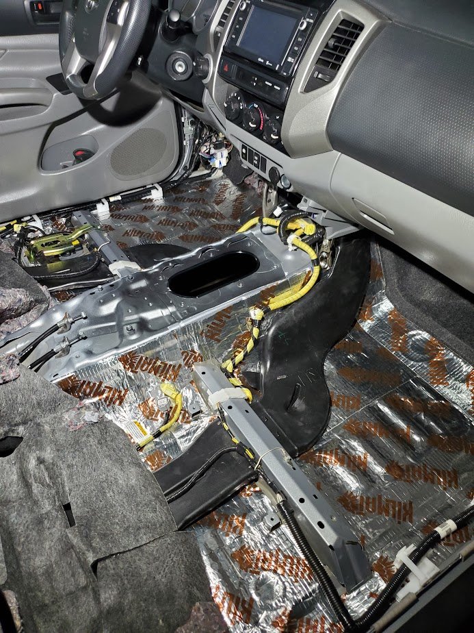

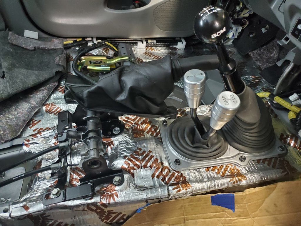

    Well, her truck is different than every single 2nd gen Tacoma with an online documented manual tranny swap.
    The issue is the floor mounted e-brake pedal. It sits right where the clutch pedal/master cylinder assembly needs to go and needs to be removed. That's why 2nd gen manual trucks have the hand-operated e-brake to the right of the steering wheel.
    1st gen Tacoma cabs have the holes and pass through plate on the tunnel. 2nd gens and 3rds absolutely don't and require punching holes of various sizes. I'd love to see pics of this purported anomaly.
    Here's mine after removing the e-brake boss:
    After drilling the holes for the hydraulic lines and fabbing a stud bracket for the pedal assembly, before paint. You can see the recesses for the clutch pedal assembly are there but every 2nd gen cab I've seen requires removal of the floor mounted e-brake assembly, lining it all up without a whole lot of help from the factory cab to give a clear place to drill and mount and then drilling holes for the hydraulic lines just like this:
    Unless you want your clutch pedal wonky or crooked, you have to nail this one. Mine turned out to my liking but it definitely took a hundred times measuring.
    And the process for cutting the tranny tunnel on the sandwiched dual layers of the auto tranny cab. Previous gen Tacomas had plates you could remove. 2nd (and 3rd) gens definitely do not:
