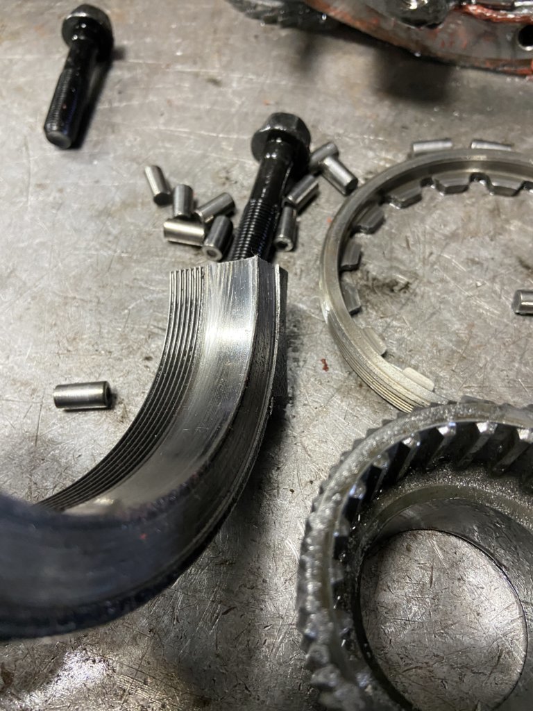

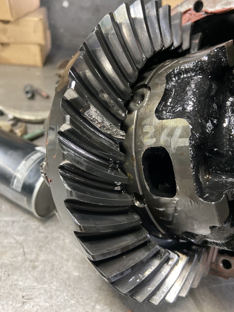

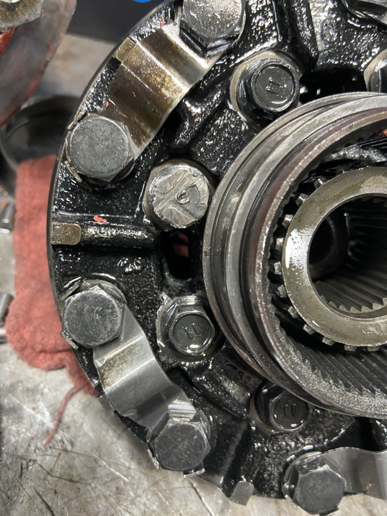

    Well just under 2 years and 5k miles....Whats odd is the carrier bolts backing out and rubing on the bearing cap, never seen that before. Looking at 9" options that have the sensor hookup, I use A-trac and such in my 4x4. Otherwise Id just use a Locker. And could still drive it, went to the des, played in the des and drove home, just made whining under deaccel.,
    906taco likes this.

    This is why the e lock rear sucks. The non e lock has girdled caps and is wayyyy stronger because of it. The bolts loosening is from carrier deflection.
    Personally, I would disable ABS and do your speedo pickup in the t-case where the provision is. That way you can go full float if you want.
