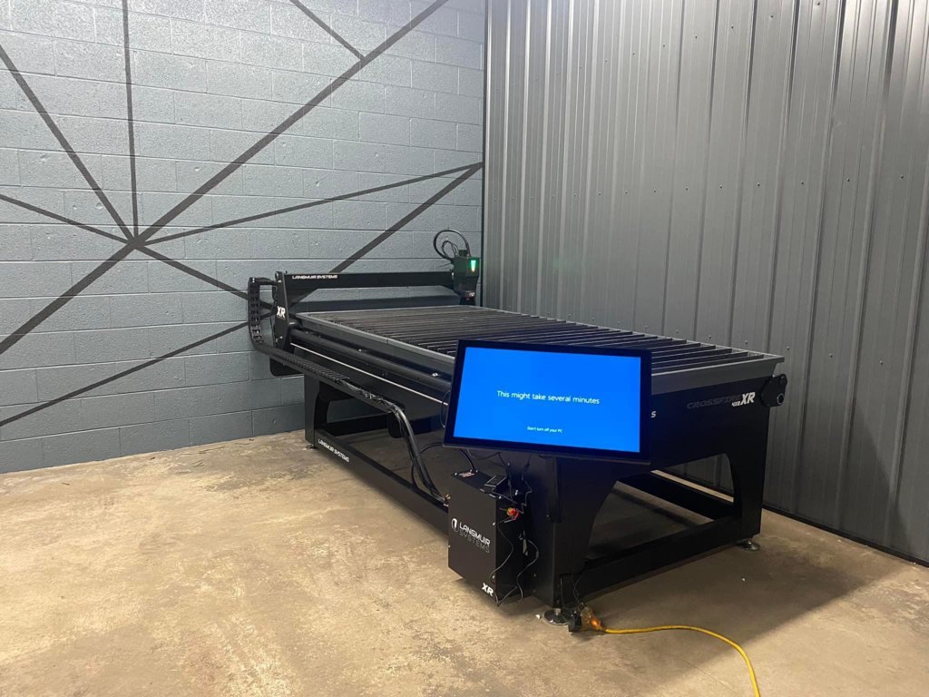

    I have a table for that now...
    9/10 would recommend

    You mean one of these? I agree. However I still do a lot of hand made stuff.
    IvanhoeTaco and Bandido[QUOTED] like this.

    Yup.
    Since getting it, i will not unless it requires a hell of a carboard aid.
    And even then sometimes make an .035 piece a few rimes before a .120 or .188 piece, because lazy.

    I still find heavy enjoyment out of building things by hand. But for things like building the swingset or SUA. Yeah it can’t be replaced. I’m not sure I’ll ever get into the full swing with tech. Unless it’s something I plan to produce.

    Ive done a few sets of control arms now, and even not as a a production part, it shortens the fab process a ton if tou have a decent design.

    Oh absolutely shortens the timeline on things that are drawn out and ready! Believe it or not I mess with more muscle car stuff than anything. Most all of it is one off. So unless I can cardboard it, draw it up and cut it faster than I can by hand it’s all hand work.
