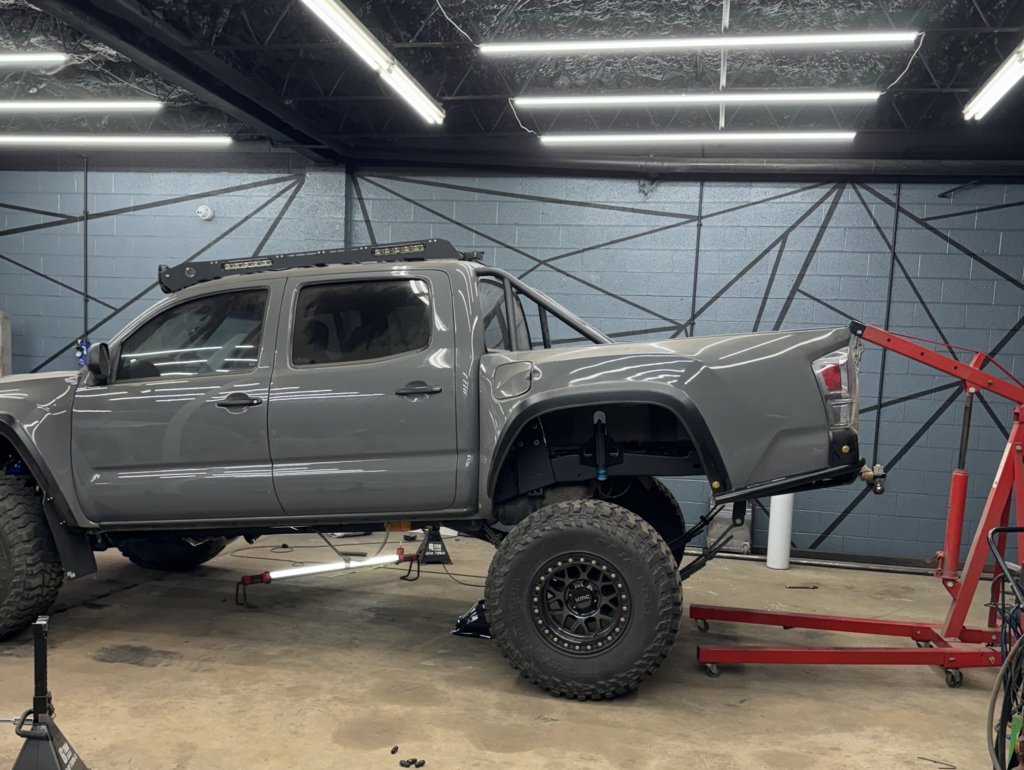

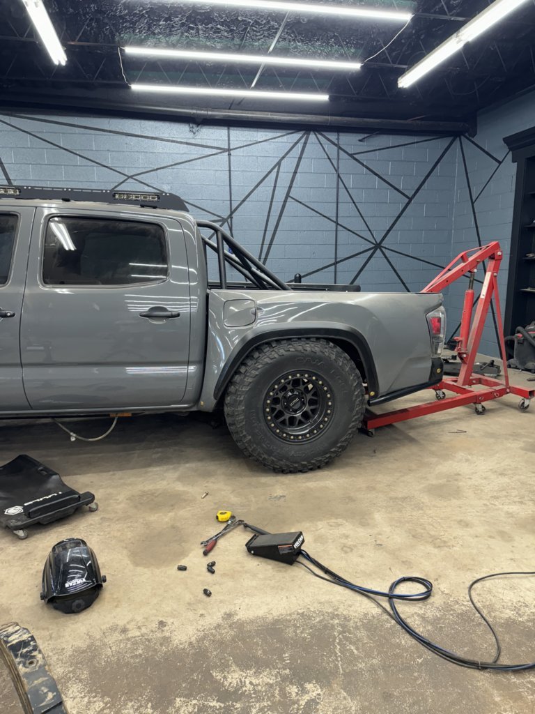

    I'm cycling a hair under 17"

    Noice. I'm currently at 12 and most of that is down.
    Are you light duty pack?

    You’ll get 18 or so with a frame notch but will be negative arch which wears out the leafs faster.
    triangulation and bracing is never a bad thing on these trucks.

    Same driveshaft on mine. Driveshaft will not limit you at 17-18 inches, unless you get some wild spring wrap that pulls the slip yoke out. But I doubt you'll do that. U-joints cycle those numbers just fine.

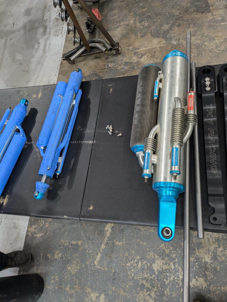

    These 4.5s make my 2.5s look small

    16.5-17” max. I cycled my old kit a ton and fixed a botched install on a buddies.

    That’s not fully true. Driveshaft starts to become a concern at anything over 17” depending on geometry. I’m bumped/strapped at 18 and moved my axle back a bit over an inch. I have maybe 3/4” of slip left.
    Assuming the original front hanger position was proper (it was a bolt on kit originally) it NEVER would have cycled over 17. But again. A LOT comes down to geometry. The driveshaft is at its shortest at full droop.

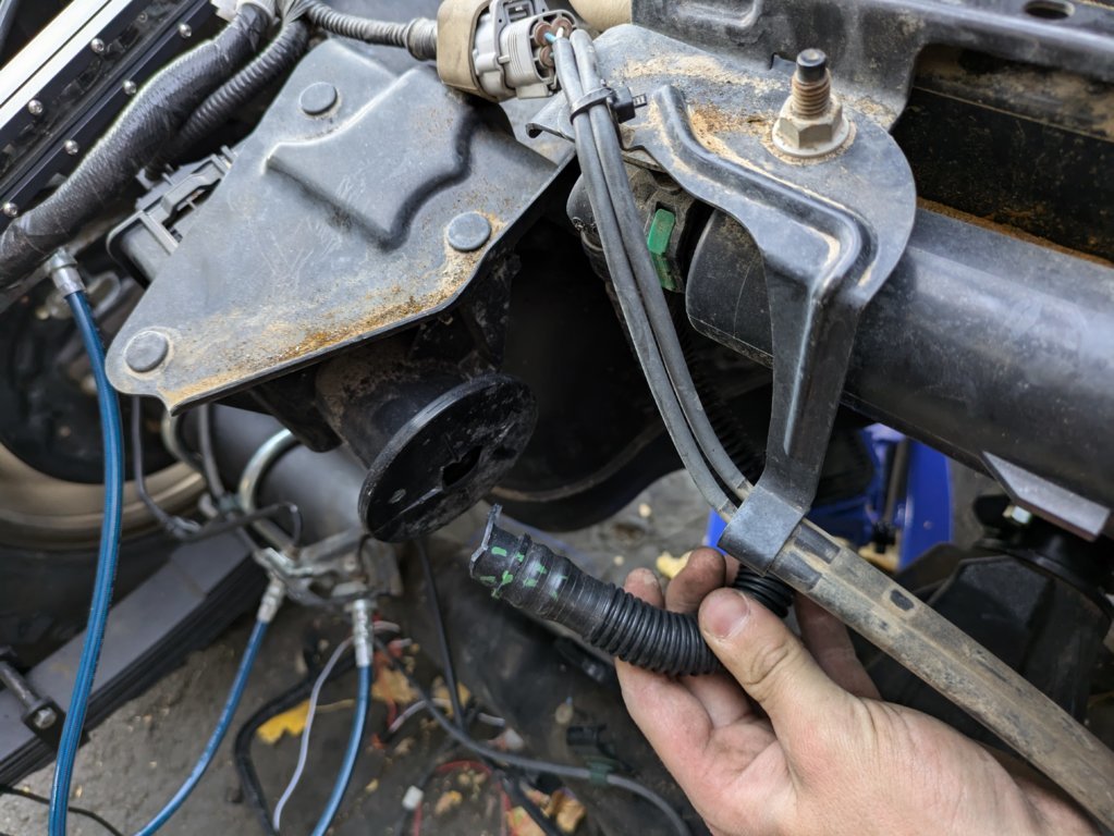

    Mine was cracked at same spot not fully broken off. I used a bondo to seal it back up. No codes anymore..knock on wood
