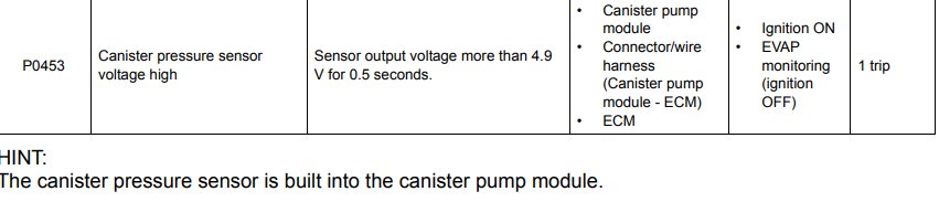

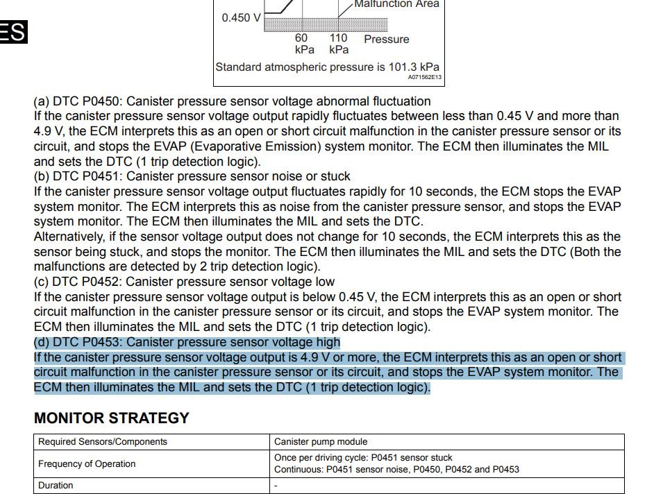

    p0500 is one of your Speed Sensors. Make sure they are properly connected or that there isn't any wire damage
    the P0453 is your EVAP Canister Pressure Switch Circuit, check that connector as well

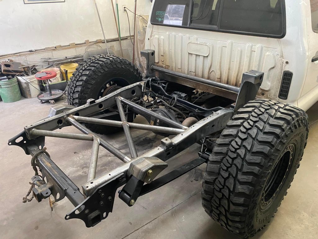

    Has anyone cut out the flimsy x crossmember in the back and replaced with tube? Thinking since the bed is about to come off and frame gets boxed I would attempt it. 1.75 .120.
    Would be more of an esthetic but as long as it's at least as strong as factory would be ok.
    Is there any harm in making the frame as rigid as possible? I know the flex will just move to softer areas but I don't want to create issues by trying to make it too solid.

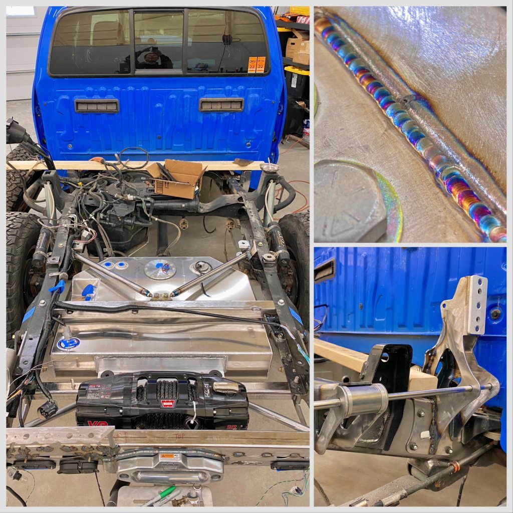

    i did, but i also hang my fuel tank from it too.
    I used rod ends to allow the K member to minimize bind into the frame under twist, but a year later ended up boxing the rails and adding a doubler plate to the outside so it may not have mattered in the long run.
    local stiff areas on a flexible frame could for sure cause high stress concentrations elsewhere which can cause issues. (cracks)
    but if you have a reasonably designed cage your chassis will most likely be stiff enough it isnt a concern at all to stiffen crossmembers.

    You can do it. But you won’t notice a ton of change. I boxed the entire C-channel of my frame to the factory boxed front. Marginal gains at best.

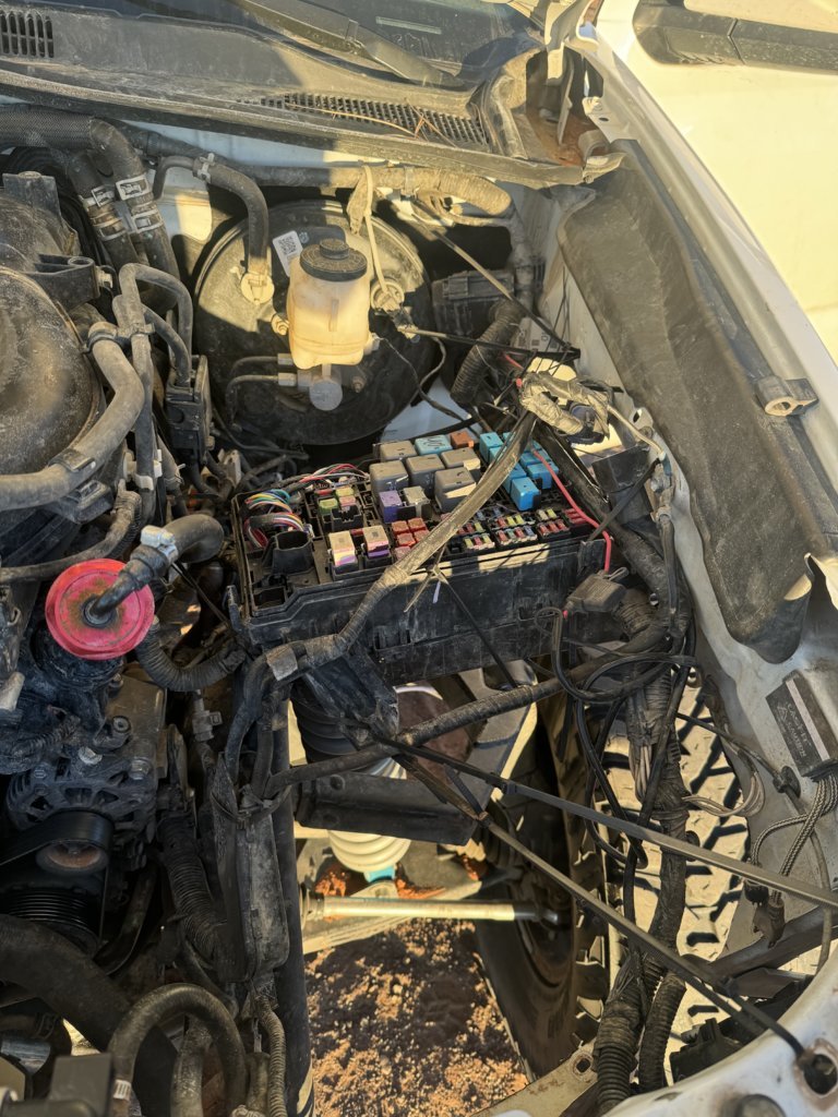

    My 2020 Tacomas been popping in and out of limp Mode. My fuse is not secured very well. I’m assuming wires are getting snagged and pulled. Codes I’ve been getting are P2135, P0123, P0122, P0505.

    Codes it sounds like a speed sensor wire is disconnected or pulled… likely the case in the front or rear as you’ve been cycling stuff.
    Evan code sounds like you know why? Canister disconnected still?

    Either all or nothing is my opinion on it. Boxing the frame made for a bad ass base to build a cage on. I will say that much.
    Engine cage with no roll cage, I wouldn’t want to be in a frontal collision. Roll cage without engine cage, same.
    Any time you brace one section, you weaken another as the energy has to go somewhere. The next non rigid section is that place.

    The thing about that is that the frame is flat, so you can only prevent it from twisting so much without adding another plane of structure. Which you have started with the bed cage, now you just gotta think about how it ties together to get the most out of it

    My rear was boxed and had a bed cage and still danced like a mofo. It only stoppped when I caged the truck. The rear is flimsy no matter what you do until you tie it into a cab cage
