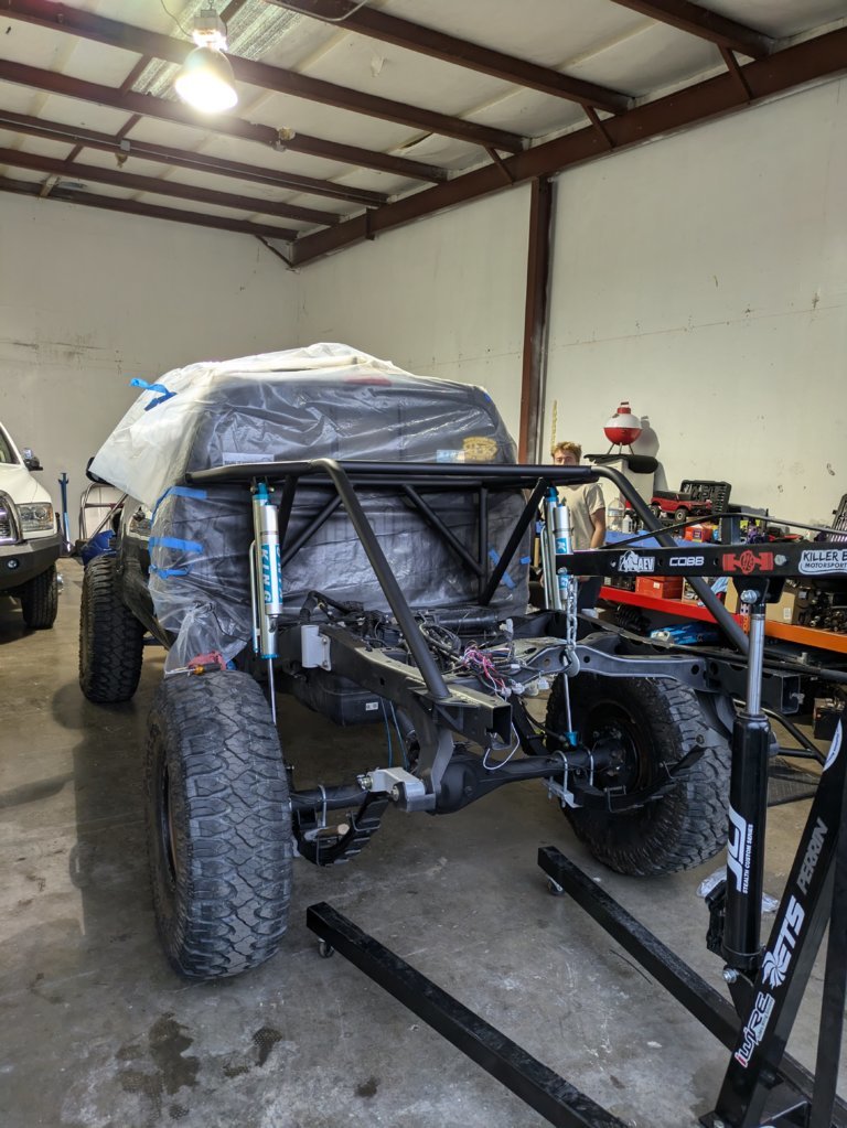

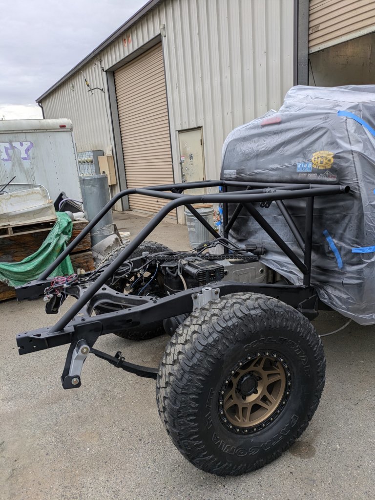

    I finally got bigger tires 2020 Long Travel Tacoma 1997 MAGNUM

    Going to add more down the road? Not the strongest of structures how it is now. No real junctions and the sides could have been X’d and the rear tube landings probably should have been boxed.
    Not trying to overly criticize as we all start somewhere. I’m sure it will be just fine for mounting shocks though!

    Oh yeah I totally get what you're saying. It definitely needs some reinforcement. Thank you

    Bypasses mounted
