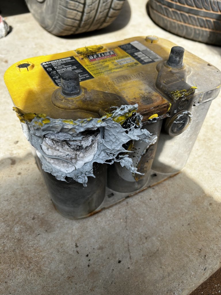

    Potentially, not 100% sure if that was the origin of the issue. I moved the battery roughly 5 years ago and never had an issue before this.

    My money is on thermal runaway. Either charging system issues or maybe even vibration.

    I’ve had my battery similarly mounted on the inside frame rail for about 3 years too. No issues so far, but I’ve always had this concern

    Well, did a quick inspection of the wires and didn't see anything of concern. Picked up another battery and threw it in. The truck started right up.
    Measured voltage at the battery and at the fuse box, only a .05 drop in voltage in that distance which I think is reasonable considering the length of wire.
    To be fair, the previous battery lasted 5+ years of abuse. Can't say I'd expect a battery to last much longer but I would like the reassurance that my truck won't burn down when the battery goes again.

    I'm honestly not that surprised I've seen a few optimas go critical now. They strike me as a brand that looks the way they do to sell because nothing else is special about them. But every one of them that's blown up hasn't been that old when I've seen them

    i would definitely add a plate on the front side for good measure....
