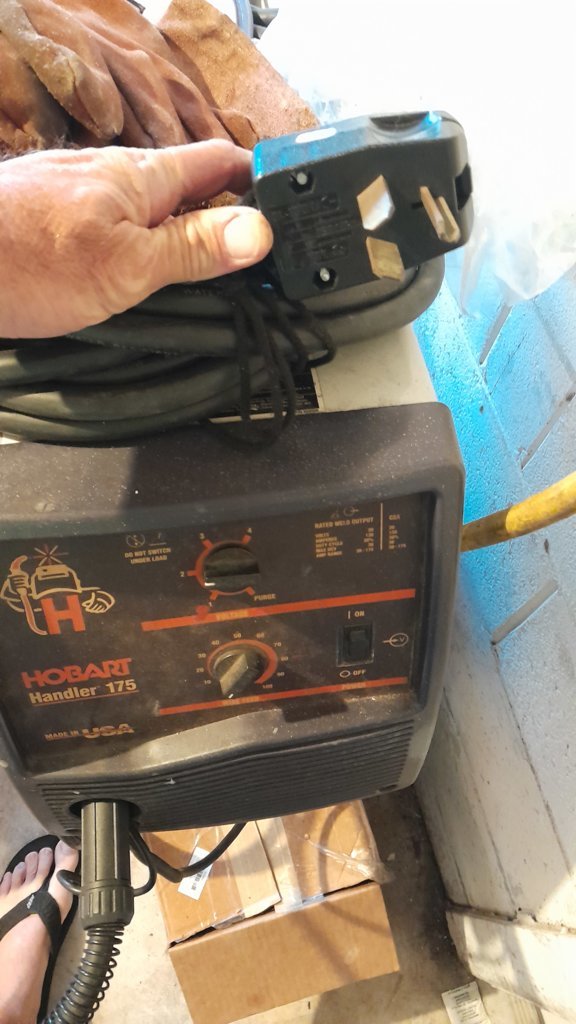

    I'm def going to try a lower wire speed first. I feel like I get rushed because the puddle gets so big too fast and I have to just get moving regardless of comfort or steadiness

    Puddle is getting too big too fast because it’s probably not burning in (big down fall to 110 is a typically shitty start). I’m personally not much of a MIG guy anymore, but some of my customers don’t want to pay for TIG or it just won’t work for the purpose. But I definitely burn 3:1 .023 to .030.

    Just emailed my electrician friend to get a outlet put in lol

    You have a dryer outlet anywhere near by? Get some heavy cable and a dryer plug.

    Putting in an outlet isnt rocket science either. Here in NH I can legally do it myself no problem in my own home.

    Run my compressor on the same dryer outlet.

    The guy i bought the bender from has the same model house as mine and he did it himself. Might only cost me a case of beer

    I used a portable generator before I finally rewired my garage.

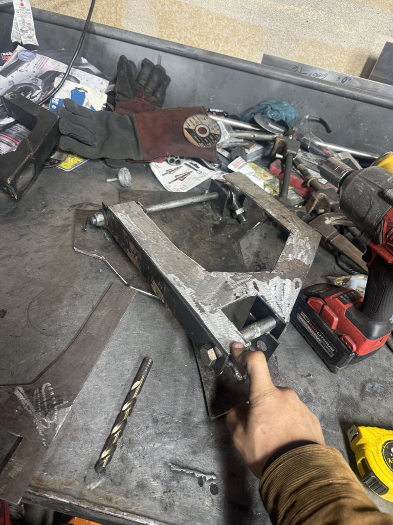

    Remaking my own uca,s because the ones I had made are too short, I am out of hiem adjustment and lca adjustment to get the tire camber right. I’m also losing out on down travel because of the amount of camber Ive got. Any tips or tricks are helpful. First time ever building control arms!
