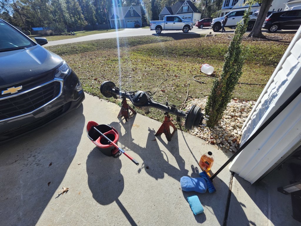

    The countdown starts now, how long will it take before the HOA notice.

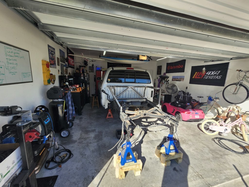

    I hate that game.
    the HOA didn’t notice my truck had no engine for 6 months, but noticed the jack stand when my ecgs tool broke and it was one corner off the ground for 2 days.

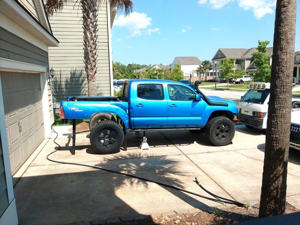

    Get creative! Got away with it for the entire 7 months I was working on the back half.

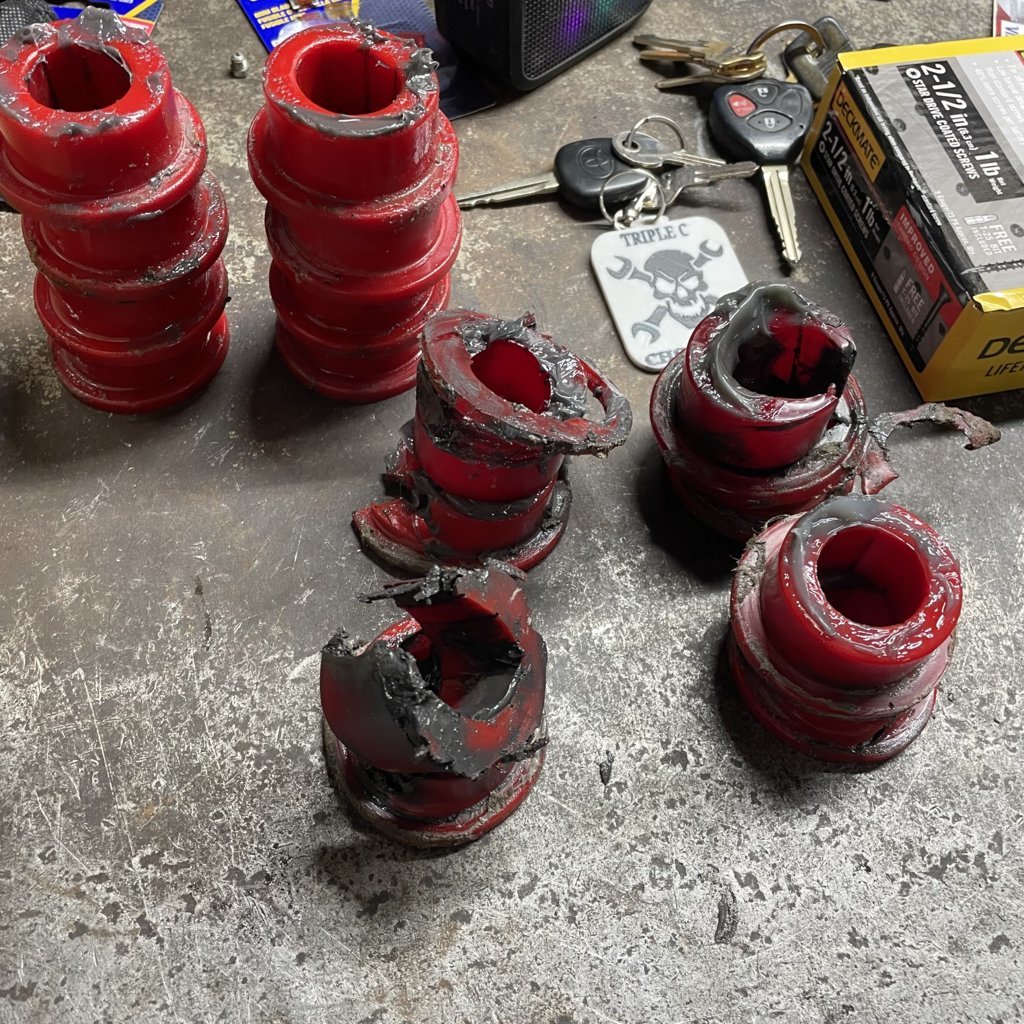

    UCA bushings weren’t horrible, but the did have some movement and the centers were wallowed out. LCA bushings, toast. Now we see how the delrin bushings hold up.

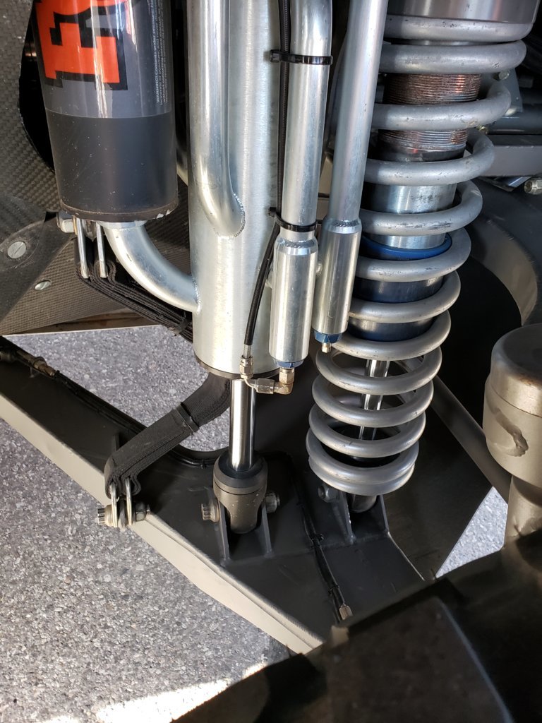

    Ok,
    So first time turning bypass tubes. Screwing the Allen in on the compression adjuster makes it less soft, and screwing the Allen out on the compression adjuster makes it more soft?
    I’m not even sure what to do with the rebound tubes.

    Sort of. You’re bypassing the valving on the piston while the piston is in each bypass zone. So you’re increasing and decreasing flow around the piston.

    Yup, I’ve been watching a couple videos, but wasn’t sure which direction you turn the Allen key to allow more or less flow around the piston. Still clueless on rebound. Adjusting rebound would probably solve any packing issues?

    Yeah you got the directions correct. And yeah, adjusting rebound will help with packing issues as well as can help with bucking. A lot less intuitive to adjust than compression. I always try to have some sort of video playback to review before adjusting rebound so you have a better understanding of exactly what’s happening.
